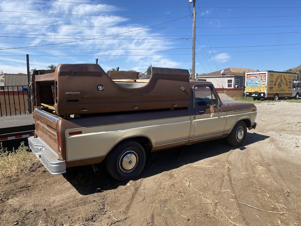

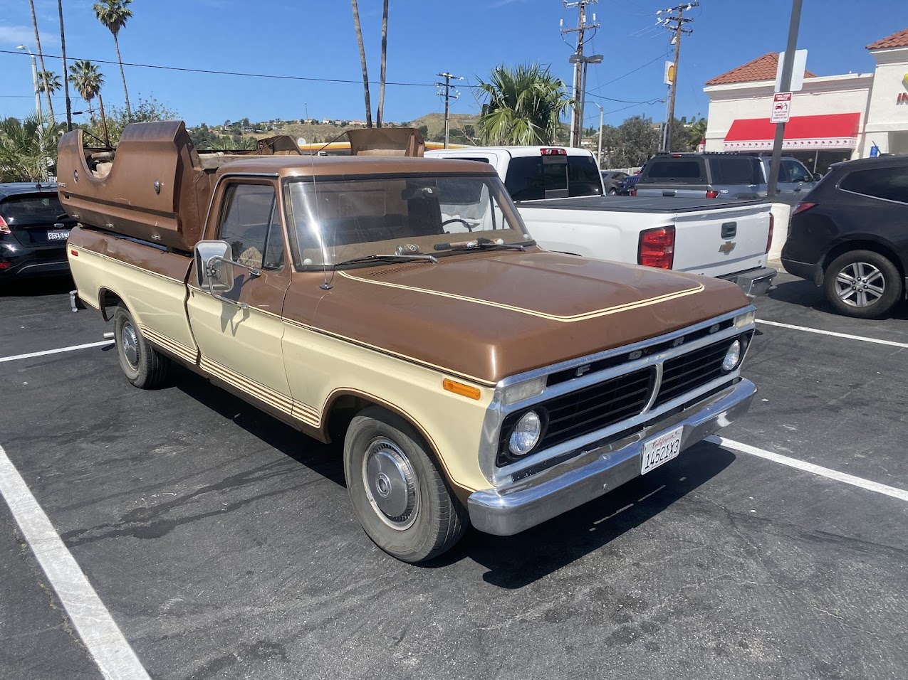

Was scrolling through facebook marketplace last night and a medium ginger metallic bed popped up for sale local to me so I jumped on that horse went and picked it up!
Its got a small amount of cancer on the topside of the wheelwells but thats alright.
Now I need to add the thin trim molding to the bedside and modify the bed so it will fit on the narrow frame as this is off of a wide frame truck
Going to weld up the wide frame holes and bedline the inner part of the bed and then ill paint the underside of it. Should turn out pretty darn good.

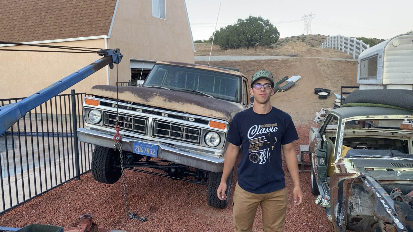

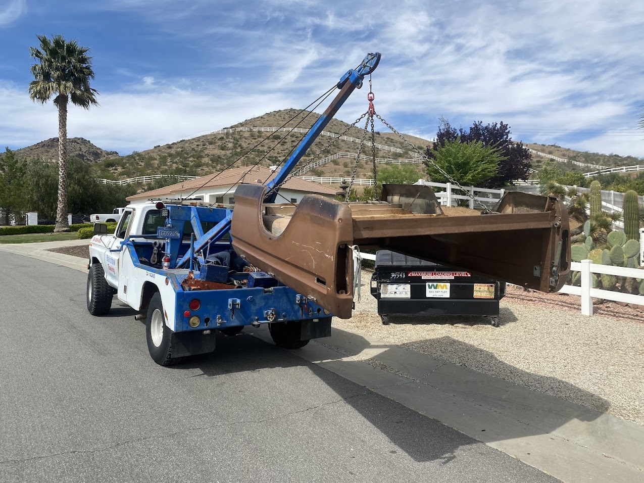

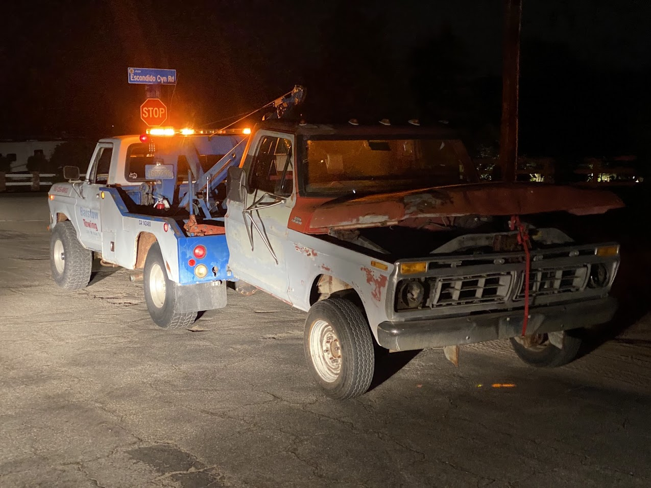

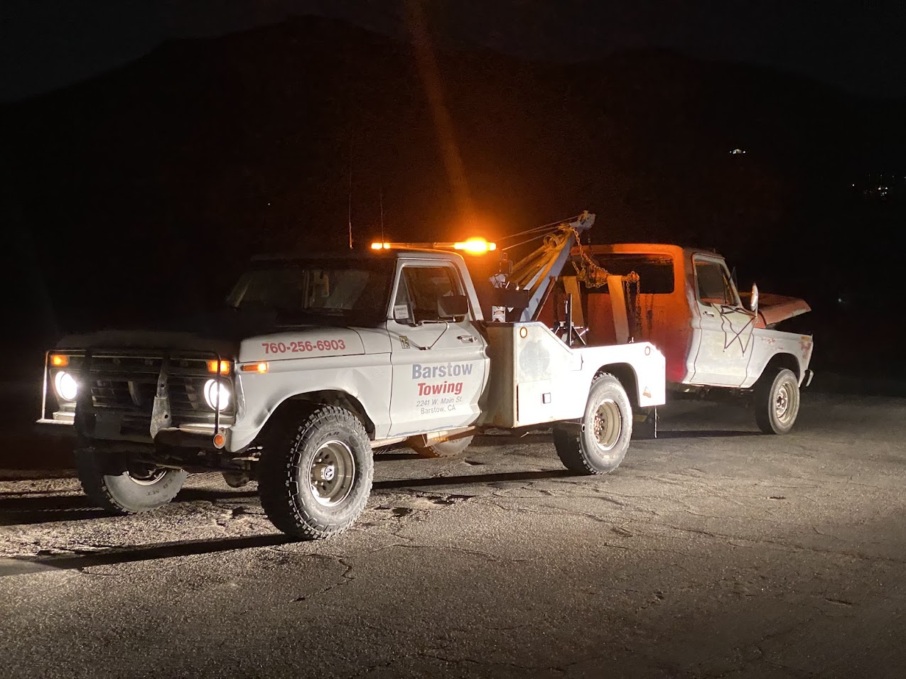

Ive only had the wrecker for a short while but ive used it to move a few vehicles around.
Actually just went and grabbed a floor pan donor for that highboy with it last night.
Love using it as a cherry picker!
Heres my buddies 56 F100 that he bought in California because he wanted a rust free truck and shipped it back to New Jersey where hes from.
This is a customers truck that I worked on awhile back that I used the truck to move it around until I got it running as well.

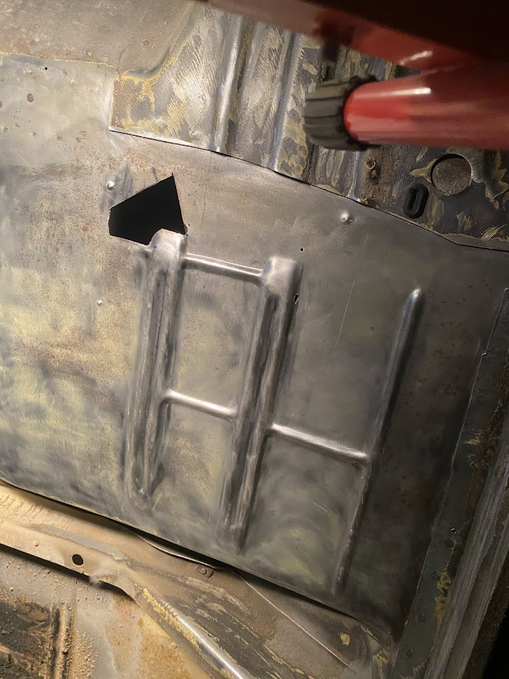

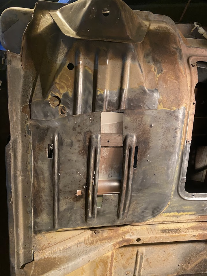

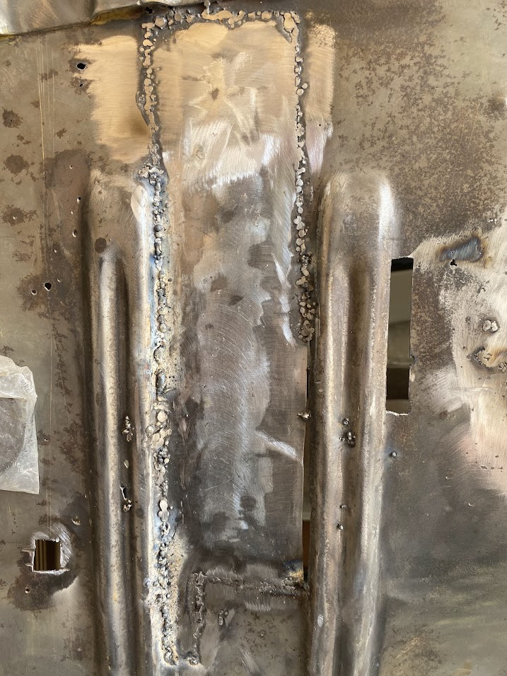

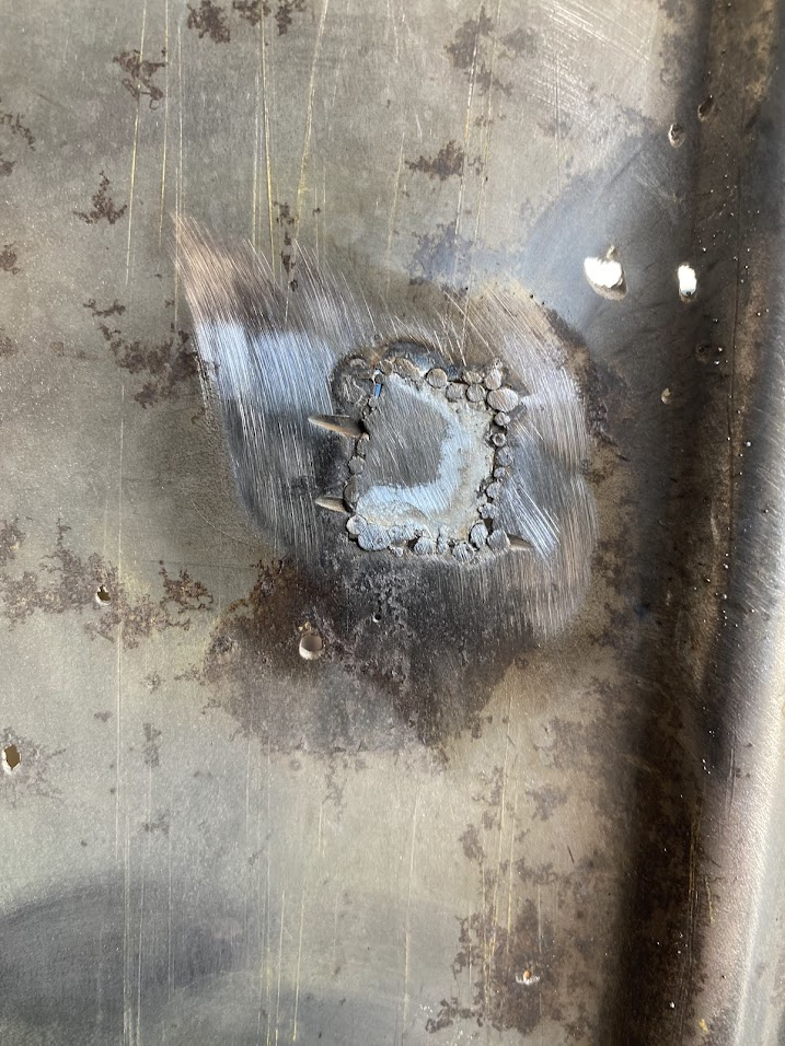

Started on replacing the floor of my highboy I was going to cut the floor out of that 77 F350 half truck but @RPSM convinced me to use some sheet metal so thats what I started on doing.
My welds are pretty bad ive got alot of work left todo on it just figured id throw these in as a little update to that truck.

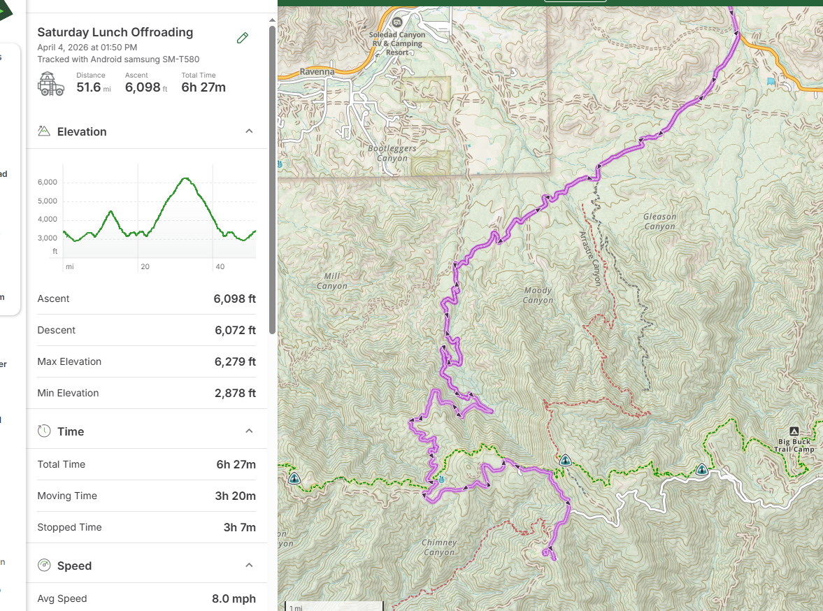

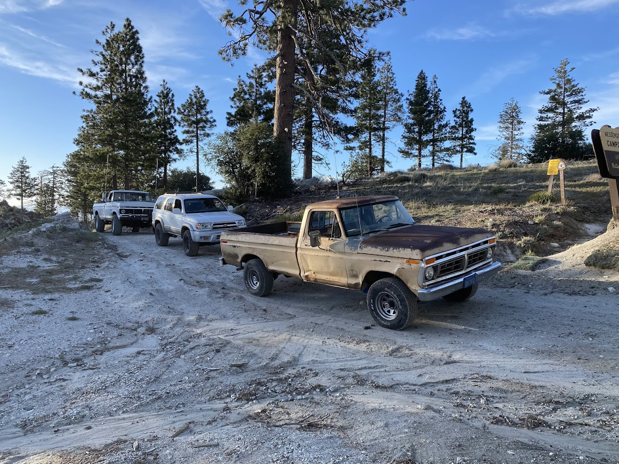

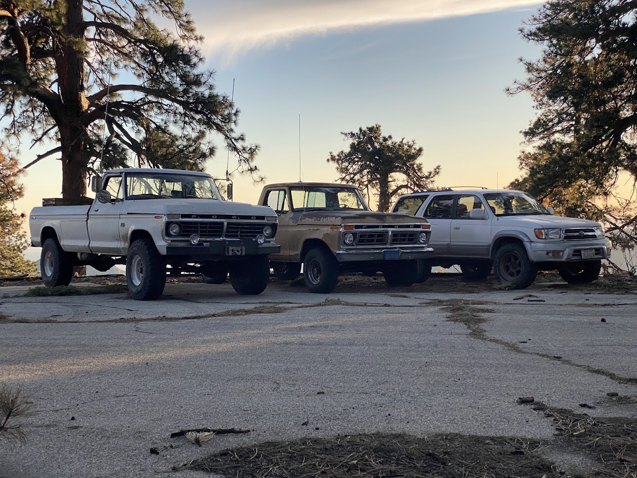

Few days ago couple buddies and I went for a trail run. Kind of a shake down for my buddy Coles truck the Tan one.
Its got some issues we found but well get them fixed.
Ended up doing alot more miles than I needed to on the trail run because he didnt check his coolant prior to doing the run and ended up being 3 gallons low. I dont carry more than a gallon extra with me typically.
Was nice going out and hanging out though. Need todo it more often.

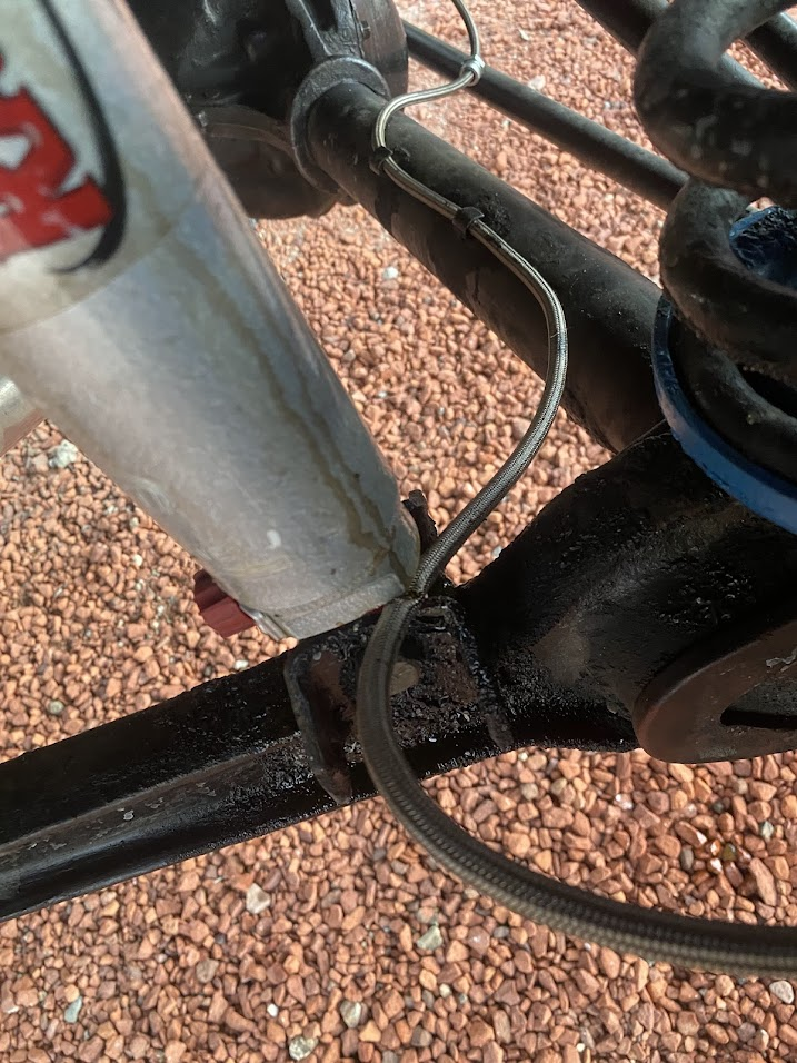

On the way back we were hopping onto the paved road and thought he was just rolling out since we were going to dinner nope! He lost brakes so that was exciting im sure..
Bronco Graveyard brake lines were way to long and ended up getting pinched in the shock mount. Time to go get some new ones made to the correct length.

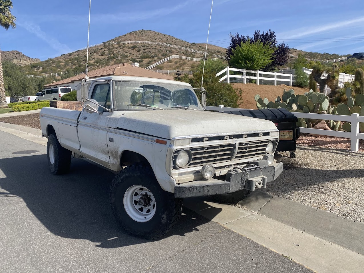

My truck got a little mucky from hitting a dirty puddle haha.
