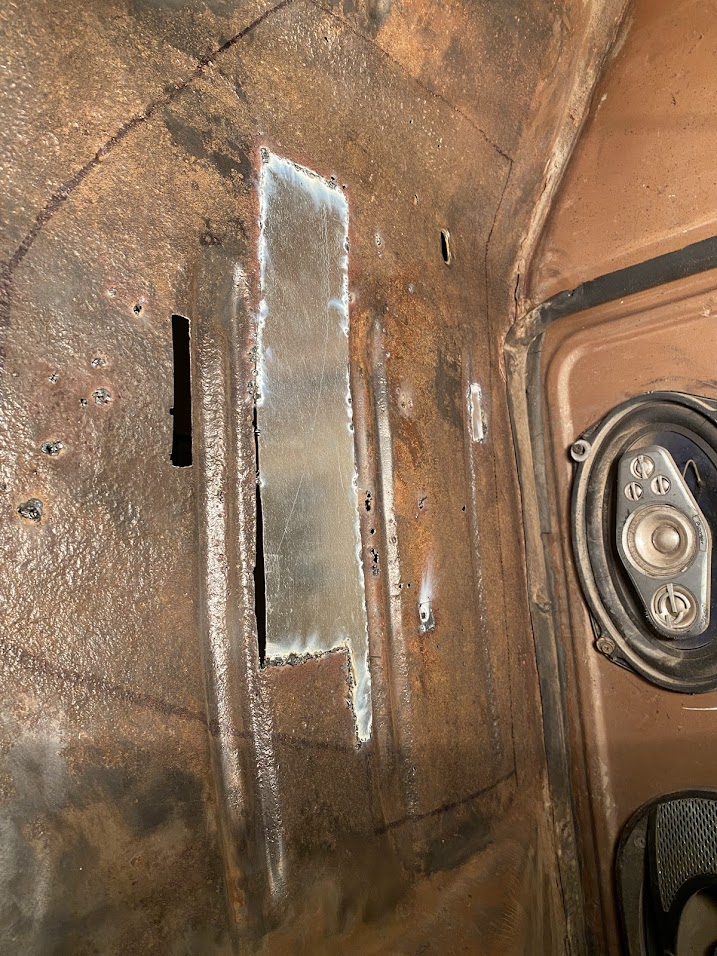

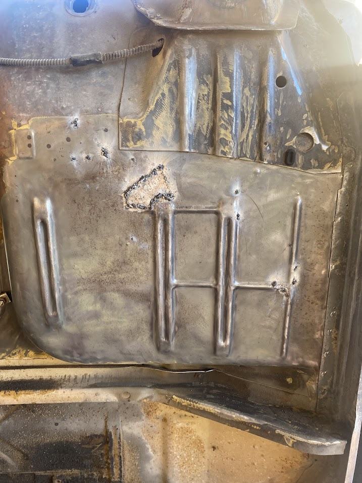

Heres some terrible welds I laid down. Time to weld the top side of the floor and grind away and find all the pin holes and do all the finishing.
Welding pans in for the first welding project ive ever done is interesting especially with everyone telling me that welding with fluxcore and no
gas is about the worst way to weld these in but its what ive got laying around so im using it.

Your welds are better than mine.

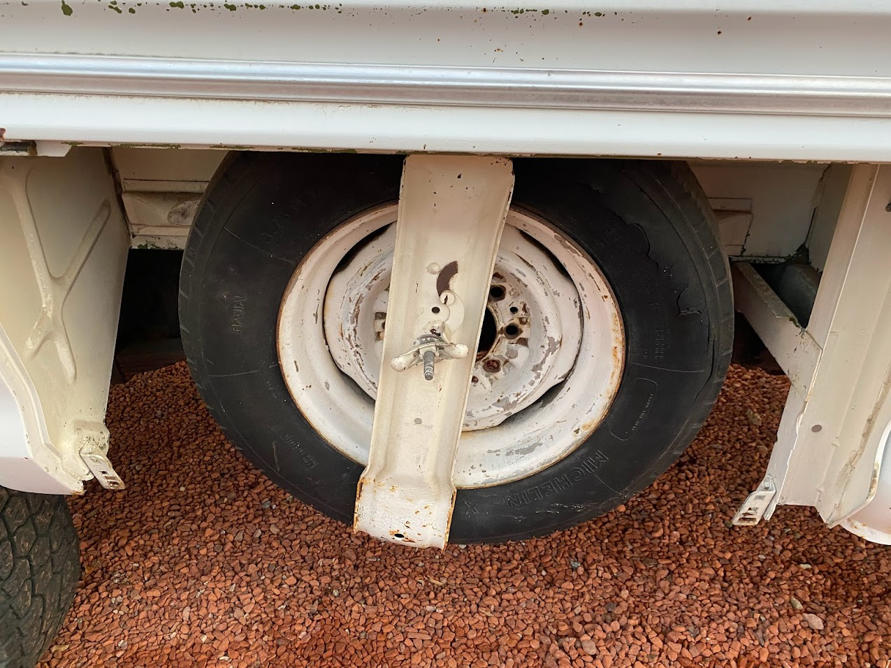

I wonder how hard it would be to put some tool storage into the spare tire compartment on the super camper...

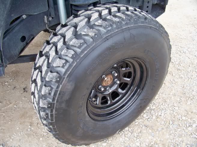

@77&79F250 I know you have some experience with the old Humvee tires do you have a preference between the Goodyear MT & MT/R or the BFG Baja T/A tires? I found a guy local to me who has a ton of them and kinda want to buy a couple dozen of them but not totally sure which is the best for offroading and that sorta thing. Ive had a MT/R side wall split on me from dry rot and a MT explode however both were from circa 07/09 so near 20 year old tires. Ive got a Baja T/A on my other truck and they seem good but figure youve got a bit of experience running them.

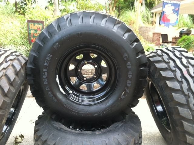

Sorry just caught this question. I like the newest version of the Baja T/A. Pic #3 for the best one IMO.
The 1st gen 36x12.50x16.5 Goodyear Wrangler R/T is a bias ply and have terrible wet road manners and not that good at off roading.
2nd gen 37x12.50x16.5 Goodyear Wrangler M/T is a HEAVY tire, 80 lbs by itself and not all that for any real off roading. Hard sidewall.
3rd gen 37x12.50x16.5 best one yet, newer tire, newer design better for off roading.
Interesting never seen the R/T tire before.
Yeah the M/T tire is whats been on my wrecker since the mid 90s at least obviously they mustve liked it between the 2 tow companies who owned my truck between then and now.
The MT/R Goodyear is definitely the most agressive looking tire ive just been weary of them because I had one that split on the sidewall tread.
It was dry rot issues and it was from 2008 or 9 but still worrys me a little bit.
Ill have to see what he has and how many of each model but I want to get some of the newest tires he has in the E rated catagory.

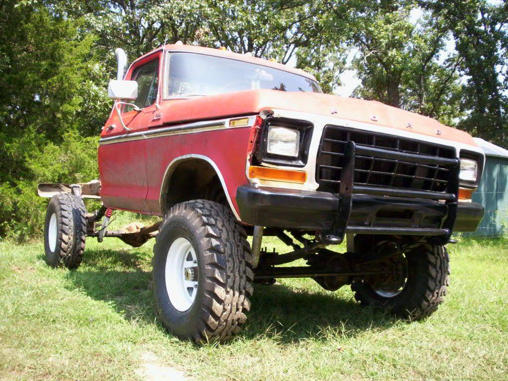

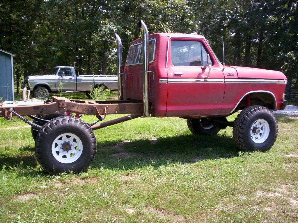

RT is ols school 36" BIAS ply, so run out of round until heated up. All I could get at the time, but were cheap.
Maybe a tire source for you? https://govtire.com/collections/trucktires
Or https://militarytires.ca/product-category/offroad-4x4/

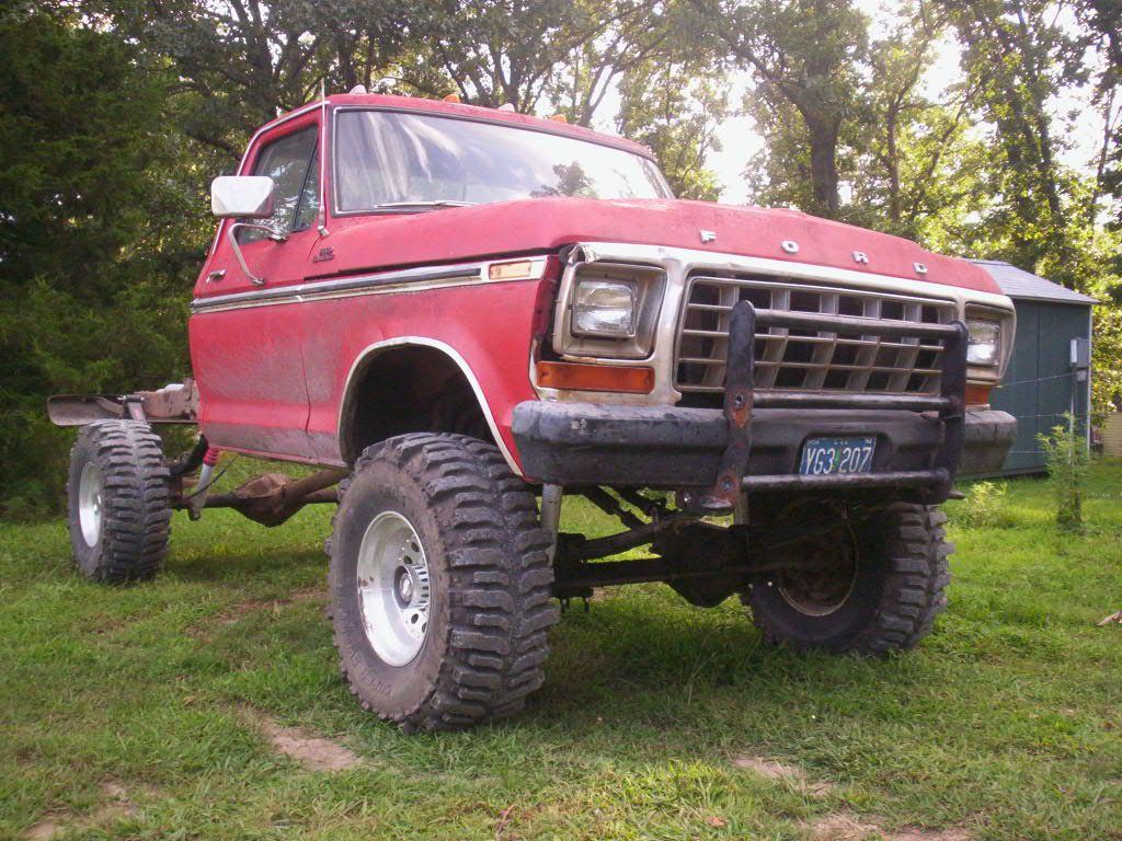

Got a deal on some 35" boggers and different rims.
35" TSL's on the front for a bit.
38.5 TSL's on all 4 corners.
Lowered the flat bed and put 37" Baja TA's now days. I like my front fenders un bent.

You asking me? No they are 35x14.50x16.5's.
I do not even hear the tires because of the fenderwell exit headers to straight pipes. And then it went to fenderwell headers to stacks.
CrAzY loud in the cab.

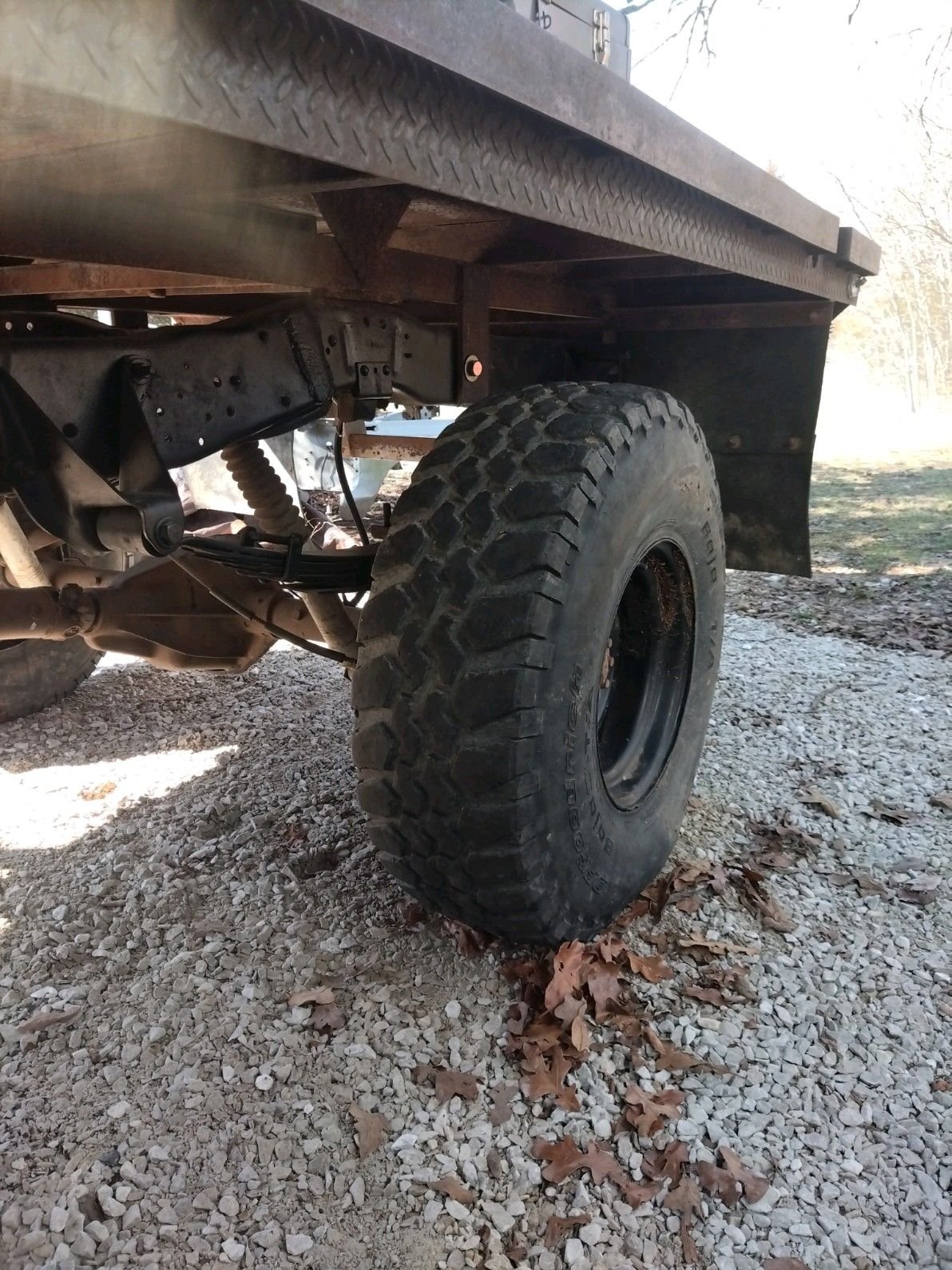

Remeber them 2nd gens (2nd pic) are HEAVY by themselves. Like 80 lbs a piece.
1 gen 36x12.50x16.5 BIAS ply and IMO NOT the best wet road manners.
2nd gen 37x12.50x16.5. HEAVY TIRE.
3nd gen info there are 2 different load range versions. Get some load range "E's" for the wrecker.
