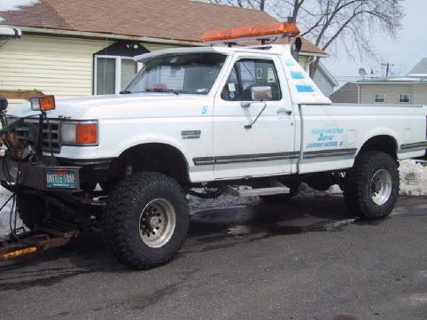

"Rattletrap" is still all factory stock except for the added turbo.
i do have an international 195HP engine in it though, but it came that way. truck was special ordered in Virginia with 9 others by a construction company. 3 weeks before delivery they tried to cancel the order as one of the partners played "grab the money and run" leaving the other two partners in DEEP financial trouble. my local dealer bought all 10 trucks, and mine was the only one that made it to New Jersey, the others were sold on the way up here. mine pulled in the dealer lot as i was there with a blown engine in my 86. the dealer owner said i actually have a diesel coming in, it should be here any time. as i turned around it pulled in. took it for a drive and bought it on the spot. title says 2 miles, but it had 400 when i left the lot.
drove straight to a friend shop that was a Banks dealer/installer and had the turbo put on with exhaust delete. ran it home with just the down pipe, and put stacks on it with no muffler.
as for boost, i can easily hit 16PSI if i run it hard but i usually keep it around 10 psi.
now i have a 3 inch flowmaster 50 series muffler on it between the downpipe and stack splitter and it dropped boost to around 8 psi.
the 50 series is a single chamber muffler so it does not produce as much backpressure as normal muffler do so the engine still "breaths" good.
injector pump is a stock NA unit turned up 3 flats. pulling that mini excavator up the 1/2 mile long steep bridge i would drop from 5 gear 55MPH to third gear 35MPH on the one, all others would just be drop to fourth and around 45-50 MPH.
this is a picture of the truck waiting to go out plowing snow when it was still fairly good shape before the bed and cab rotted off it, i think it was 16 years old with around 350-375 k miles on it at the time. it now has a little over 496,000 miles on it and is waiting for weather to warm up so i can put the new cab on it
in the picture you can see the hood front lip, and the middle of the rocker panel starting to rot out.
the rocker is now completely gone along with about 8 inches of the floor, 3 inches of a pilar and 5-6 inches of b pilar and cab corner.
that poor girl saw a tough life plowing snow for 30 years besides running heavy equipment escort all over the NY, NJ, PA, and delaware area, and she also did WAY TOO MANY salt water rescue/recoveries for the township police. twice i was 1/4 mile out in the atlantic ocean towing back drunken idiots swamped rigs after deciding to go "wheeling" in the water with incoming high tide.
plus at least 15 super high tide flooding rescues where the roads flooded and people drove around the barricades closing the highway, or the old folks that said i have been here 50 years and never got flooded out, then called police when water started coming in the front door of their house.
i had the only rig that could drive through 4 foot of water and come back out without ingesting water in the engine. i am 6 foot tall, and the fender tops above the front wheels and bed rails at rear wheels are at chin level.

Dang dude not many original owners with these trucks anymore thats pretty cool.
Do you know what was different between the 195hp engine and the regular 7.3 with 180hp I think.
I wonder how much power its pushing at 16 psi.
Thats alot of miles before I owned my wrecker I had never seen something with that many miles thats awesome your able to get that many miles on it.
Are you still on the original idi at 500k miles?
My wrecker has been through a few engines and a bunch of other components im sure from what ive gathered its got 570k miles on it.
I love your truck that is a clean setup that you have. To bad about the rust but oh well thats what happens to work trucks especially in snowy/icy areas.
Thats crazy out in the ocean with the truck did you have lockers or spools in the axles to be going out and doing that?
That truck is pretty tall, my truck is also on 37s and im 6'2" and I can rest my arms on the hood and bedsides of the truck with no problem.
I do plan to lift my truck delete the factory style "highboy" 4" lift blocks and put 8" lift super duty springs in the rear and whatever the equivalent is in the front with the 99-04 super duty leafs.

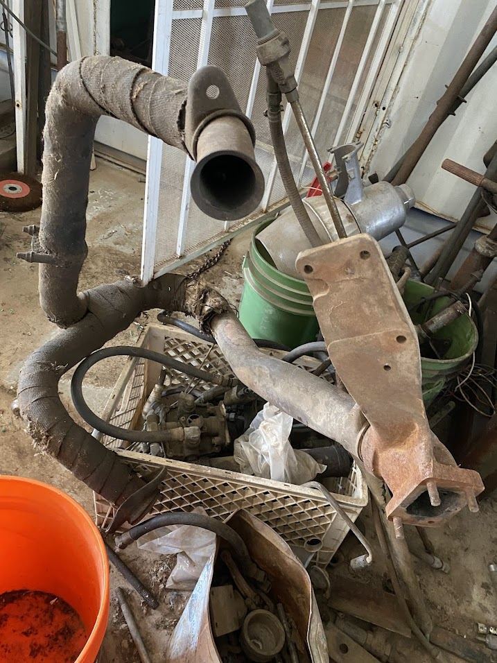

Any idea which style this exhaust is? Went up to my buddies house today to look at his IDI stuff and he actually had some parts of a turbo setup.
Not sure which turbo setup this is or if it was a custom made setup im not sure.

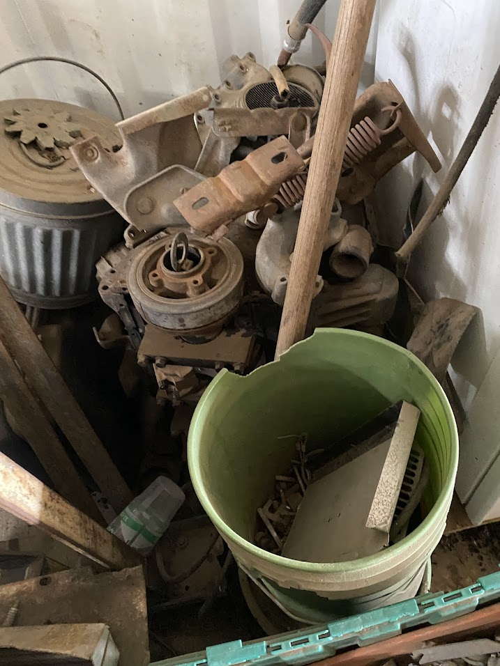

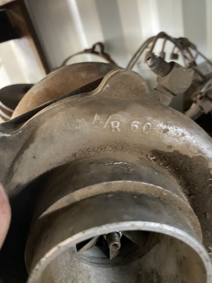

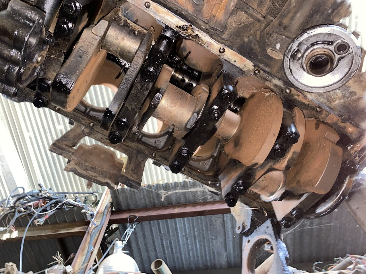

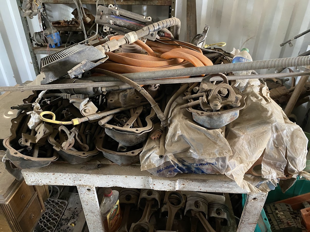

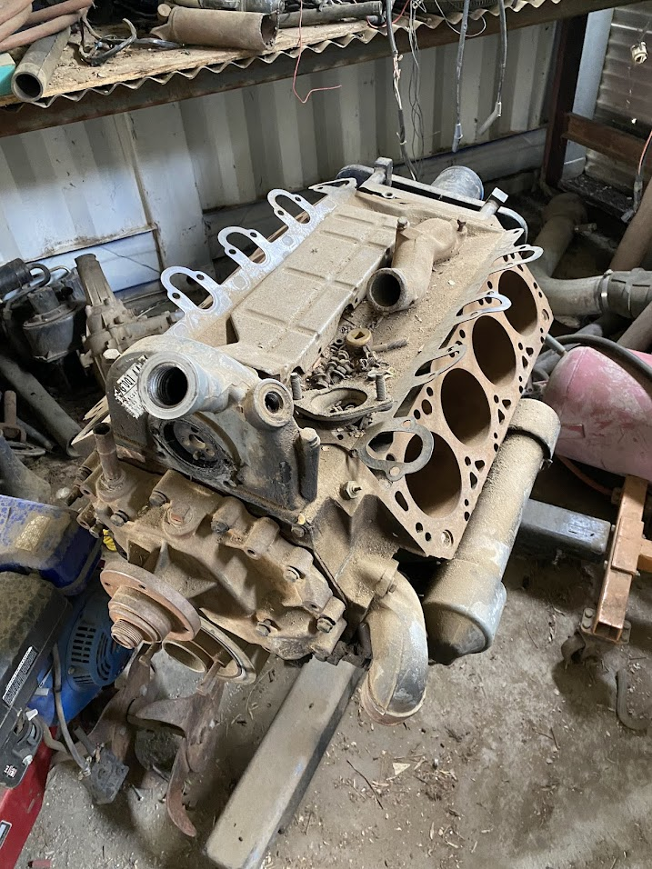

Heres some pictures of the engines im looking at getting. The one on the stand is supposedly in good shape just need a hone and some polishing to the crank. He seems to think he has all the parts to put both of these Idis back together
He has new rings bearings and gaskets/seals to reassemble the one engine on the stand. Looks like I may be buying a 85 super cab long bed off of him as well so ill get a complete "running" 6.9 idi out of that as well which ill throw into
one of my trucks. His 85 has alot of parts my 84 needs so its going to be a parts vehicle for me. In the bags on the table is rebuild heads for that 7.3 IDI on the stand as well.

that pipe setup looks alot like the banks pipes on my 88
is the turbo outlet where the down pipe mounts bolt on, or clamp on?
