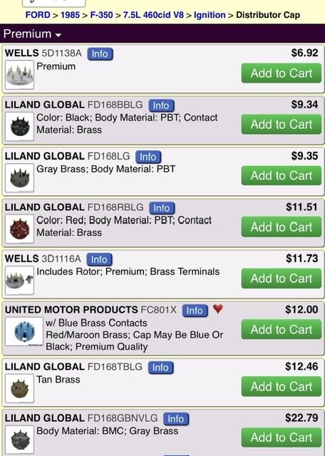

You might be able to get a cap with brass terminals from rockauto. They sell closeouts, and may have some at a reasonable price.

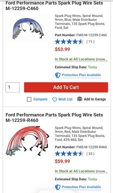

I use a distributor cap with brass terminals
Ford Motorsports wires
and usually Motorcraft copper plugs in everything but in the ‘89 F-150 I have the Autolite copper plugs recommended by AFR.

I do like to use a cap with the brass terminals. With even good brands being kinda cheap these days, you just need to spin the wheel and hope. As for wires. I really prefer Taylor wires on most things. Really well made, and while not cheap, wont break the bank either. That being said, Ive also had great luck with the cheaper sets ive gotten from Amazon. Maybe ive been lucky with those? Who knows. Plugs? Copper core Motorcraft or Autolite. Save the fancy stuff for the late model stuff.

My new cap and rotor showed up from Standard and they have nice brass inserts.
