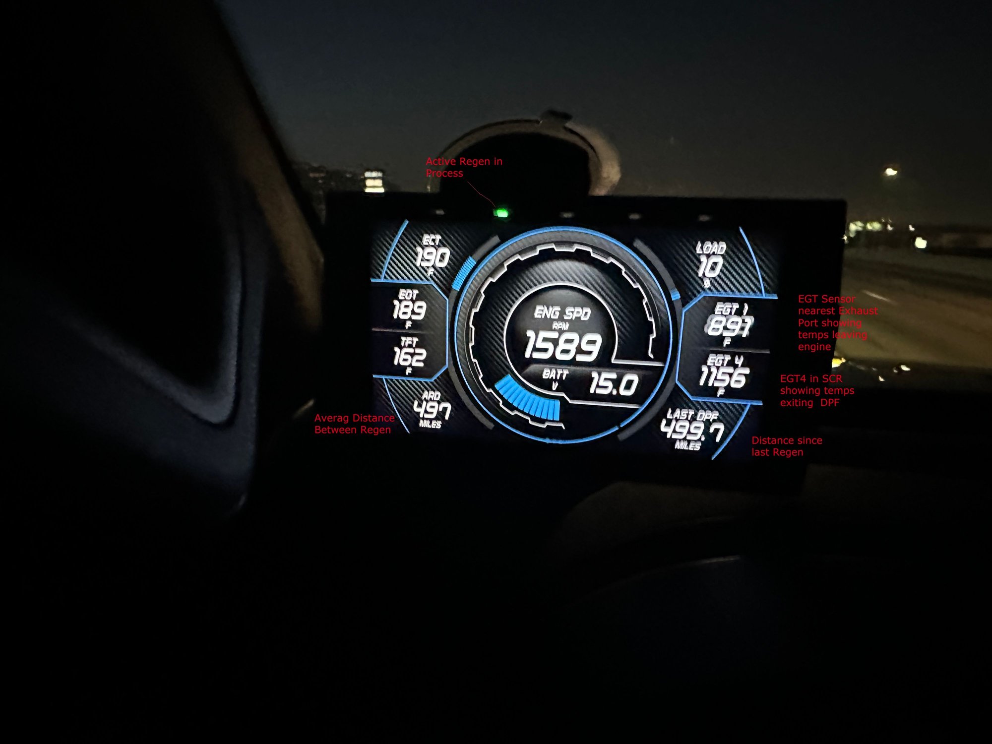

I'm pretty sure the maditory regen at 497 miles is for 23+ trucks. If you have an older model, I don't believe you have a mileage based regen schedule, But have DPF fitler % based schedule.
If you have an aftermarket gauge, You can monitor when exactly the Active Regen turns on and off ( I assume that indicates when the 9th injector is operational) and you can monitor your ARD ( Average Regen Distance) and your LAST DPF as shown in the photo below.
Green LED at top indicate that an active regen has started, Bottom Left is the Average distance between regens and Bottom Right is the Distance since last Regen.
Again, These only apply to 2023 and newer trucks, These numbers were totally different on my 2020 and my 2017 trucks.

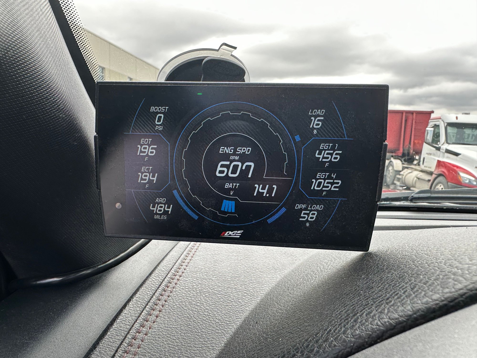

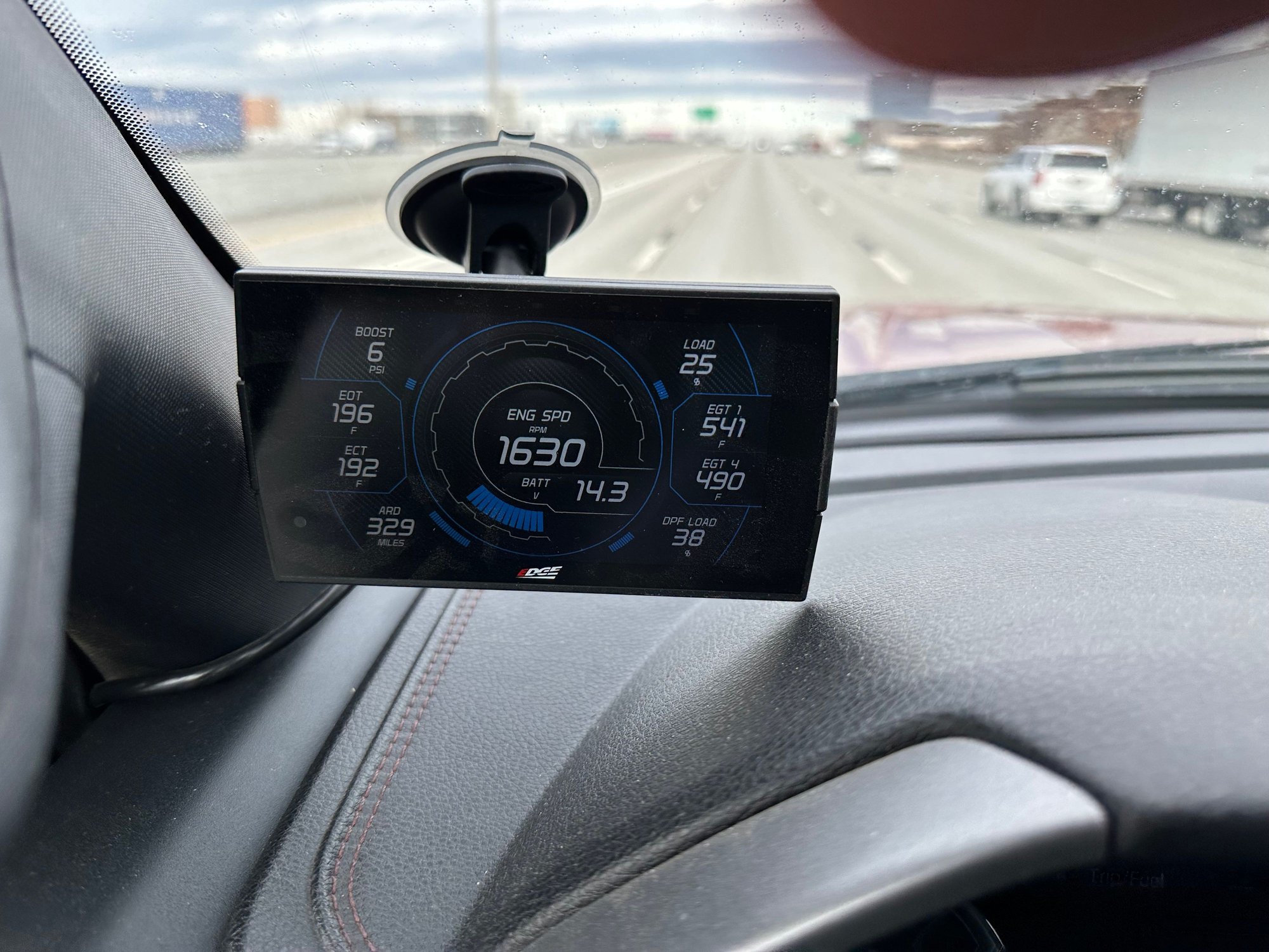

This is from my 2020 truck. You can see that I was averaging 329 miles between regens on that truck when this photo was taken.
And I was averaging 484 miles when this photo was taken
The average between active regens varied a lot on my 2020 truck. Depending on how I drove
But it has not varied at all on my 2023 truck in 75,000 miles. It ALWAYS regens at 497 miles

My bank's I dash always shows 496, which as I posted above is incorrect. I typically get closer to 700 when towing

Where's the PID located for that Last DPF monitor?
