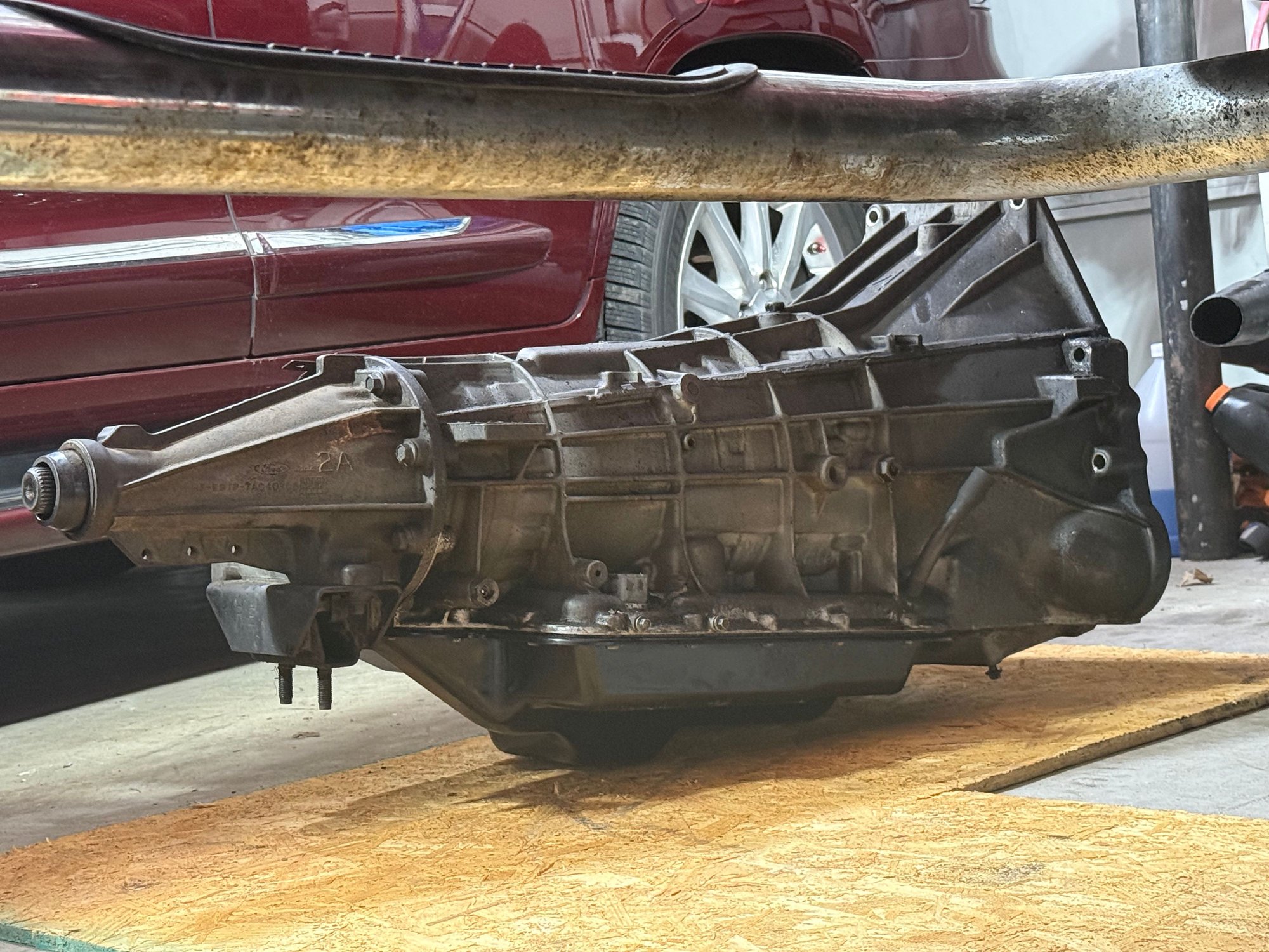

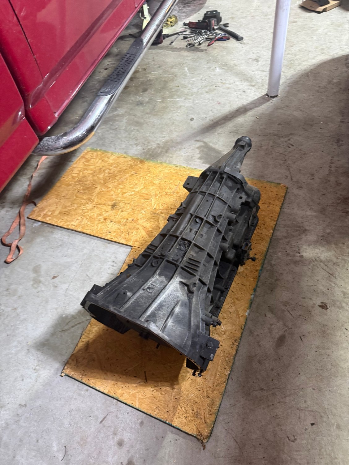

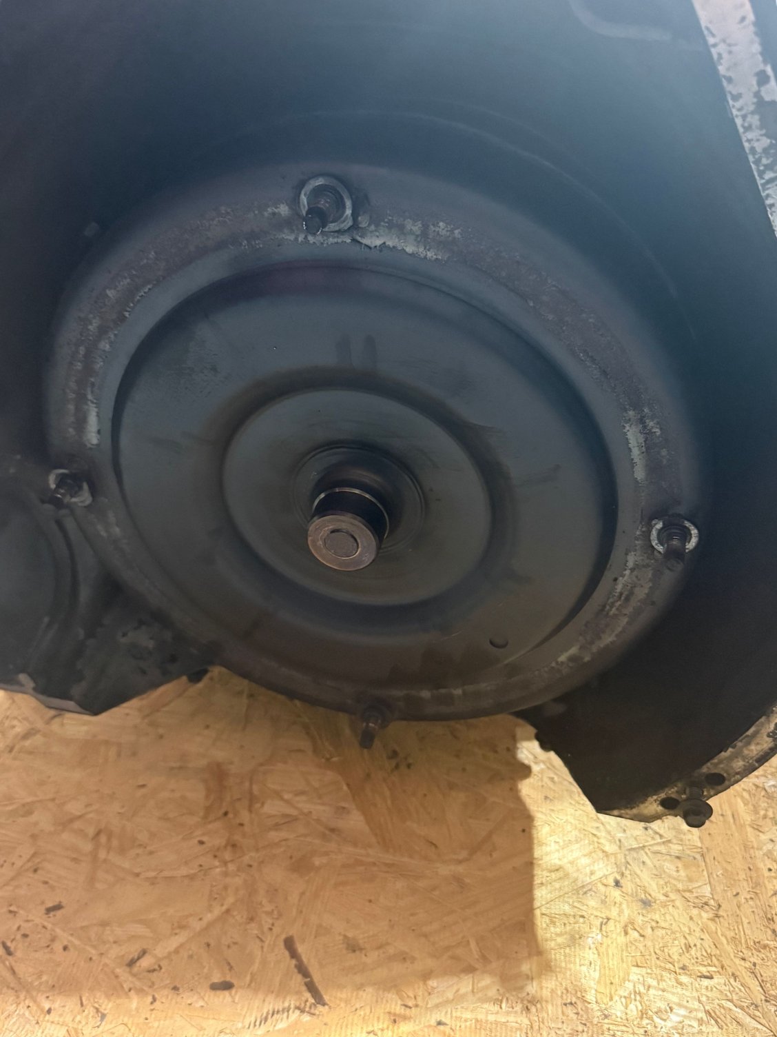

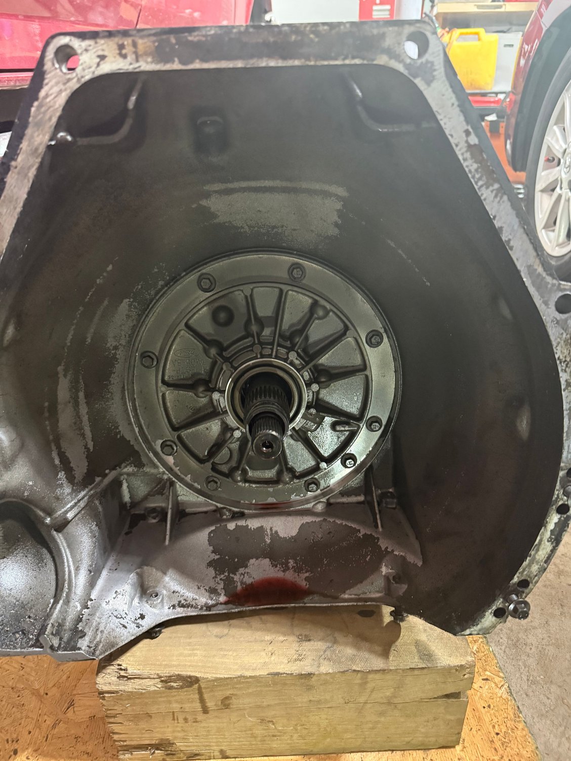

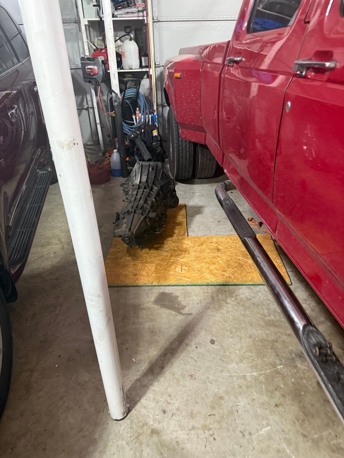

Dropped the transmission today primarily to replace the torque converter. Did it on the ground with a floor jack and ratchet straps. Not too bad. Took me about 2 hours to drop it. New converter arrives Monday.

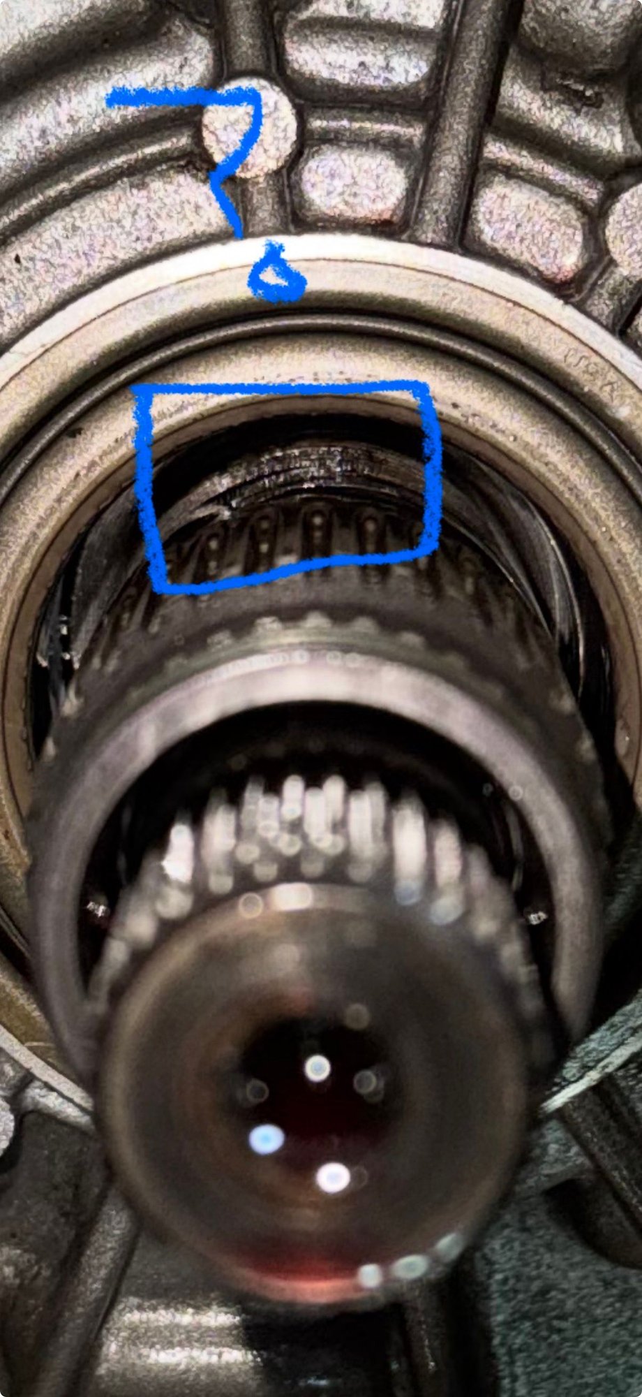

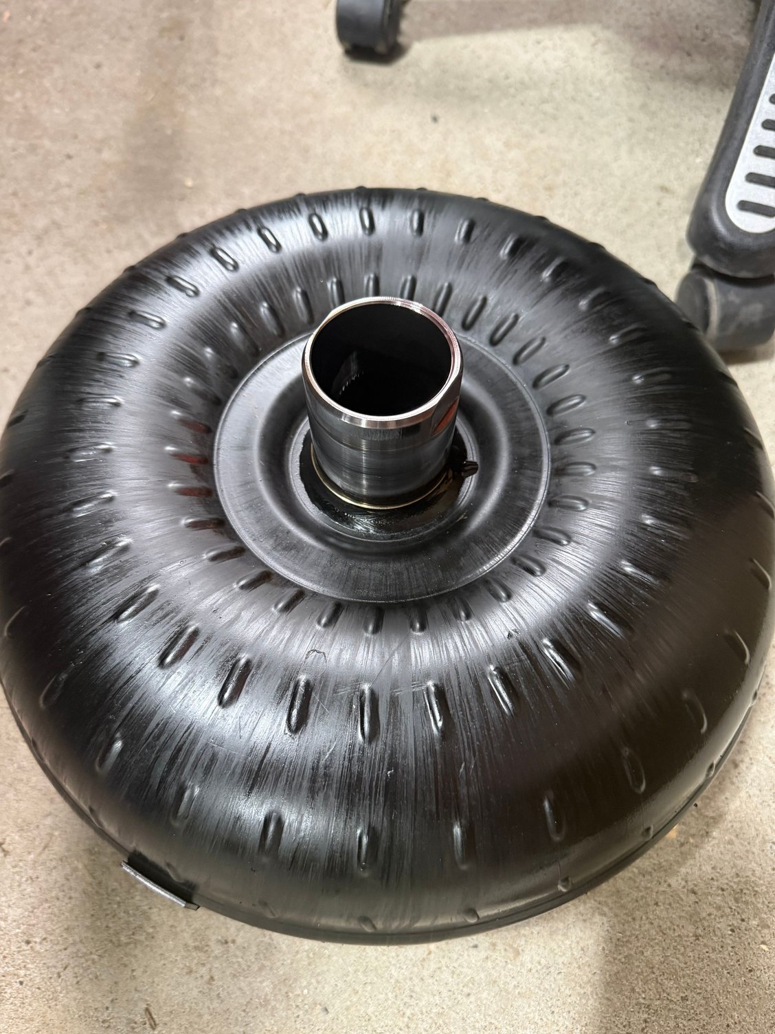

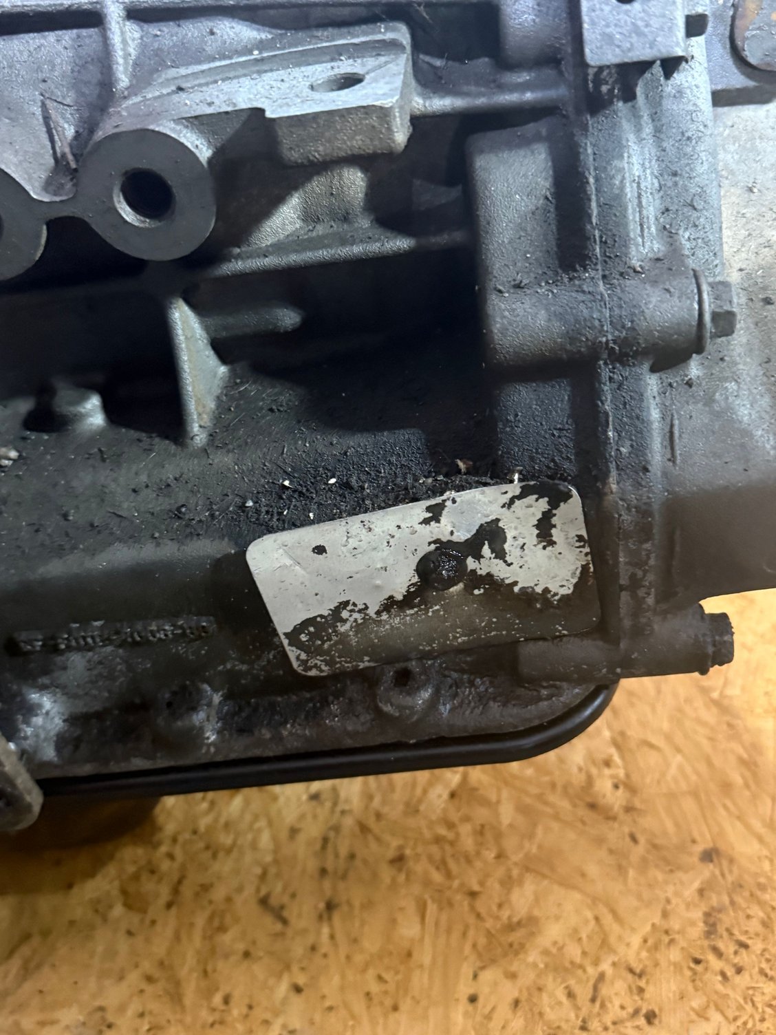

Can any of yall tell based on these pics, if this is the original vs reman tranny? How about the converter?
Interesting how the down pipe is squished and egg shaped. Seems to be same overall volume as the rest of the pipe, just squished vs circled. Correct?
I plan to remove and check the pump, replace seals and rear main while this is out but unless something obvious shows up telling me to go deeper, I’m not planning to.
thoughts? Advice? Thx guys.

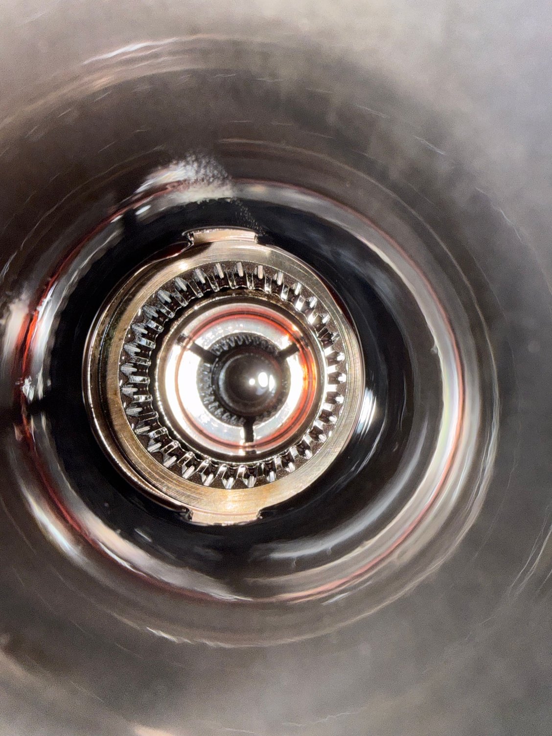

Hmmmm. Normal?

Looks like a factory converter. The pump # indicates factory pre-'95 spec (non-high volume). I'd say it's never been re-manufactured before.

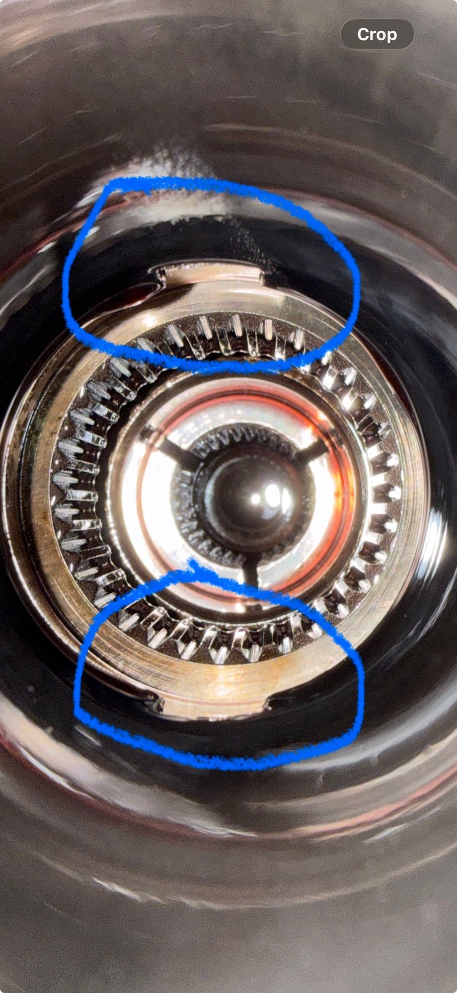

Normal?
Do the two missing sections inside the torque converter appear normal? video below.

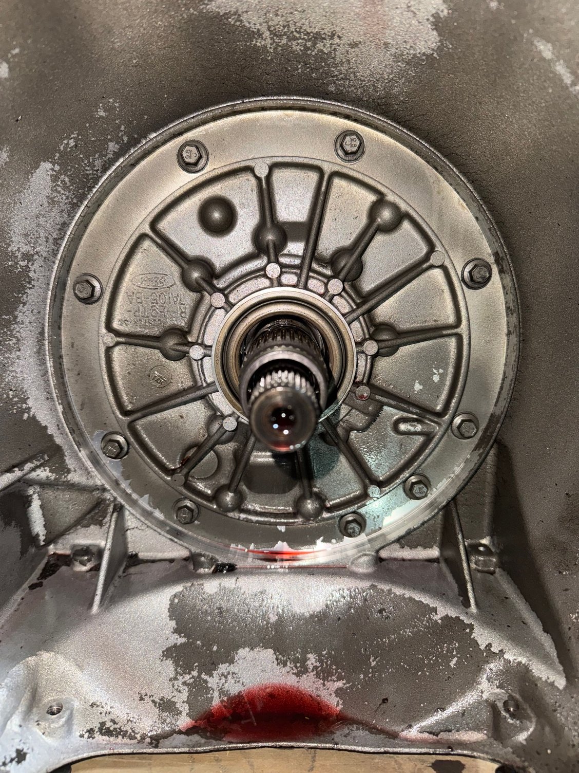

Originally Posted by jktrevecca
That's not normal. If that's part of the pump (top pic) then you'll want to replace the pump. Stand the trans on it's tail (pump facing up) Unbolt it, but don't pry against the case to push it out! You'll SNAP that aluminum cross base right off, ruining the whole trans! Instead, since you wont have the proper tool, place a large screwdriver against the valve bodies behind the pump (with pan and filter out) and use that to pry against, to push the pump out.
Replace it with a reman pump from ebay. Look for a '95 pump. It will have a "F-5" casting #.
You'll need a pump seal kit too...at least the gasket.
Pluck the seal out and take another pic first. Converter looks normal but don't worry about that. You already know that is shot (from 2 previous threads you posted). If you were to cut it open you'd probably find the problem; bent or lose vanes.
If you want to pull the pump right:
https://www.ebay.com/itm/315445359106?
If you don't understand my instructions, don't risk it. Get the puller.
Don't pull the pump with the trans laying like it is, parts will fall out...and they are very,very,very hard to align and put back in. All you really need to do it tilt it up. Set something under it like a tire w/ rim so it's tilted up.

that almost looks like someone tried forcing the trans onto the engine without the converter fully seated into the pump.... then realized what they were doing, and did it properly before destroying the pump .

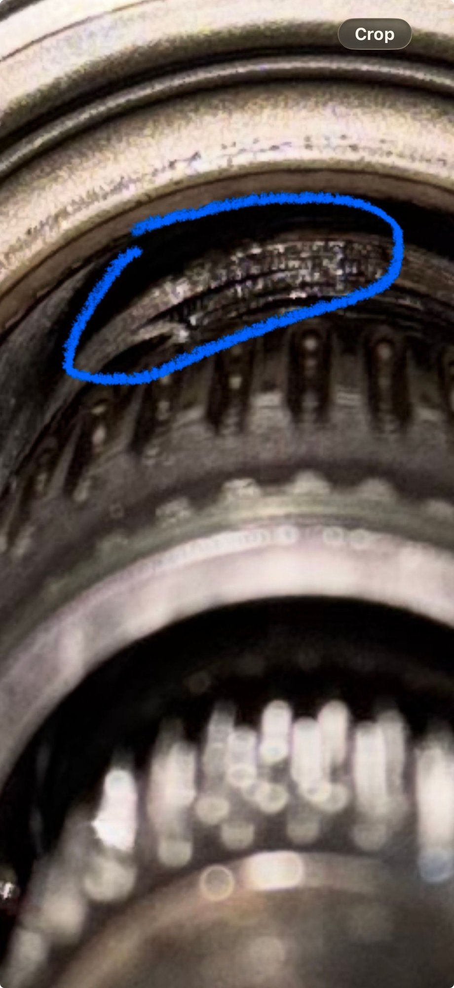

Got it! Thx. Here is a video with seal removed. I’m not seeing anything anymore. lol.

Oh good, so it was just a ripped seal? Tap a new one in there with the new converter and run her.

It wasn’t the seal but I don’t know what it was. I never noticed it until I zoomed in on the photo. Perhaps it was a reflection or just a figment of my imagination. We’ll find out soon enough. New converter, seal, and fluid all arrive tomorrow. Wish me luck getting this big girl re-installed with just a floor jack. She’s not light.

You don't see a rip in the seal? Sure looks like one, now that I see it again with you saying it's not inside. Just looks like a rip. If it was, it must have been a pretty good size leak though. Well anyway, as long as it's not there anymore, all is good haha. Good luck getting it back together.
