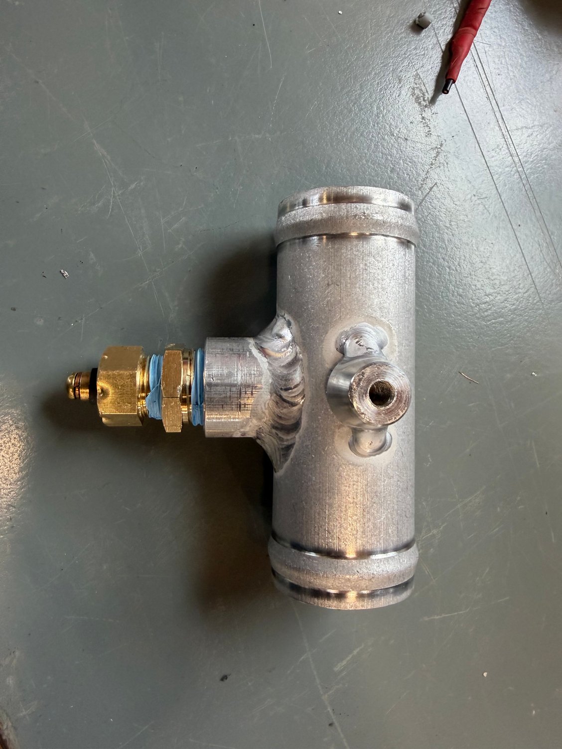

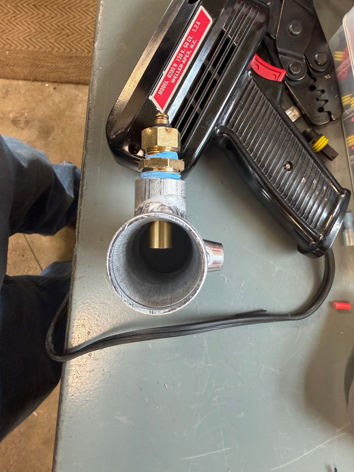

I finally got this sorted out. It is not installed in the coolant hose yet but it is assembled.
Since the temp sender was 3/8" a 3/8" to 3/8" adapter didn't work as the bulb was too large. I found coolant hose insert with 1/2" NPT threads and used a 3/8" to 1/2" adapter. Perfect fit.
The short story is on a '55 6 volt system the only temp sender that works on the 223 with the stock gauge is the stock 3/8" inch one. I still have to confirm 100% that it works once I get it installed in the next couple of days.
Honestly the part was way overpriced for what it is but it will gent the job done and I don't have the skills or tools to make one up myself.

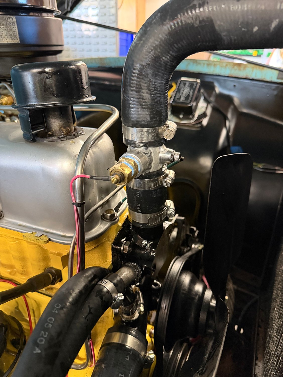

All installed and working. The head temp at the location of the original thermostat runs around 155* at idle, the center of the head is considerably hotter at 230* and at the temp sender it shows around 145*. The outdoor temp is around 68*.
The needle is just below the center on the gauge so I think I am getting a good enough reading to know when I may be having issues. If it climbs much above 3/4 it's time to pull over.
