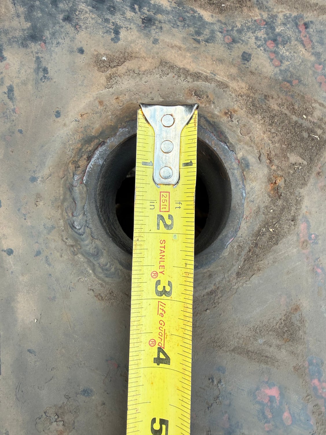

I was thinking of welding some 5/8 D-rings to it for safety chains.
The most I would ever haul would maybe be 15k if that.
The plate is 3/8 steel.
I have attached a few more pictures.
Has two bolts on each side.
Main hole.
Main hole.
Main hole
Main hole looks about 2 1/2 when I use a ruler
2nd hole
2nd hole

Is that a tapered hole?
what provisions are there to keep a ball from lifting out of the hole?
I wouldn’t use something that doesn’t have a way to keep the ball from lifting up. It’s easy to get uplift over bumps, especially with an empty trailer.

I crawled under the truck and it looks like it’s straight through. The same diameter.
I mean did they put a pin through the bottom?

God forbid he measure the hole.
I'd bet a lot of money that a standard 1-1/4 shank hitch ball will bolt right in.
Whether it's "good enough" or not really depends on what's on the bottom and how it attaches to the frame, none of which is pictured.

post #5
also, no threads that can be seen.
