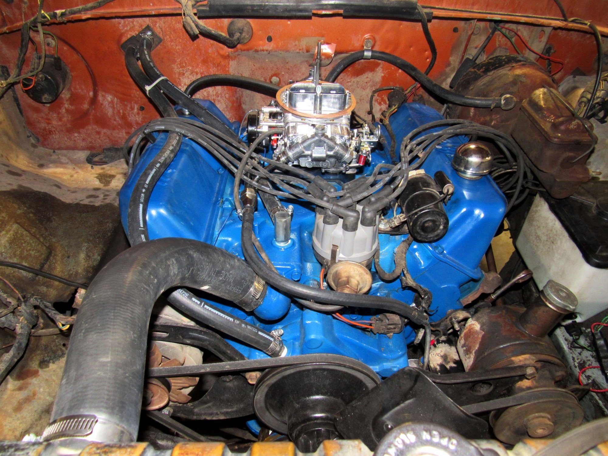

Factory cast iron intake, new 650 and single exhaust.
I sometimes wonder just how much more power I actually gained from the Performer intake, hedders and dual exhaust.
Driving the truck the only difference that I could feel with the new intake manifold was at the bottomof 3rd gear on a 2nd to 3rd shift.
And I wish these weren't such lousy road tires because they would eat my current Ironman M/Ts for a snack.

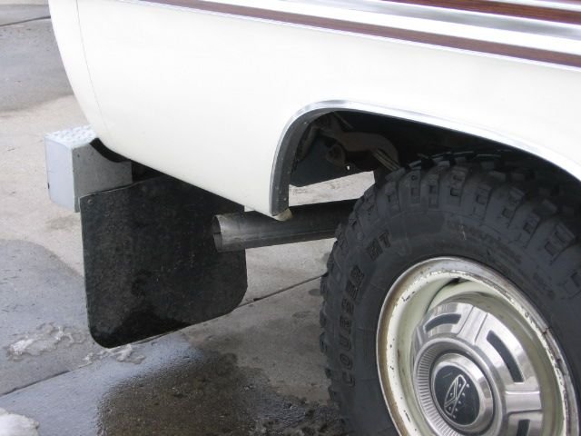

My friend that did my exhaust made this 2.25" from the collectors to 3".
I did a single 3" on my 1972 F-250 390 4V.
I wanted the exhuast to look stock so he used a 3" mandrel bent tail pipe.
I thought it looked and sounded great.
Sorry its an old crumby video.
390, 1966 Ford 390 GT S intake and factory Holley, Hi-Tech Racing Reactor camshft, Hedmen Hedders and a 3" exhasut with a Flowmaster muffler.
I sold that truck in 2009 with less than 42,000 original miles on it.
