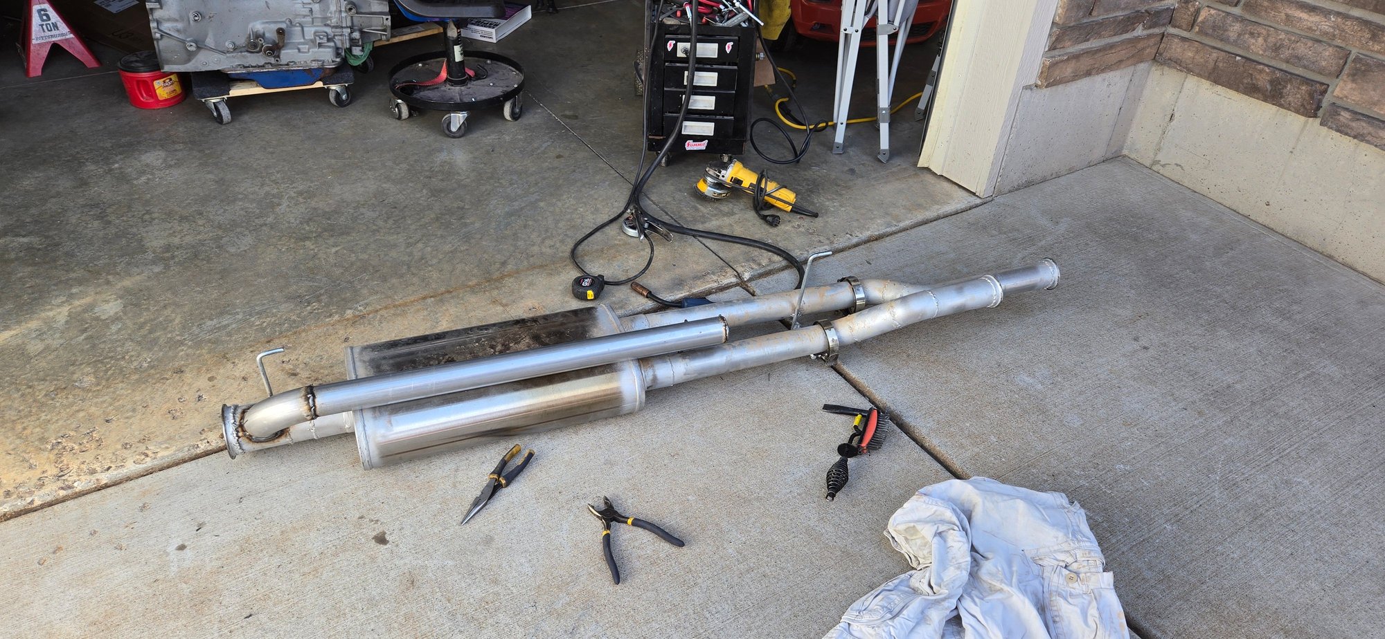

My '07 had a FM on it when bought, and it had lots of drone, but a 28" long 3" ID cherry bomb in front of it helped, but the real "drone killer" was about 10-12 pond weight clamped to the head pipe about midway cured the drone. I just used two Crown Vic exhaust weights welded to a angle iron bracket and clamped in place.
I just wrapped my SS pipe with a sheet of SS to keep from staining the pipe if the U-bolts tarnish.
My '77 had two glass packs the day I bought it in 1986, I parked it for a few days and then my muffler guy got me in, bent new twin exhaust, two Super Turbo Mufflers ever since. No drone at all. Guess if ever needed again will buy a preformed kit as he had to retire due to health.

That picture was after I had replaced the terrible loud droning (uncomfortable drone and plain embarrassing) exhaust that came on it which was a 3"SI / 2-1/2" DO style FM aluminized steel system started to leak (rust joints in places), replaced with a total SS "Legato" branded system, same design, and the SS muffler was exactly like the FM, even had polished tips, etc. Was a little cheaper $$. It sounded exact same except no leaks, and since a regular GP had worked some before, I bought the SS version 28" long 3" ID and put it in same place, same mild improvement but still bad at a steady cruise at 1900 rpm. I had those left over weights from a CV system which I had bought off a wrecked '01 CV to put under our '01 MGM (just to upgrade single to dual, was in 2001 not long after purchase, I worked the wreck, elderly couple got hit by a college student at high speed on I-81, spun and hit the guard rail all 4 corners, stopped with hood under a guard rail so when I heard car was totaled, I asked the wrecker buddy where it went since he towed it after the adjuster, was a local yard, $100 got me the system plus 4 new like tires and the lacy spoke wheels and the FS spare), but it too had the weights. So those two were in my scrap box. Weights are steel pipe filled and sealed with concrete. They 100% killed drone.
