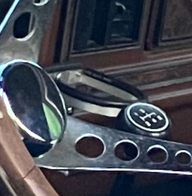

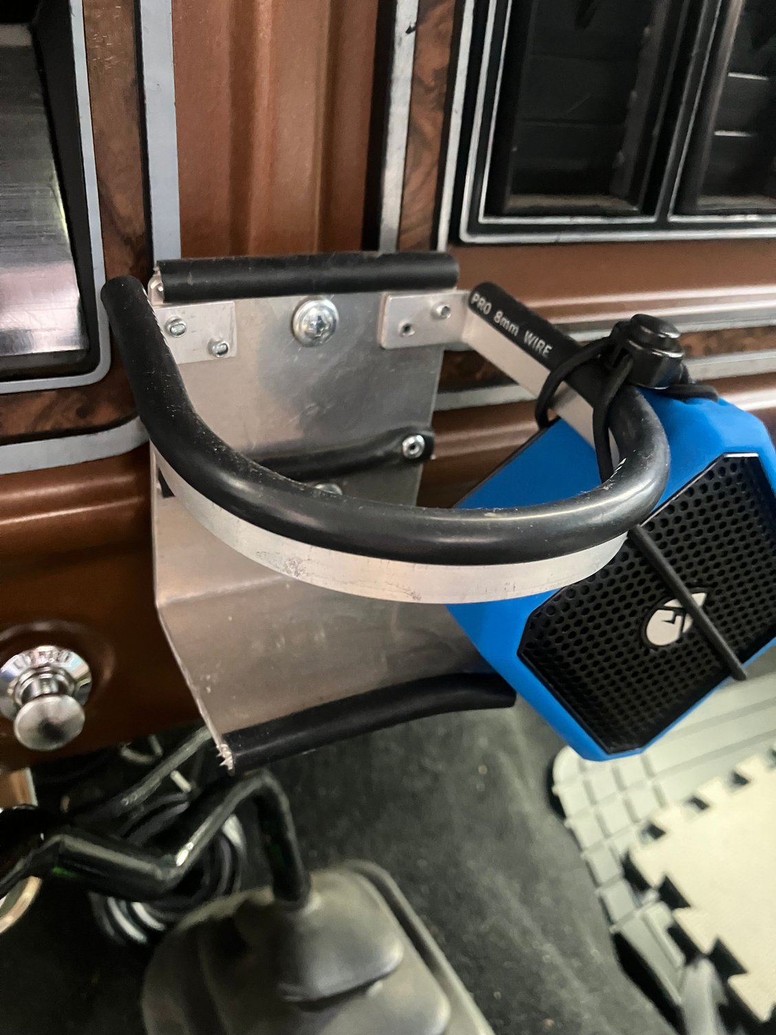

I’ll try to remember to take a picture later when I’m out there, but I made a simple water bottle holder that’s screwed to the dash (sorry purists). It’s a piece of large aluminum angle, with a 3/4” x 1/8” flat bar bent around in a hoop, and some extra spark plug wire split down the middle for edge guard.
It just clears the shifter, and is a decently central spot for the right hand. I had already put the two screw holes there years ago for a mounting spot for my EFI handheld, so

Bonus shot, also showing my killer Bluetooth sound system.
