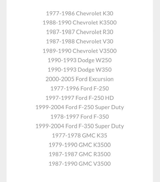

I check multiple sources especially the manufacturer if possible. Their system probably isn’t smart enough to sort out between a Dana 44HD and the Dana 50/60. This is what you need
if your looking for premium hubs.
Just tell them you need the HD front hubs
They last forever, I'd hit a junkyard for a good set
Same HD (bigger) hub fits clear back to the eighties
I have picked up a couple pairs of OEM Warn hubs and a set of Superwinch from the junkyard. I didn’t like the Superwinch hubs so they are boxed up in the shed. You mistyped 70’s
g
gm history with Dana 44hd is annoying.
Here’s a 1980 gmc with Dana 44hd. The the 1977.5-1980 gmc and Chevy models with the same locking mechanism across half ton and 3/4 and 3/4 >8600 gvw Not sure of 1 ton(Dana 60)
