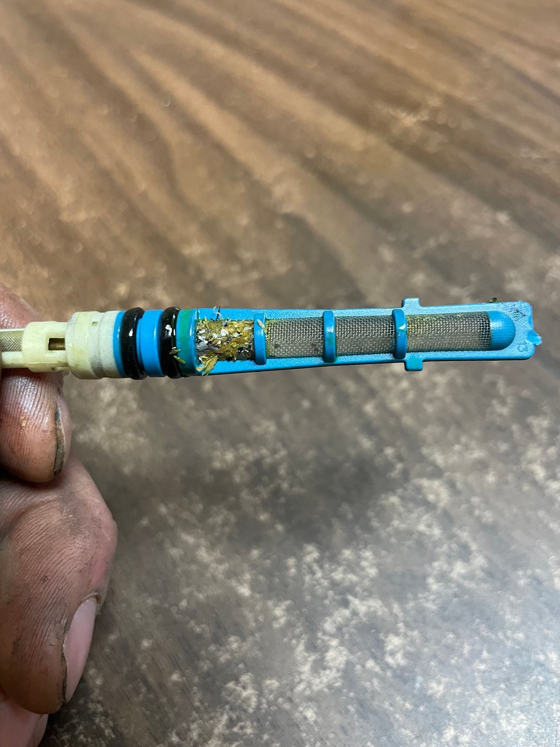

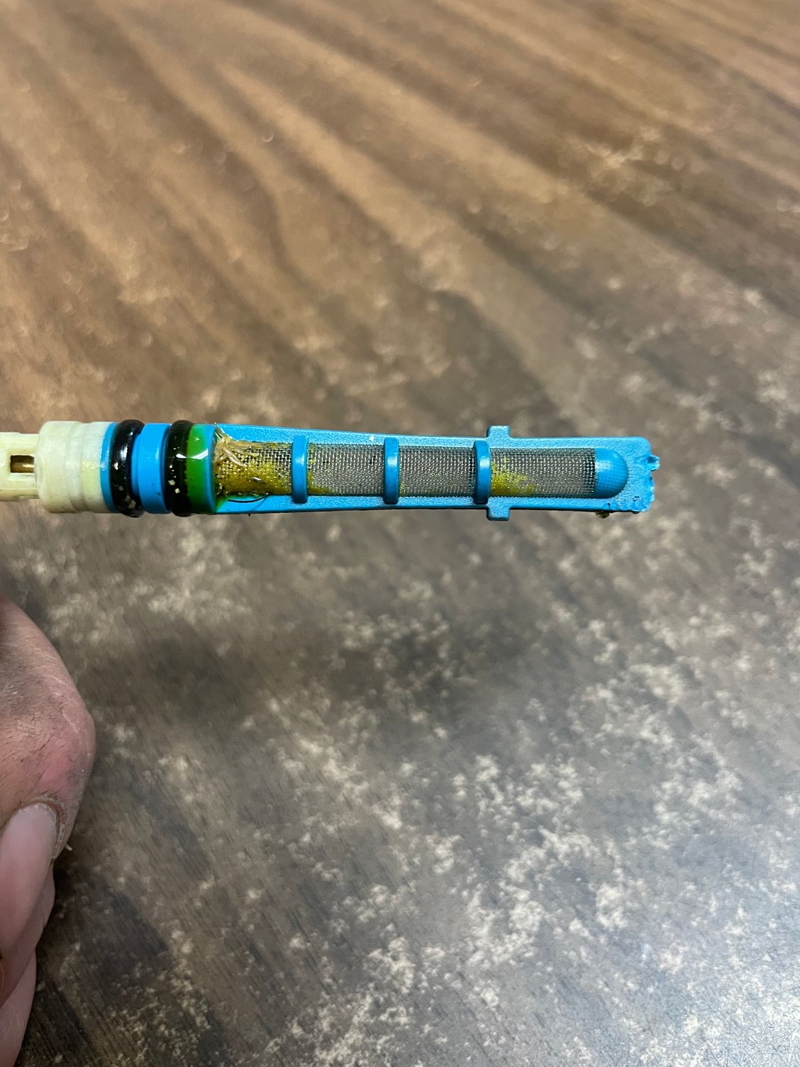

Started working on this this afternoon, here's what the orifice tube looks like. Is the compressor starting to fail? Looks like aluminum and I'm assuming Teflon.
