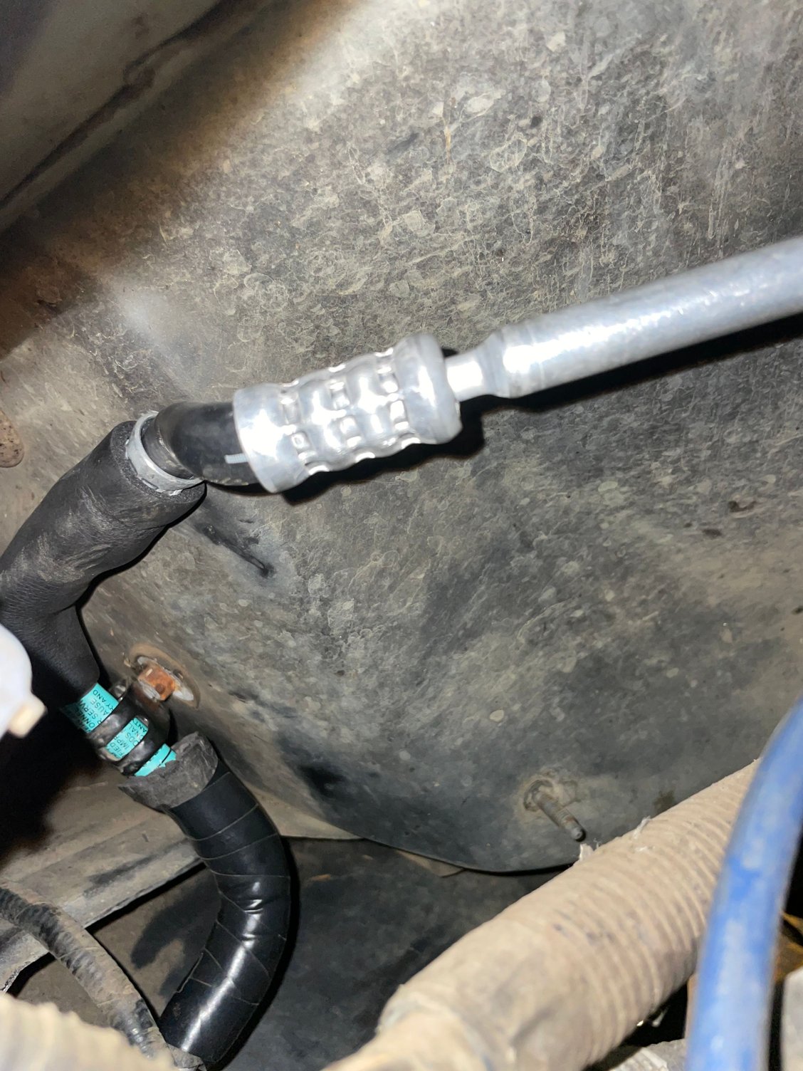

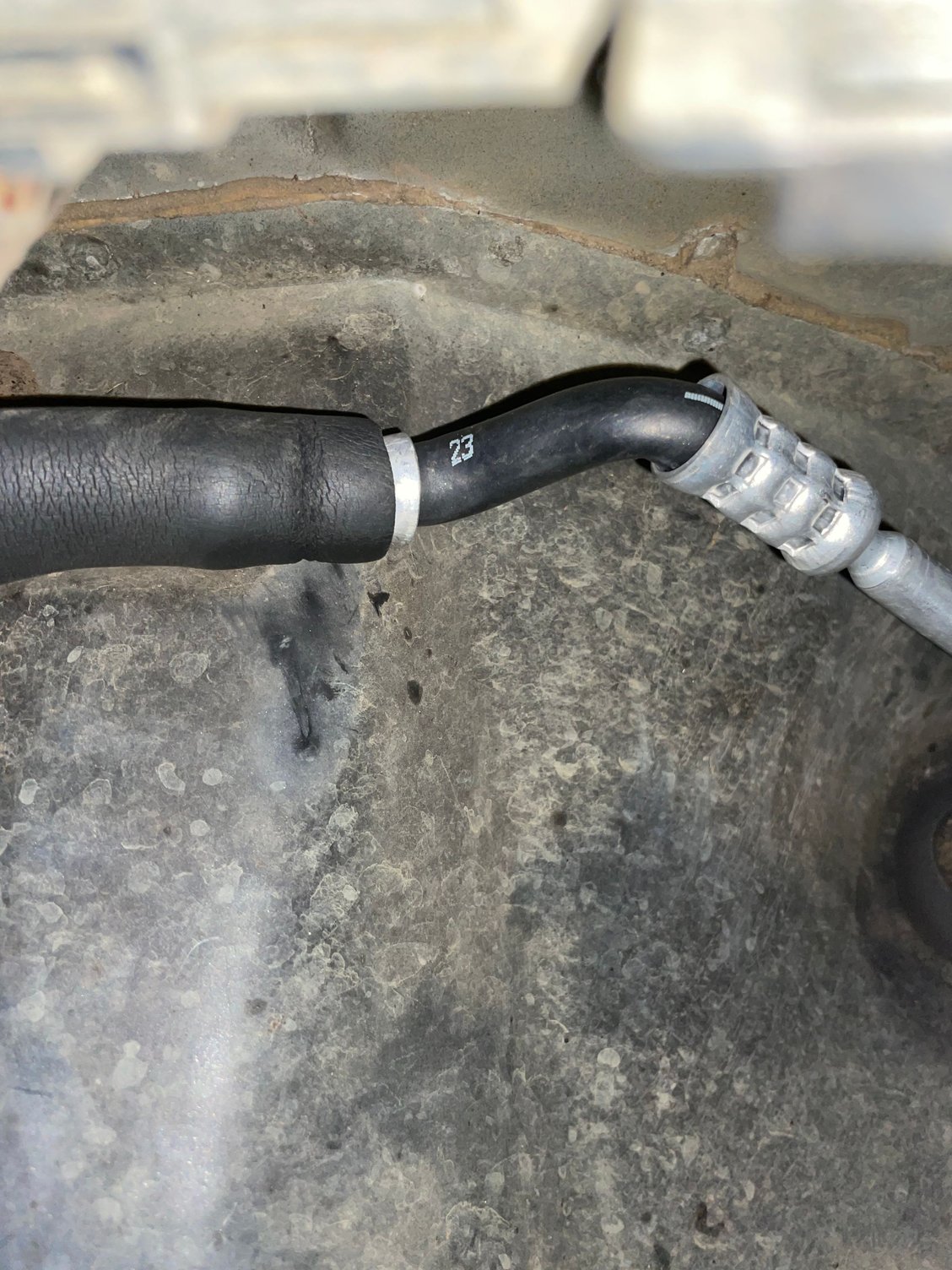

What do you make of this? The old line was slightly different than the new one. The new line I have is part# T56105 the tube is reduced down where it comes out of the rubber hose at the evaporator end. When connecting the line into the evaporator it puts the rubber portion into a bend. The old one was shorter at that end, not necked down and the rubber portion wasn't cranked around like this new one. It appears that that is the correct part#. Also seems like the manufactures are using pictures of this line that doesn't necessarily represent what you'll receive. Rock Auto lists that number under "Famous Brand" and 4Seasons, the 4 Season's one looks like this new one, the "Famous" looks like my old one which is what I ordered and clearly that isn't the case. O reilly sells 56105 under their Murray brand and it looks like the new one I have. Auto Zone has the 4 seasons listed and it looks like my old one. Then if you check NAPA they show one that looks like the new one I have. Sure it will work, but it seems like it would be better if the line wasn't under such a harsh angle.
Old Mar 3, 2026 | 02:42 AM
manicmechanic007's Avatar
manicmechanic007
Joined: Jul 2020
Posts: 9,915
Likes: 2,439
From: Near Salt Lake City
I bend the aluminum tube so as to put less strain on the rubber hose
I think it'll work

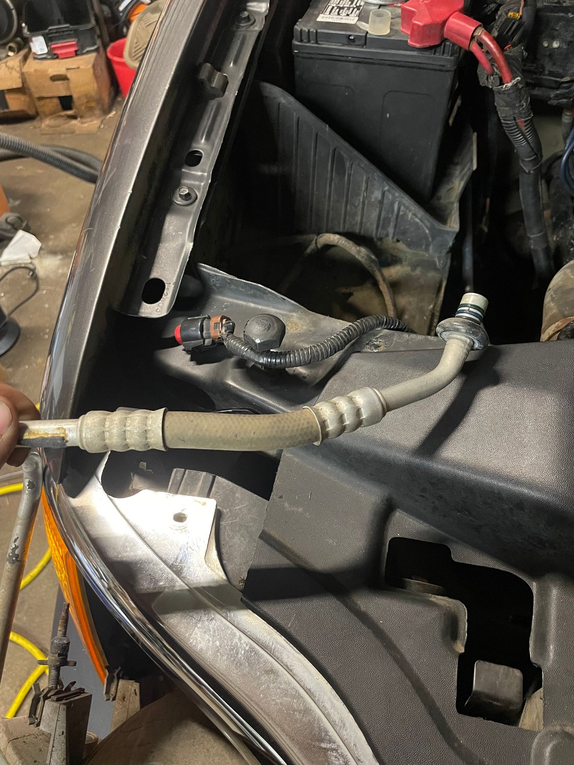

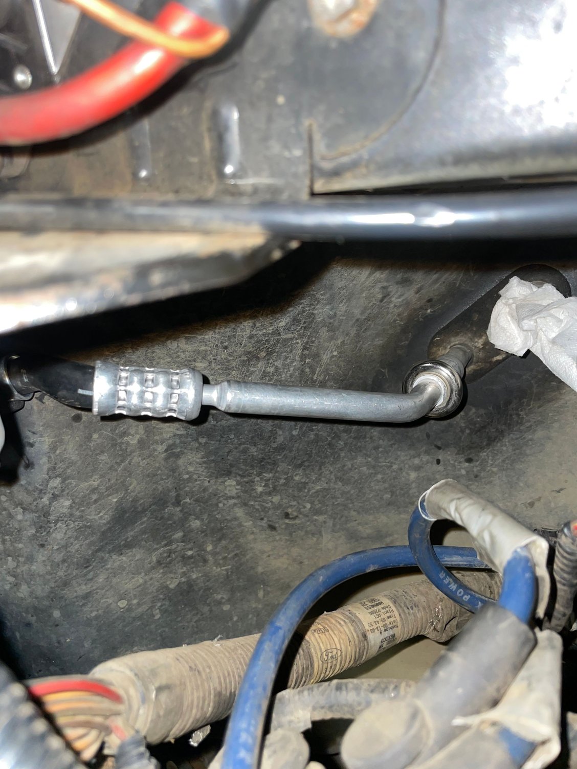

It is hooked up, not a real big fan of that angle but apparently that’s what I’ve got to work with. Called a few different auto parts stores, the part # I have is the only liquid line available for the vehicle. According to them. Ford has discontinued it, my old one wasn’t leaking but I can see a few small cracks in the rubber hose portion of it. Don’t really want to reuse it either. Rockauto lists a Motorcraft hose part # YF3390 looks to have the same end at the evaporator core. But has a second rubber section near the condenser connection. Also have no way to know the actual length. Application says from build date of 4/12/2004. Mine has a build date of 12/03.
Old Mar 15, 2026 | 02:08 AM
  #30
Aaronw12's Avatar
Aaronw12
Joined: May 2019
Posts: 215
Likes: 27
I found the correct replacement Liquid Line. None of the parts stores or their websites list it. They only list the 56105 line. Parts guy cross referenced the Ford part # off the original line. He came up with Omega # 34-63455, it fits. Looks exactly like the original besides only 1 foam pad and didn’t include the hold down bracket. I used the bracket and 1 foam pad off the old line.
