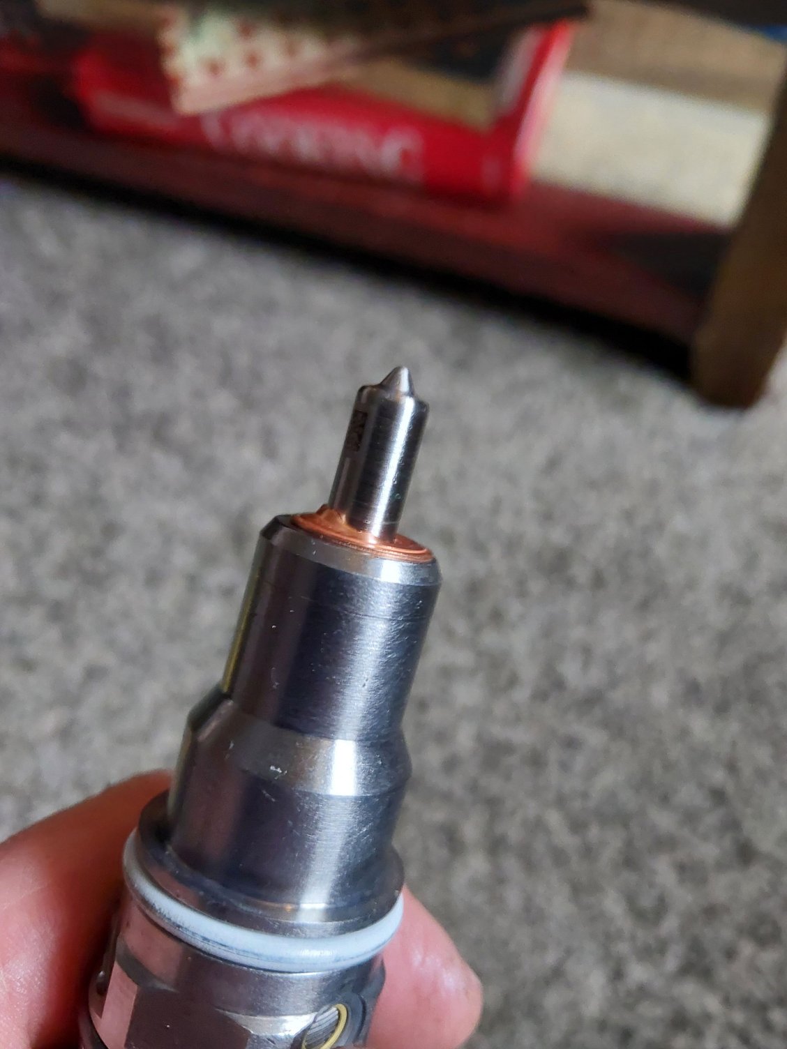

Crush gasket is misshapen. New reman injector from Alliant that i just opened today. Do yall think it would be fine to use?

I would say maybe and not worth the risk, but I've only had one injector out once, so not much real world experience here

No way is it worth a 1.00 crush washer doing the job again.
No brainer on this one.
Get a new one

After the fourth parts store and a hour of time, I found someone that had a set for one injector. Agreed I couldn't chance it. My luck is nothing to brag about.

Even if it was fine, if you're like me every time your cranked the truck your brain would have a flinch
I stripped a bolt on the fuel pressure regulator 75k miles ago, and every time I smell raw diesel I immediately go to that.

Alliant Fuel Injector
I would contact the vendor and asked for a replacement. Not worth the risk using a bent washer. I replaced #4 fuel injector a year ago and was pleased with Alliant.
Already installed. Runs fine now.
