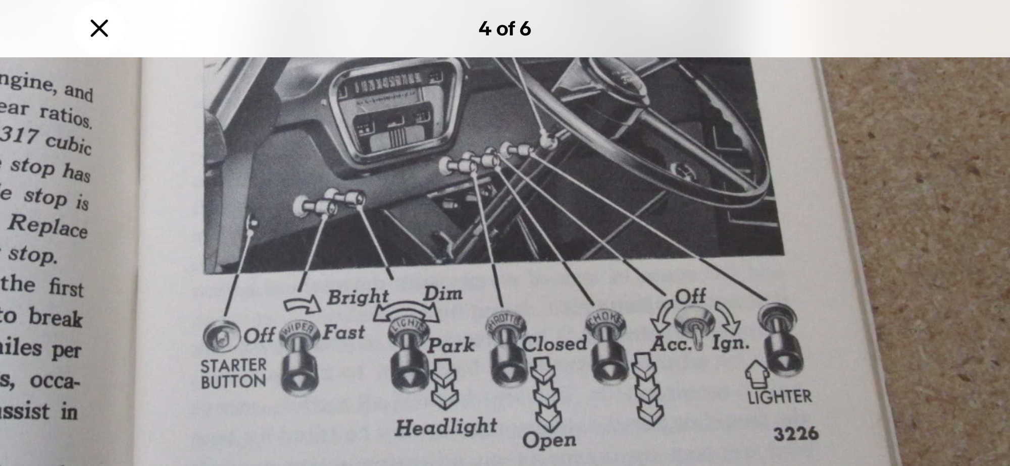

Hey pltnsgt06, that picture is perfect. Where did you get that? I don't know any owners manuals with 3226 pages in it.

3226 is not a page number, but the Ford's picture identifier.
It can be found on this publication's page 5:
