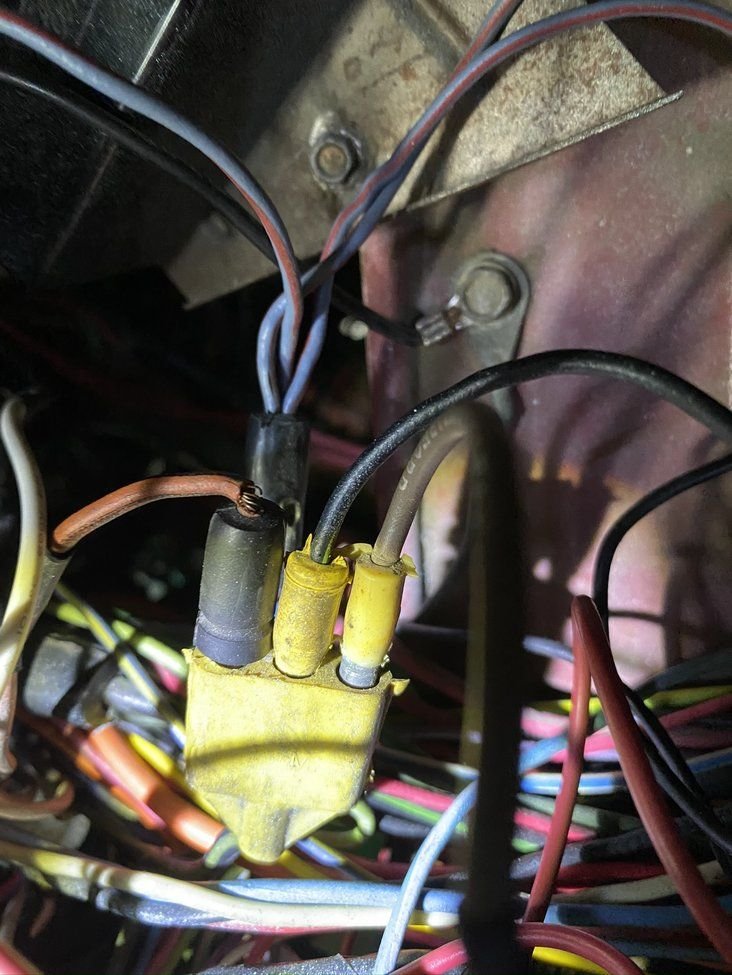

Hello all, I have a 1973 f100 and i recently installed a pertronix ignitor II with a pertronix flamethrower coil. And I’m having trouble finding a switched constant 12V, I have checked my fuse box and none of them have voltage when the ON position is switched. If anyone has any idea how to get a constant keyed 12V I would highly appreciate the help, thank you all.

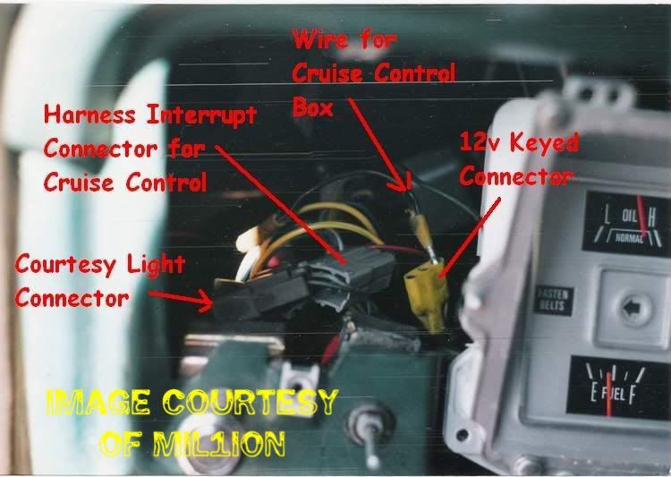

Thank you for the reply I’ll get the 12V from that wire 🙏
