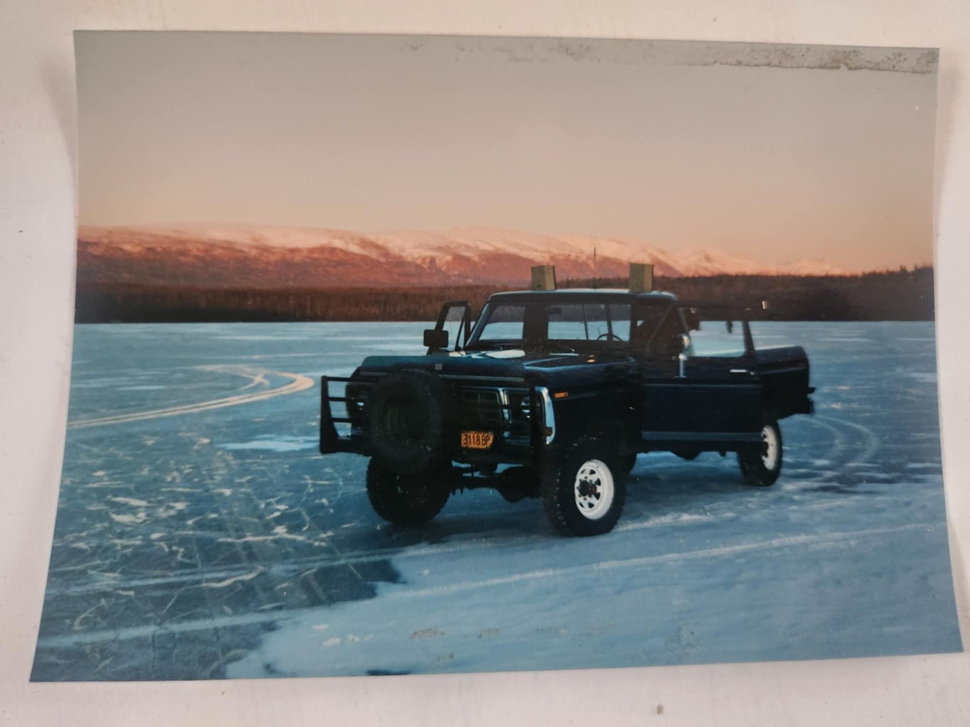

Looking for a bug deflector
Hey everyone, I am looking for a bug deflector that goes across the hood. I am trying to make it look like it did back in the day. I am located in Alaska so shipping might be a pain but I am trying to beat 400 bucks out of pocket for one on ebay.

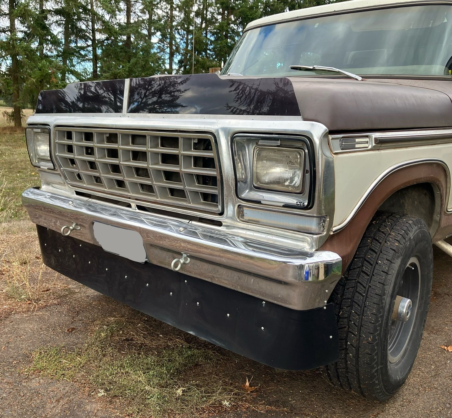

I looked for a while, but ended up making one with aluminum angle, aluminum flat, acrylic, machine screws, and tek screws.
The OG sets off the front of the hood, with a slight gap, and brackets offset; mine sat pretty tight to the front of the hood and just behind the grill surround after adjusting it for clearance.
With it tight to the hood and vertical it helped a lot with wind noise, but the windshield washers wouldn’t spray properly because of a low pressure area that was created by the deflector pushing so much wind up and over the cab. It also made the quarter windows much less functional with the back slider on hot days. I pulled it off a few weeks ago actually.
PM me if you want the specs, and I’ll send you my measurements.

Nice truck and nice moose bumper. Yes good luck with finding one, and extra good luck finding one IN Alaska. You might be better off to ask for a 1 lb brick of gold hens teeth and 5 gal bucket of unikorn tears. Places to look are FB MP, Craigslist and or the FTE Alaska chapter. https://www.ford-trucks.com/forums/forum152/

Up there in post #2 is the way. The originals used 4 little "Z" brackets that raised the aluminum up above the grill shell and moved it out a little, and you can bend the plexiglass with heat if you like.
