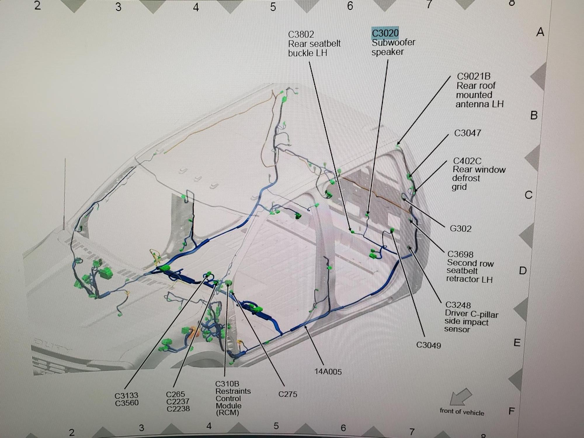

EDIT:
If you go looking, let me know. Here is wiring and location

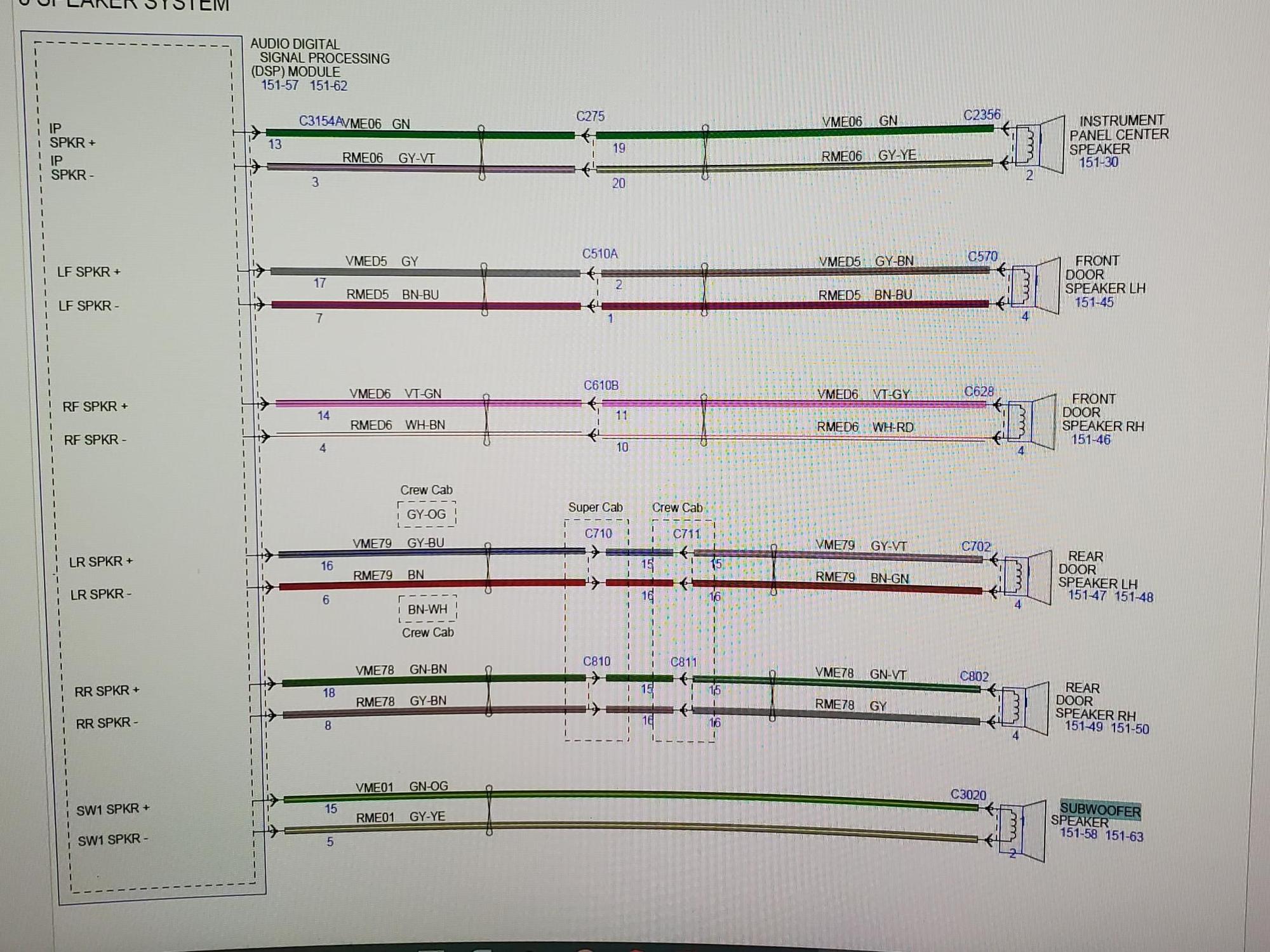

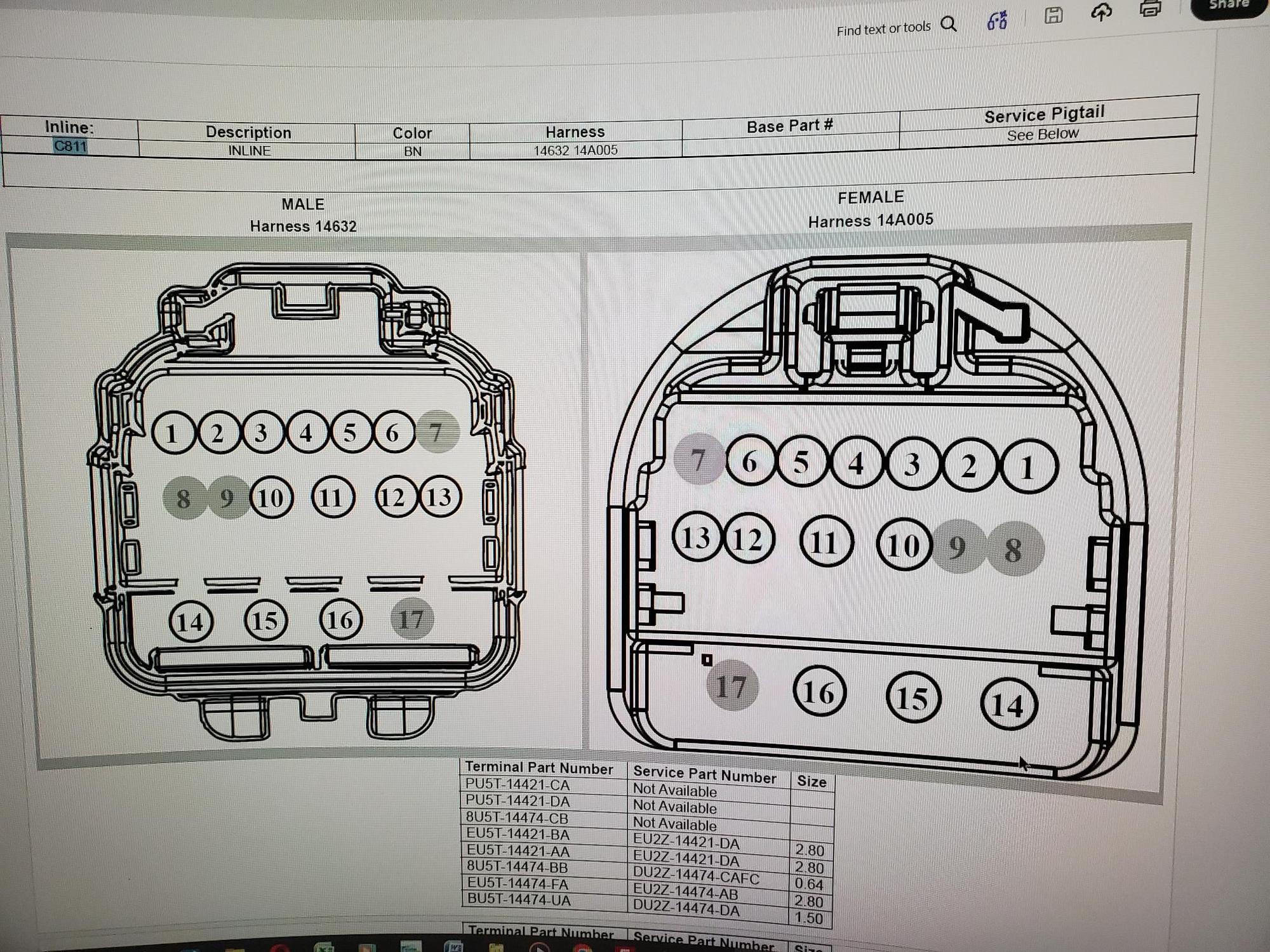

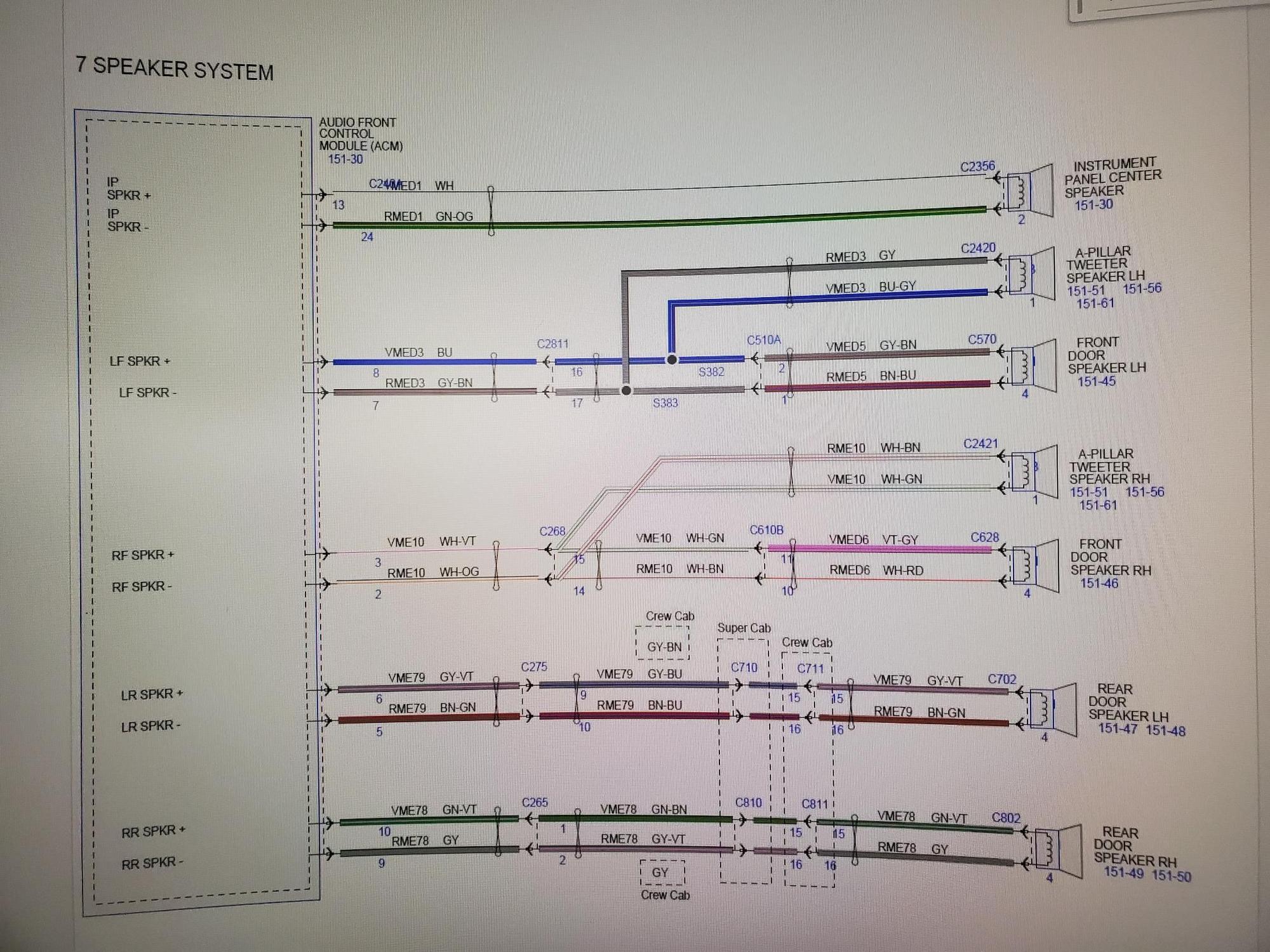

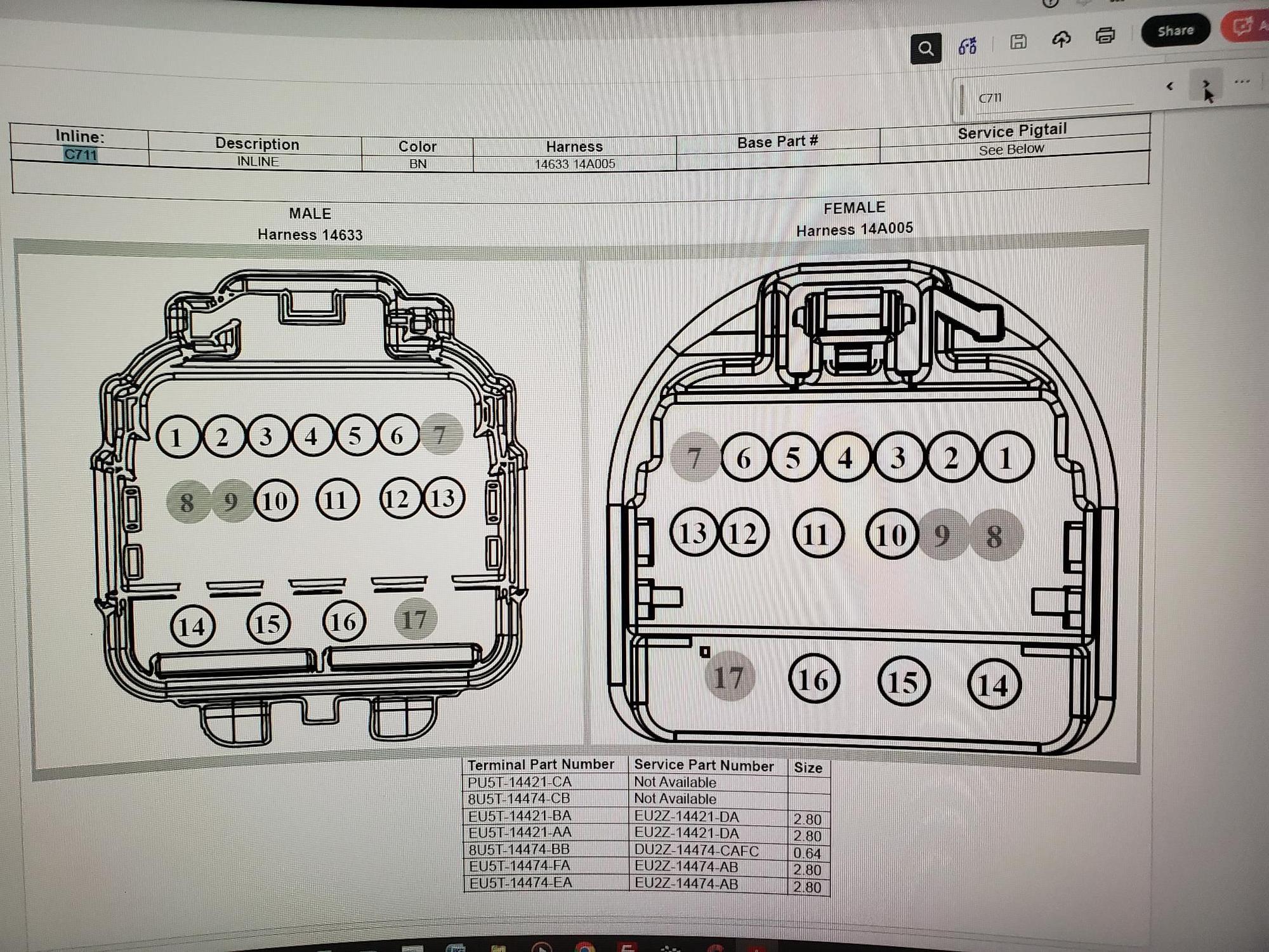

Have the truck and going to add the sub this weekend. Going to tie into the drive side rear speaker line in the pillar between front and rear seats.
I know there are diagrams here but looking to confirm what color wires I should be looking for the rear driver side speaker. Looks like the color changes based on cab configuration.

Wanted to give this another bump since I'm doing the install tomorrow morning. Anyone help confirm what the rear drivers side speaker wire colors are on a 2026 crew cab?
