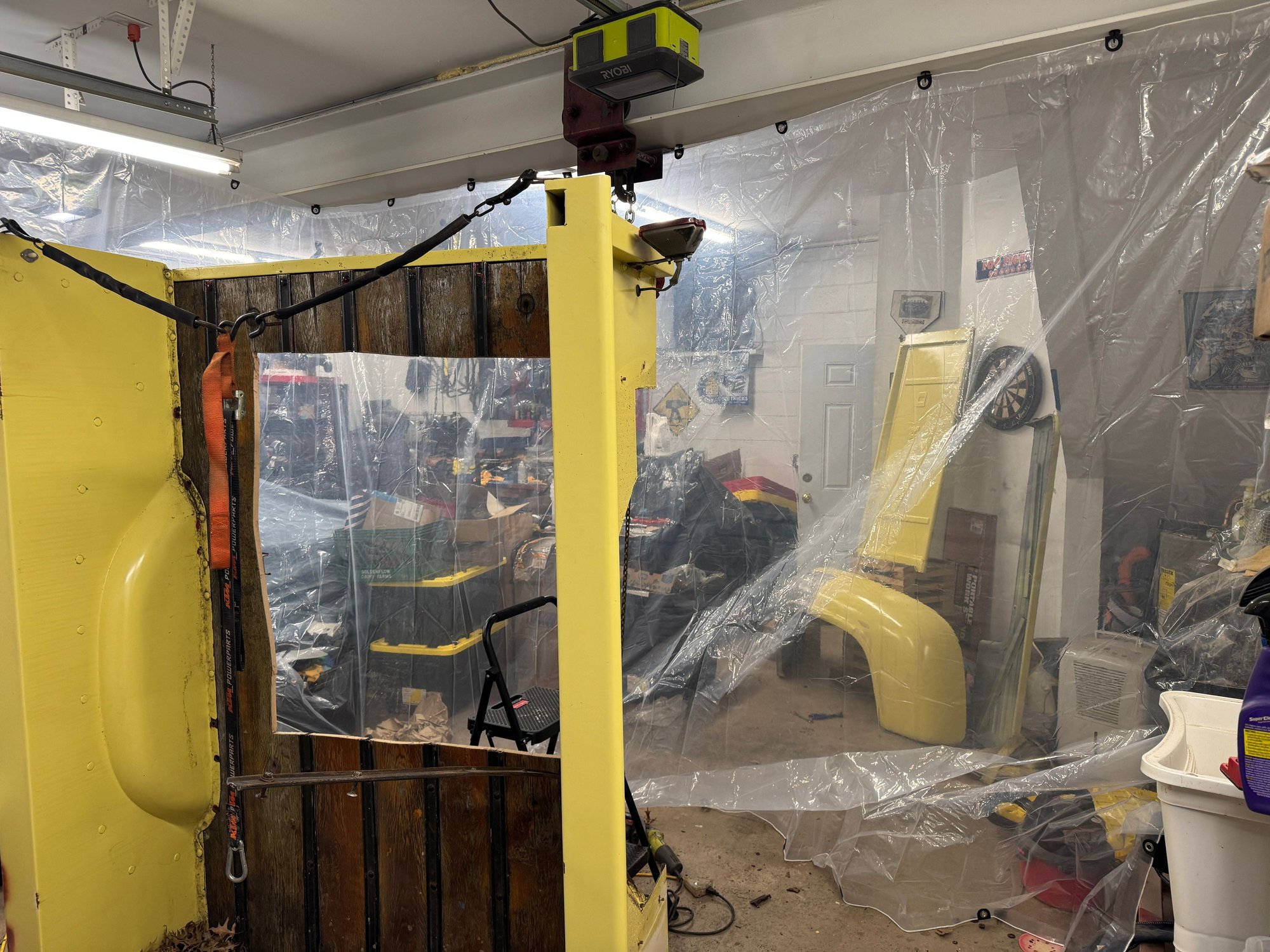

I’ve been sanding down my bed using an orbital and 60 grit and it’s just a bear to get through three paint jobs from over the years.
So I reached out to a place to see what they would charge to media blast the two side panels, front panel, and tailgate. Also asked if they would epoxy prime it so I don’t get flash rust.
Quote came back at $2,000 and I can’t decide if he just didn’t want the work or if the price of labor and material has just gotten more nuts than I thought.
what do you guys think?
I’ve now fully removed the bed wood and it would just be this and the tailgate without fenders.

So, what is the deal with the Ryobi box on what looks like a custom made I beam hoist trolley?
Very interesting
Very interesting
bit of an optical illusion due to the angle. The ryobi is my garage door opener. There is a trolley on the ibeam from an unknown source and then I have a 100 year old chain hoist attached to the trolley.
