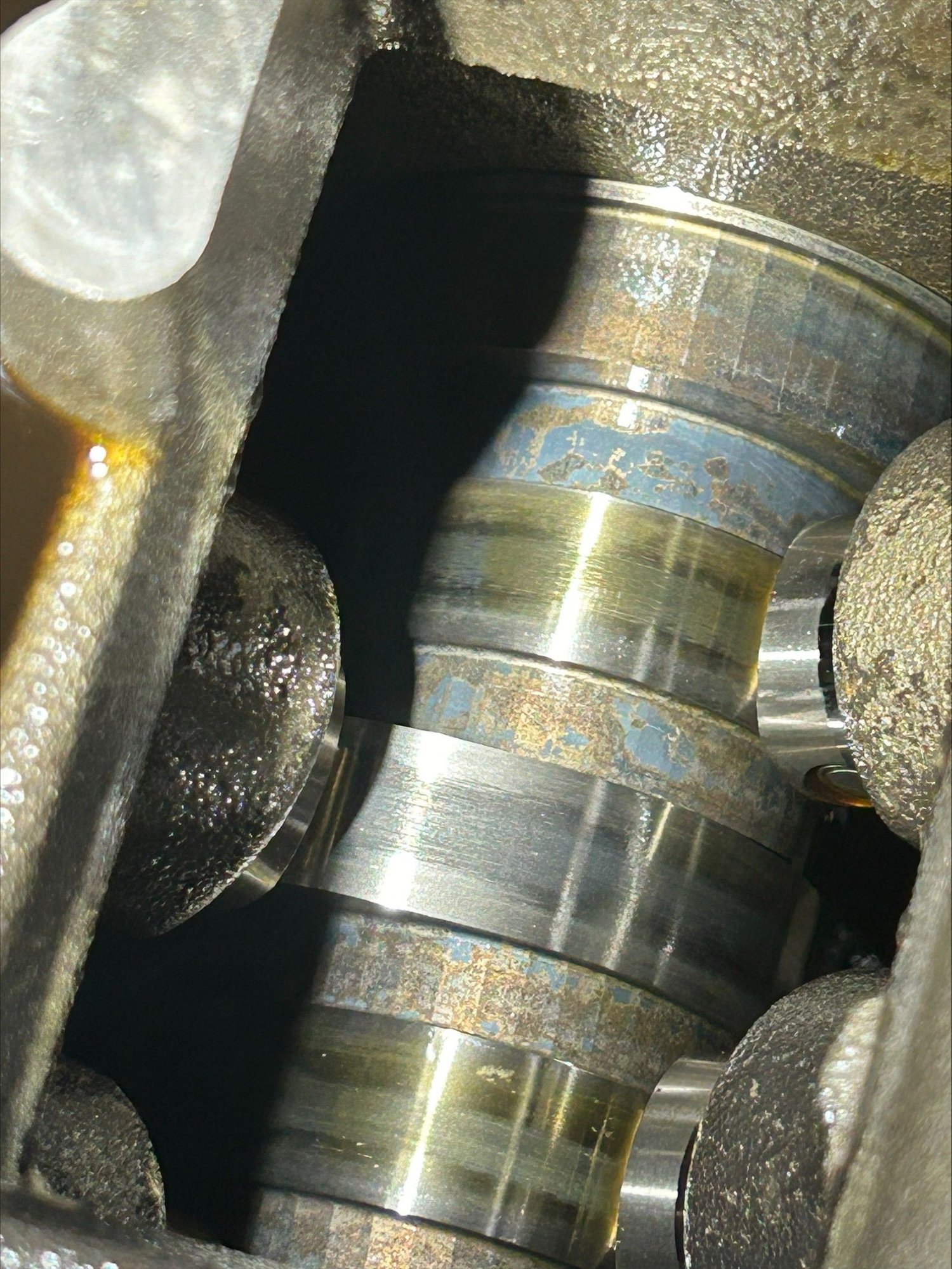

Ill get some better pictures tomorrow. But i couldnt feel nothing with my fingers

Originally Posted by Jayce007
I had just bought the pickup a month ago,it had gasoline ran in it multiple times. And a full tank of 3 year old gas sitting in it. But i had pulled the hpop off to get a good look of the cam
You may have much bigger problems than just a cam that looks suspect.
Curious why you took a chance on this truck with its history.
I got the pickup for 2 grand, it has 130k miles/4500 hours on it and has been "bulletproofed" with ton of money poured into it by the previous owner. But i am not sure after seeing the cam shaft if its worth fixing it up or going a different direction.

JMO and far from an expert, but looks normal to me. Could rotate to see top of each lobe

The cam doesn't look worn that bad based on the pic. For the price if the PO dumped money into it and worse case you need injectors from the gasoline, you're ahead.
Run it and see what happens

Hope these are better. But the pickup started right up after draining 40 gallons of gas and flushing it out. I have put around 2k miles on it so far.

Hell, run it. If you get a year out of it you probably got your money's worth. If it's well optioned & still in nice shape, you could even justify a rebuild if/when it dies.
