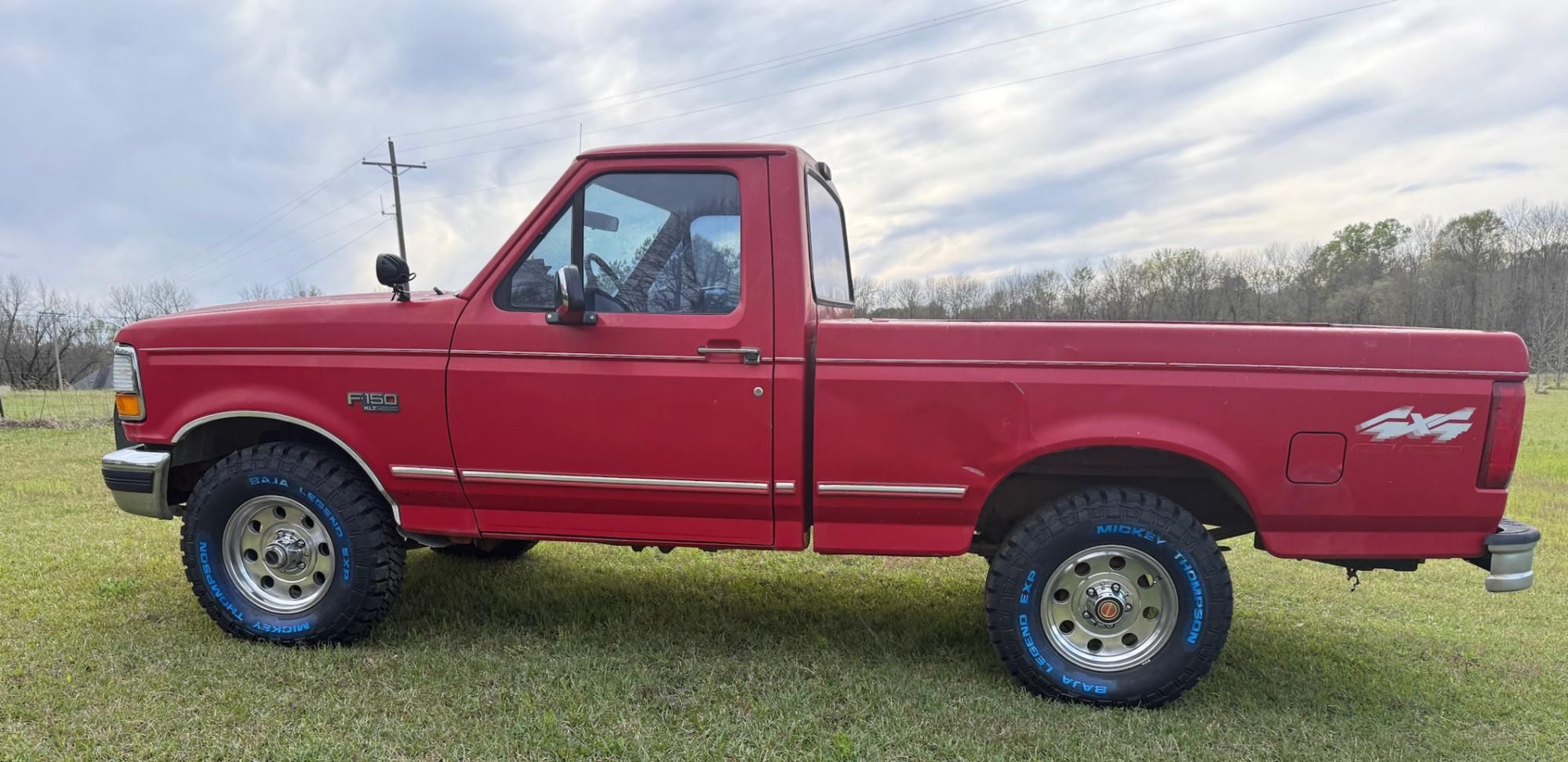

I recently picked up a 1996 F150 XLT 4WD and want to do a mild left/level on it to clear some larger tires. I ran across this kit from Late Model Restoration and was curious if anyone used it. This is about the amount of lift I am looking for, and not wanting to have an issue aligning it and eating up tires. I also don't want to install drop brackets like those from the larger lifts. I am not going to take this truck rock crawling or deep into the woods, but do want more clearance and the ability to do some mild off roading. I am wanting to clear 32x11.50 tires on stock offset wheels. My truck does have the quad shock option up front. OR, Is there a better option?

I have gotten the tires and new (to me) wheels and the truck looks good. My son wants a little bit of a lift and I am not opposed to it as long as it is going to align and drive/ride right. Does anyone have real world experience with any of these kits? I do not want to go with anything over 2 inches.

This is what we want it to look like. I just want to make sure it can be aligned and it ride decent.
This is how is sits now:
This is what we would like it to look like.
