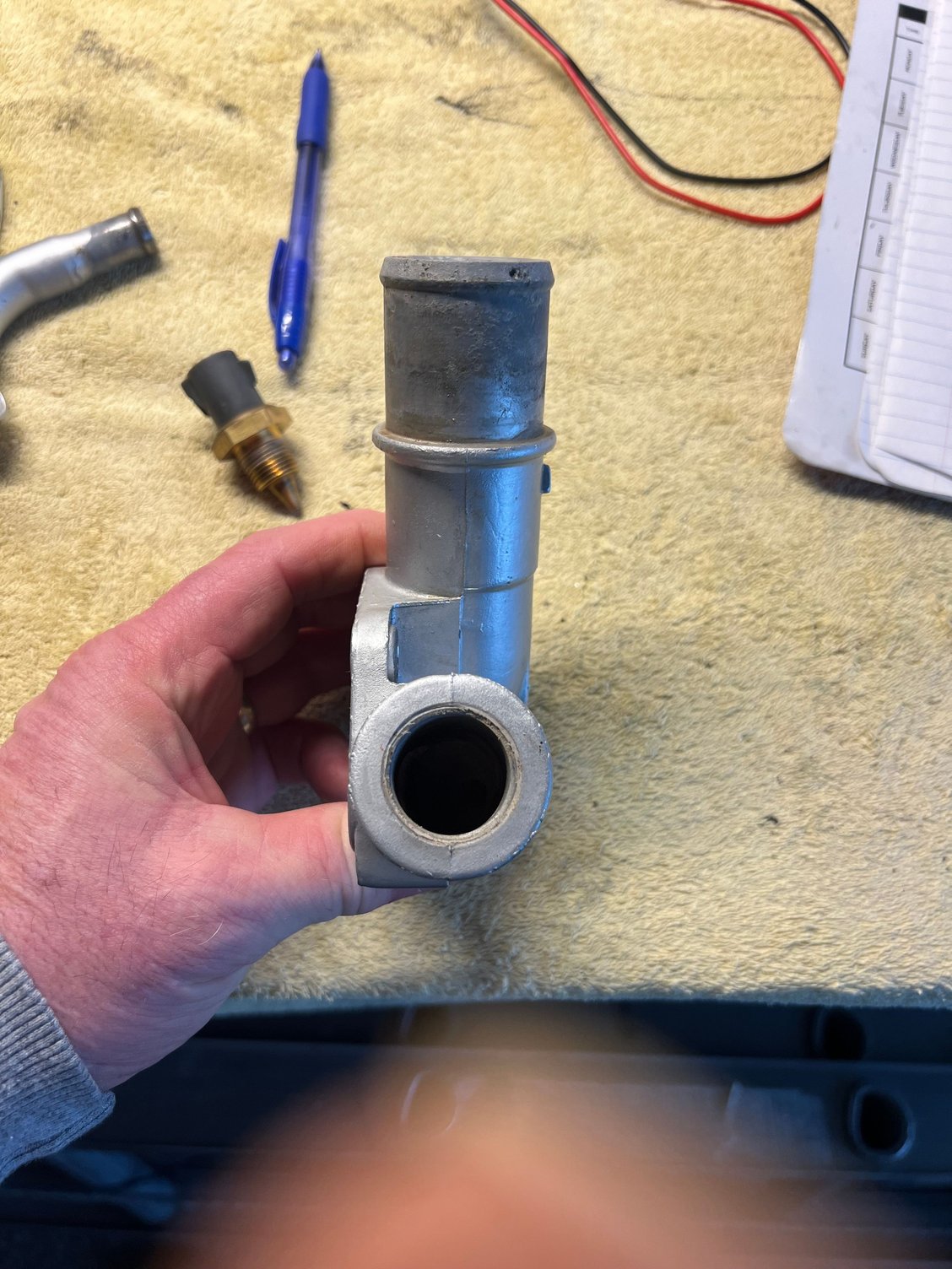

Hello Fellas
I have a 1984 Ford F150 with a 4.9 L 300 I6, 2dr, Styleside, 2WD.
Truck restored bottom the top all parts are new.
My thermostat housing cracked. As you know, they are difficult to find. The ones I’ve been looking at, none of them mention diameter of the heater inlet tube to thermostat housing or the thermostat housing to block.

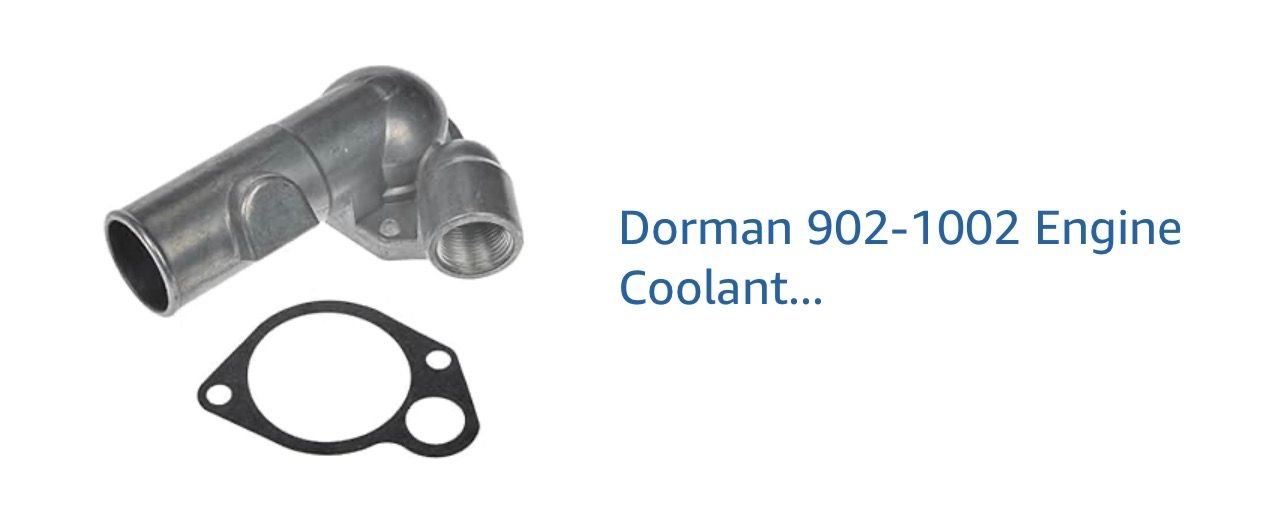

Dorman DL 902–1002 fits a 91 and the inlet tube to thermostat housing is large.
Parts Catalog has one for an 85, and the heater inlet tube to thermostat housing is large.

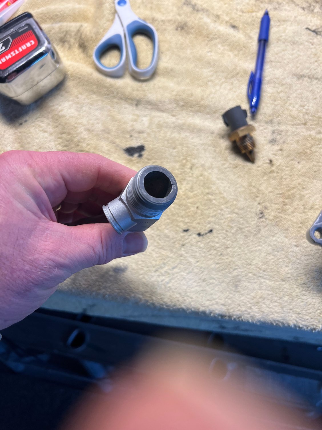

Dorman DL902-1025 fits an 84’ but the heater inlet tube to thermostat housing looks small.
when I say large and small I’m comparing it to my heater inlet tube to thermostat housing fitting, which by the way is 1”.
I just ordered all three.
Im hoping that the either the 1002 or 1022 heater inlet tube to housing will work.
As for the 1025- is it possible to have a machine shop bore and tap the heater inlet tube hole on the thermostat housing to fit my heater inlet tube fitting?
I know the junkyard is a final option but here in California you don’t see too many 80s or even low 90 trucks in junkyards.
and don’t get me started on the heater inlet tube fittings. You can’t find those anywhere except maybe a junkyard.
have any of you experienced this? What have you done to make it work?

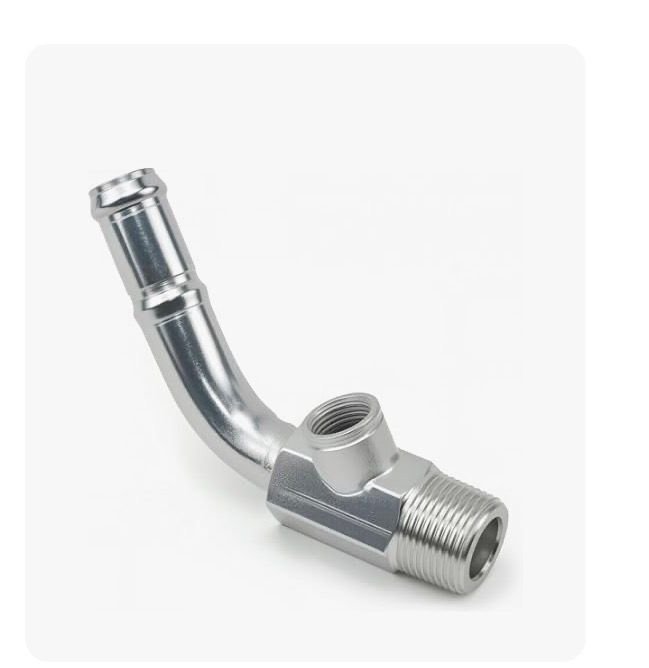

That is simply pipe threads correct? You should be able to go to the hardware store or a large plumbing supply and get a hex bushing adapter if the replacement has threads that are too large. It will look like this.

There are a few out there, I got one from Dorman. 902-1002, for 1990-1996 trucks. It’s aluminum. Ports a little larger but the thermostat fits perfect and the heater inlet tube I found fits perfect. Got lucky. Just have to paint the housing.
