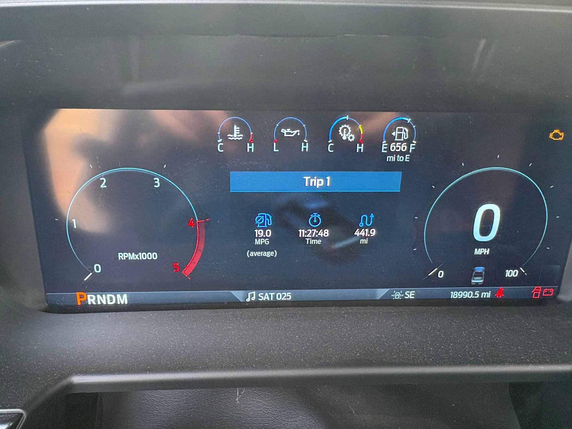

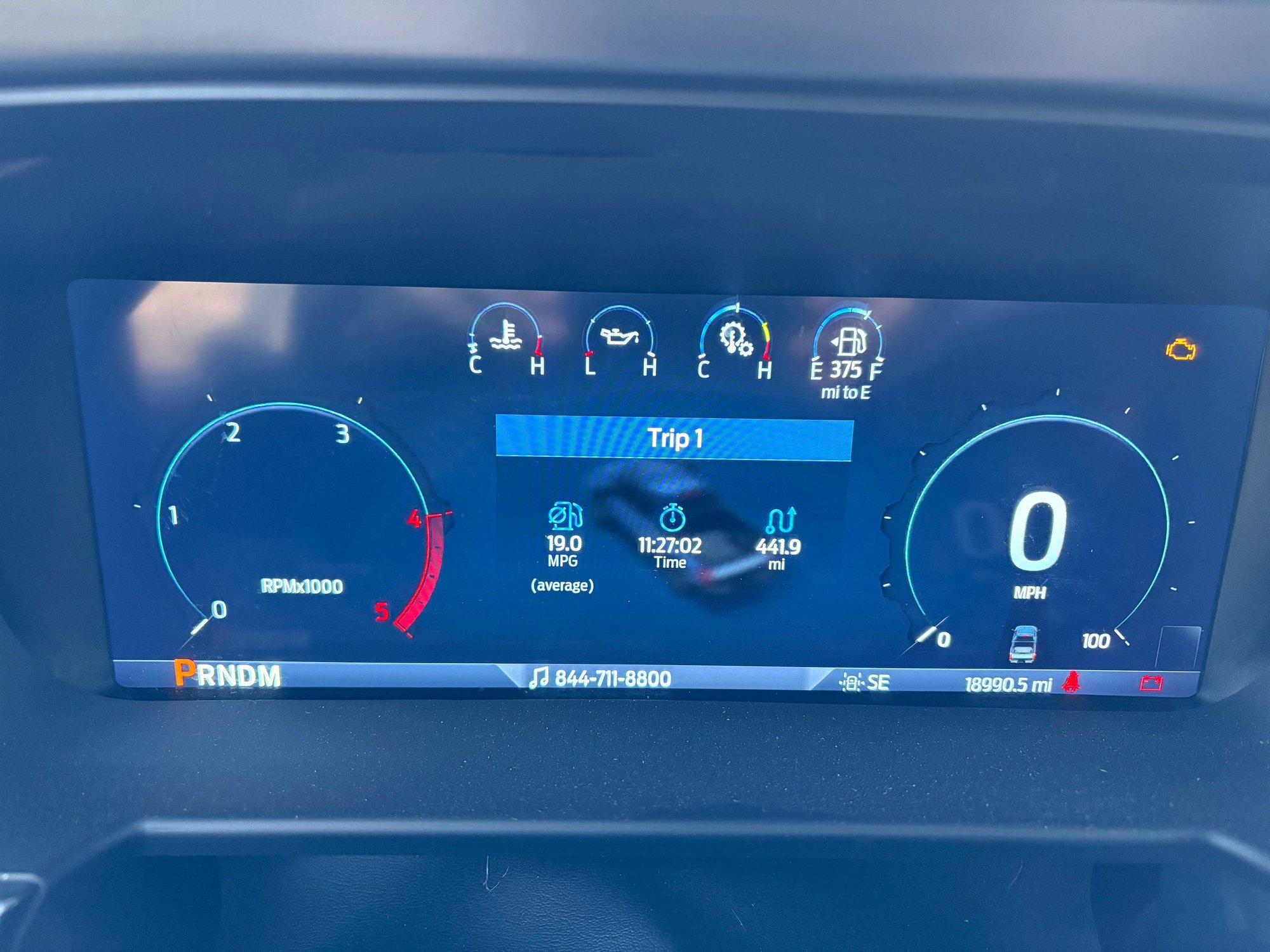

Install complete! took about 40 minutes to install.
Before install DTE
After the install the DTE went from 375 to 656. We'll see what it goes to when I fill up next time.

Raymond,
Thanks. I’m also wondering what the DTE will show on a full tank. I seen a you tube video of someone who had S&B install a proto-type version of the module, but the DTE only went to 914 miles on a full tank of fuel. Based off my truck, a full fill should hit around 1020 miles. I plan on ordering one in the next few weeks, once this “deep freeze weather” get under control here in Michigan.
