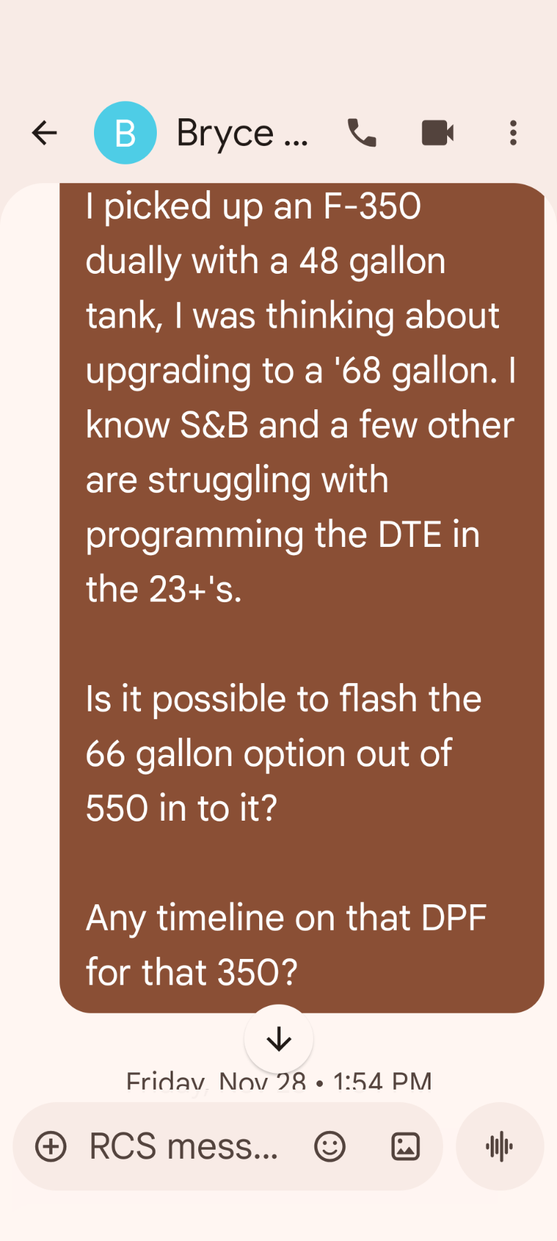

To answer your question, sort of a way.
My dealer says they can reflash my long bed 48 gallon to 66 gallons cuz that is the next factory setting, that would be close enough on a 68 gallon.
With that being said, I've had a 68 gallon in my shopping cart since before Christmas. I'm just not ready to completely depart with $5,000 for my other accessories that I'll do when I have it on the lift.
Saying they can do it versus actual i have not tried.
Absolutely the dealership can reflash your truck and switch between the different fuel tank sizes. Will they is another question. Many of them won't, but you can find some here and there that may. I would think that if you wanted to dish out the money for FDRS I would think you can make these changes on your own. But it's not cheap...
