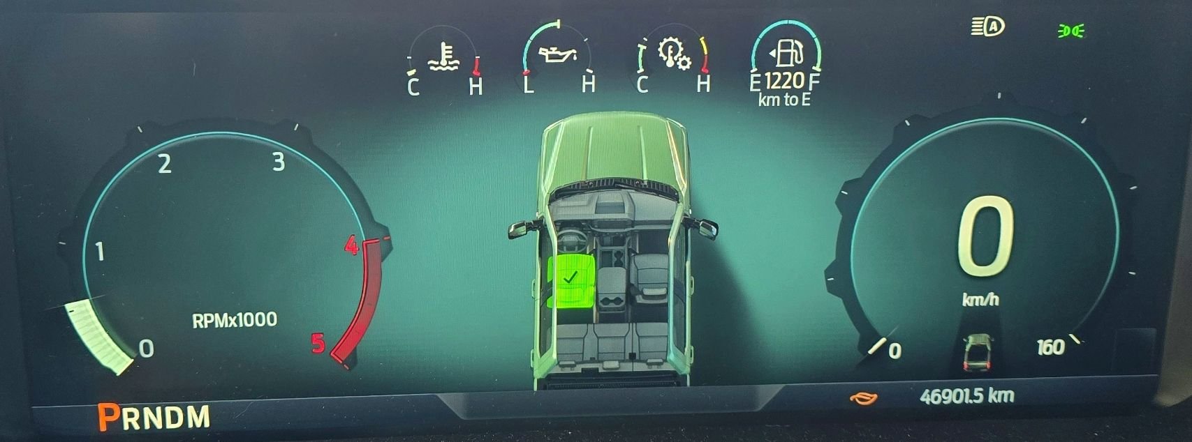

Filled up this morning after installing the gizmo yesterday. It showed 1220km to empty (758 miles). I went for a nice highway cruise, and initially DTE dropped down to under 1150km (715 miles), then slowly crept up again with the decent empty highway mileage. After I parked, it showed 1215km (755mi) to empty, after having driven 75km (47mi). Pretty typical for when I get on the highway after doing a lot of in town driving.

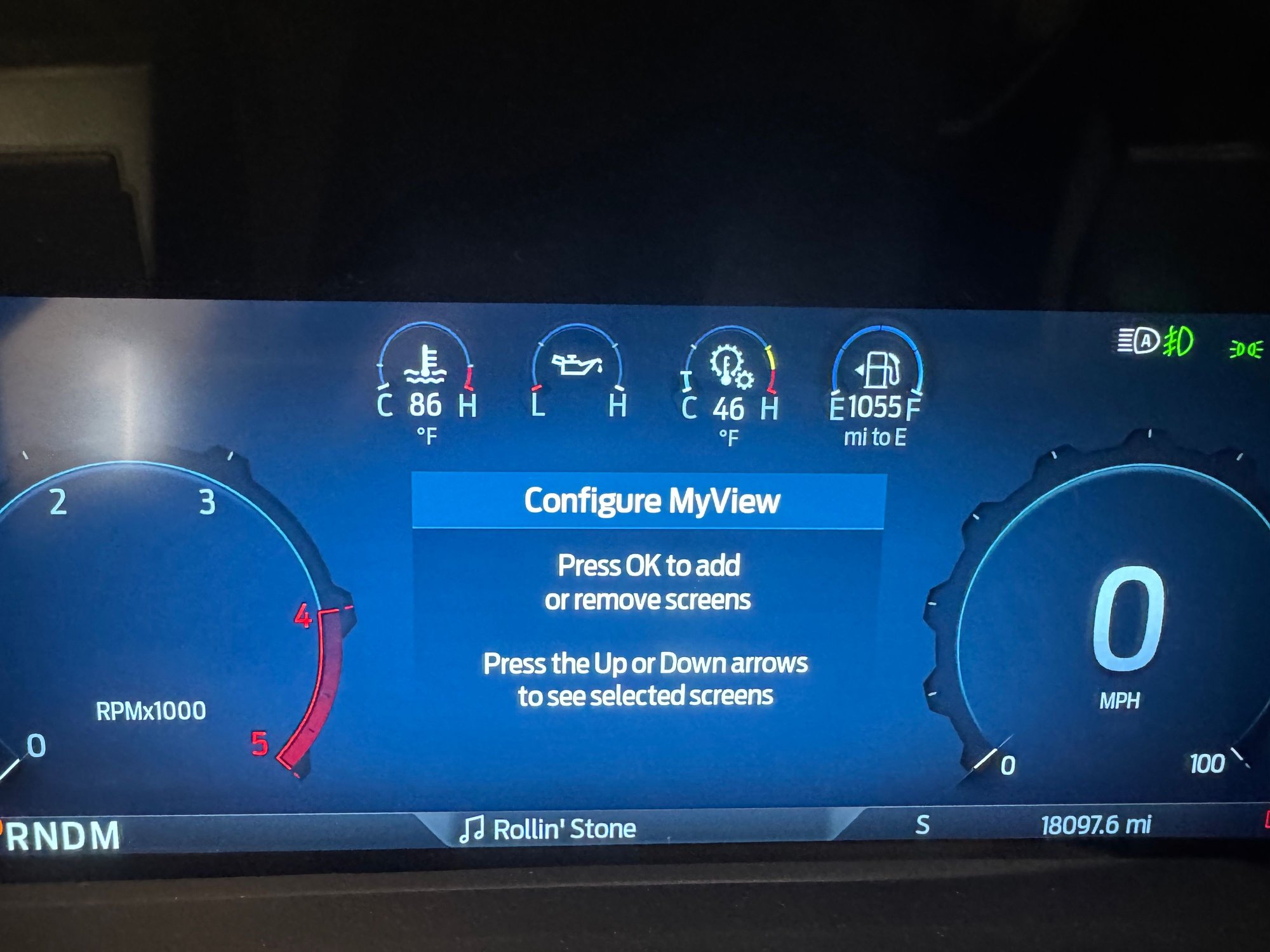

After filling up yesterday

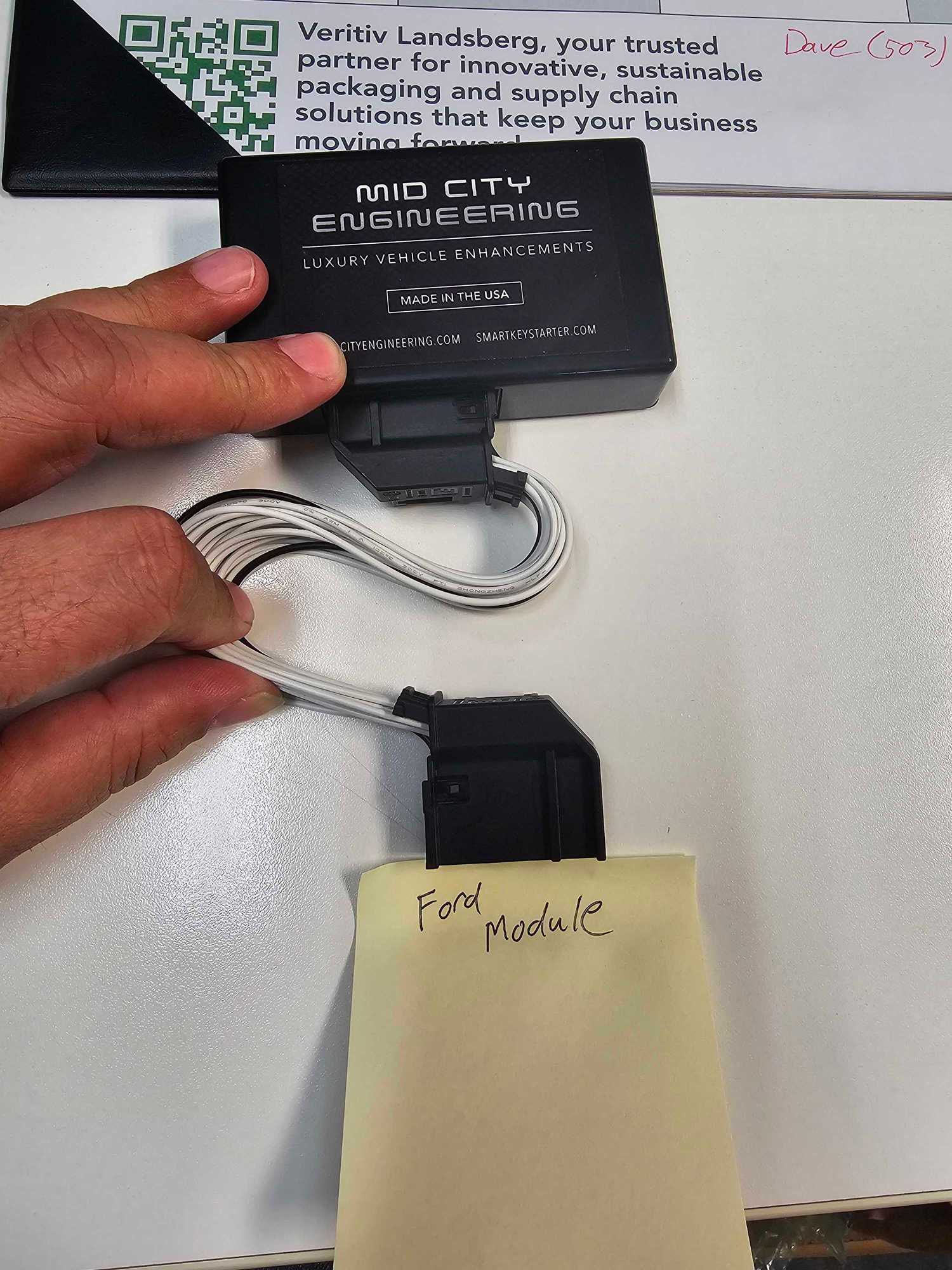

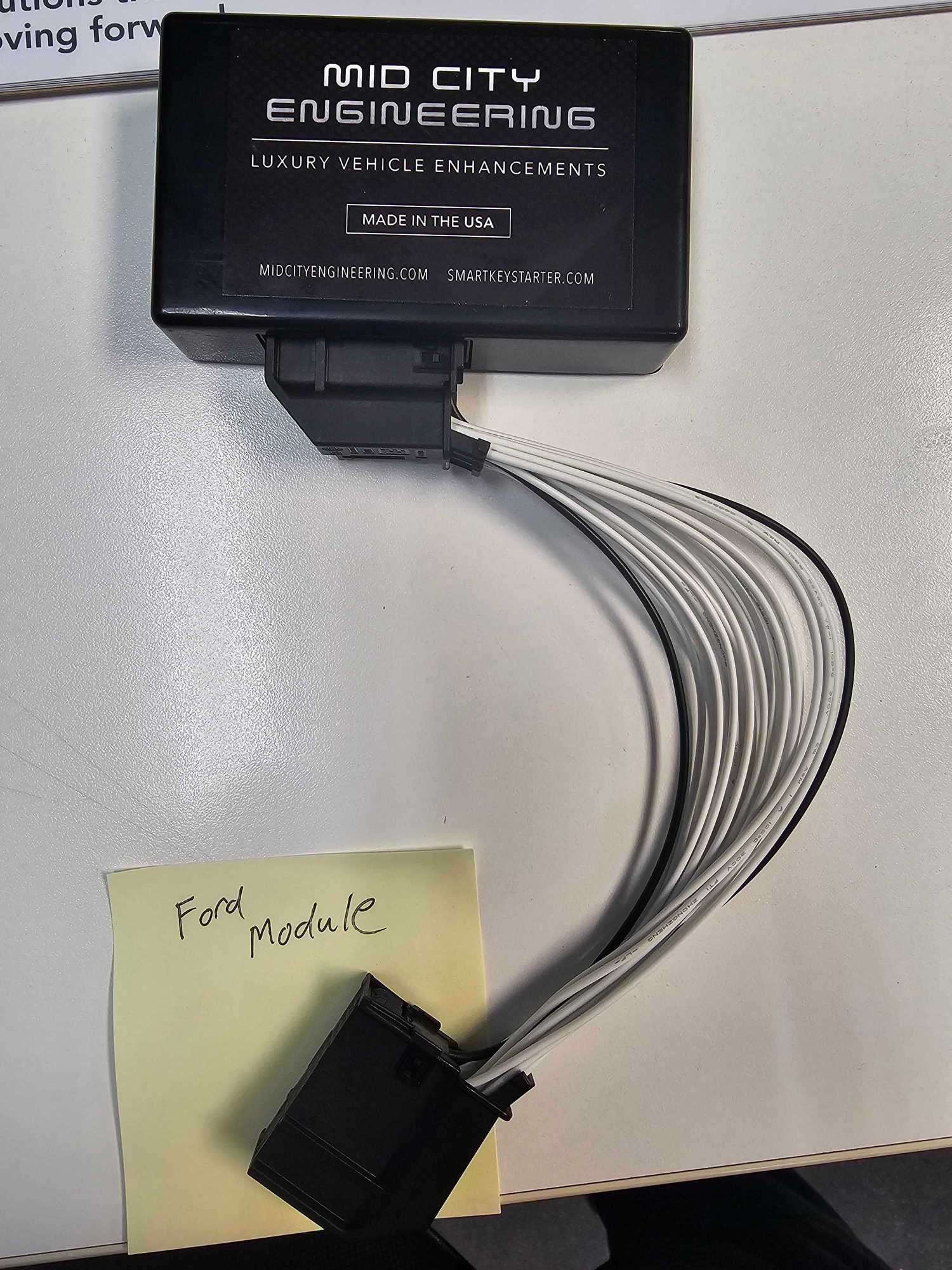

Just in case there was some confusion on how to connect the module . The correct way to connect your module acording
to S&B is to connect the ford module via the s&b jumper to the bottom of the s&b module.
UPDATED VIA S&B TECH 1/27/2026 IS IN THE VIDEOS IN MY LATTER POST , Which is different then what the original S&B tech said

@FDNYL136 I looked at the module they sent and it looks the same on top and bottom. Any idea why it would matter?

module
connections are all the same ,I spoke with S&B and dint really get a definative answer on the connection questions or reverting back to your original fuel tank size if it was changed with forscan.Updated videos from S&B . I have used both sides of the S&B module and it doesnt seem to make a difference .But I will go with the updated install

68 gallon tank, MPG avg. was 17.3 before fill and reset so the calculation seems to be correct.
