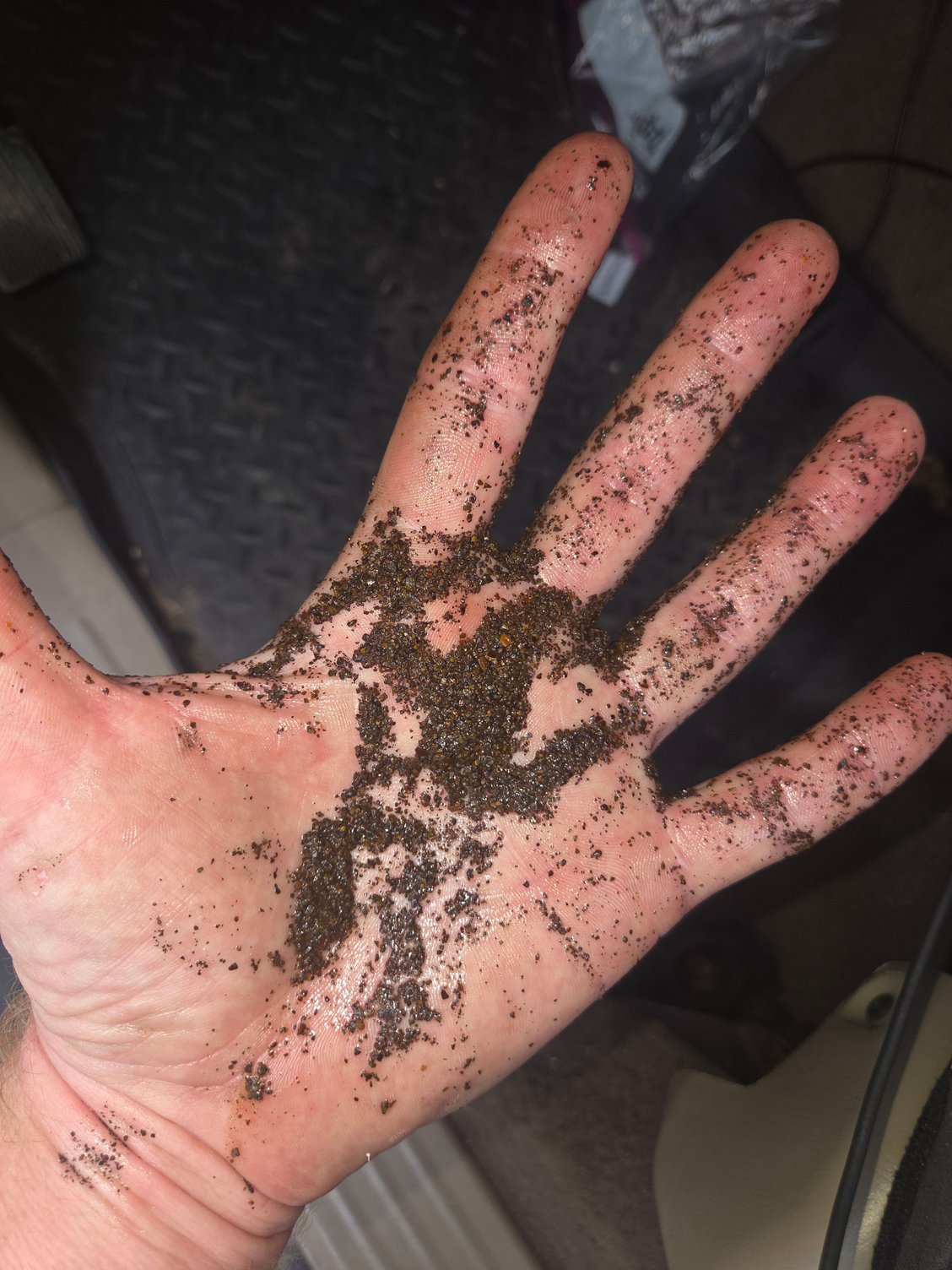

Before I get into cleaning and searching, does this look like a familiar oil leak from a particular place on a ‘97?

Oil cooler O rings. If that's your source make sure to only buy genuine FoMoCo/international seals from dealer or reputable source (no ebay or Amazon counterfeit garbage labeled as genuine OEM), or you will be doing it again.

Be ready for a coolant bath, recommend swapping to Fleetcharge coolant

I got o rings for this to do it myself on the shelf. Coolant flush is a good idea while you're in there. And an oil change

A coolant filter is also good for a neglected system, this is some crapola from Lobo, the '01 Screw.
