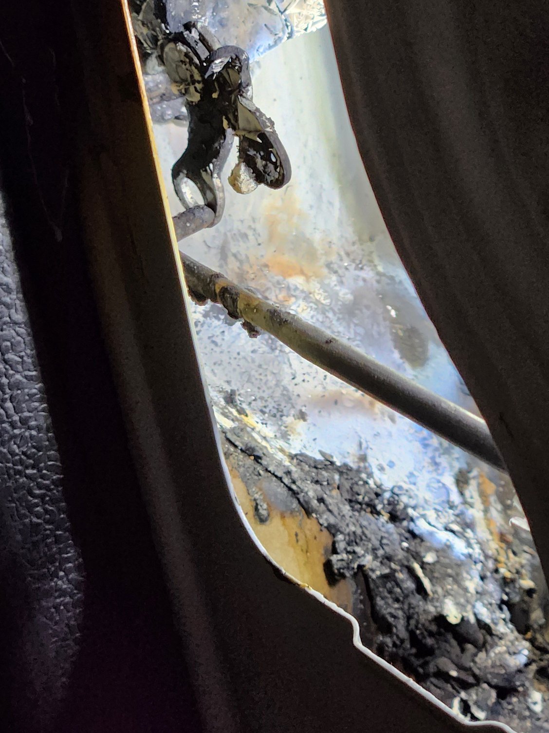

I was driving down the road, and started to smell something burning or real hot! I had been driving 25 miles to my house, the smell started about a half a mile from getting home. It was dark, so didn't see anything until I pulled into garage. When I got out, there was smoke billowing out of the door! I unhooked the batteries, and the smoke went away! Electrical system has not been tampered with, and fuse was still good! I've never heard of such a thing! Now I need a new VSM!

These are pictures of inside the door!

Mine is $500 too! But it was better than nothing. I got a check for $2800. I need to have the door jambs painted, had to buy new door latch, lock actuator, door latch sensor, and new weather stripping. Also found wiring connectors at a wrecking yard. Still looking for an inside door latch cable. The door panel isn't hardly hurt at all, just a little on the rear edge.

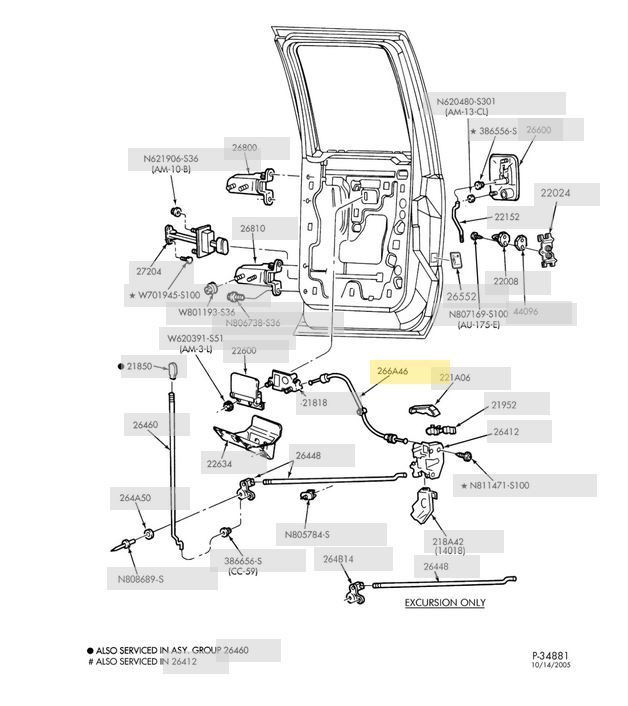

I'm sure you already have it, but this appears to be your part number. Have your dealer do a nationwide search too. YC3Z78266A46AA
