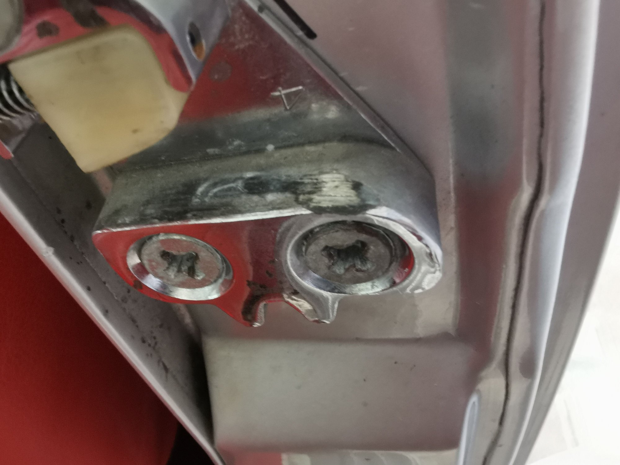

All above is good info. The three striker bolts can up adjusted up, down and left, right. So drop it a bit. Put some white lithium grease on the contact parts.
As John Panelford has said above, I have found that the shiny chrome reproduction striker plates wear out faster than the original striker plates. NOS striker plates can be found cheaply on eBay.

Driver side door:
Passenger side door:
I don't know if it's vesible but the driver side is sticking out little bit, maybe because the passenger side the spring and plastic is missing from the door striker and you really need to slam it hard in order for it to shut close.
