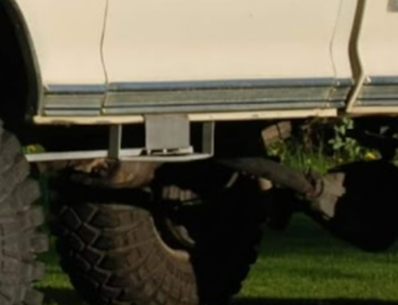

Is anybody able to help with identifying if these steps are custom made or readily available? They are mounted to the underside of the doors. When the door is open they provide a step, which is supported by a bracket under the rocker panel. When the door closes they simply slide under the chassis.

They are OEM and HARD to find, and when they are found, they can be expensive.

They are awesome...but it you really off road your 4wd, you can bend the bracket that attached to the rocker very easy, along with the door bracket. Also when the door is closed and the "step" part is under the truck, if I remember right is not realty supported and can catch on stuff when off roading.

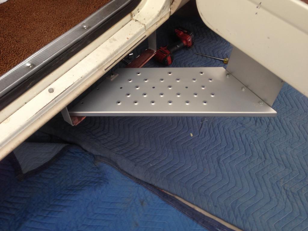

Second attempt to get the picture showing the step on my 77 F-150 Passenger side. Photo might spark some ideas. Fabricator friend of mine made the step, mounted to the frame and used existing holes, wanted to avoid drilling new holes.
