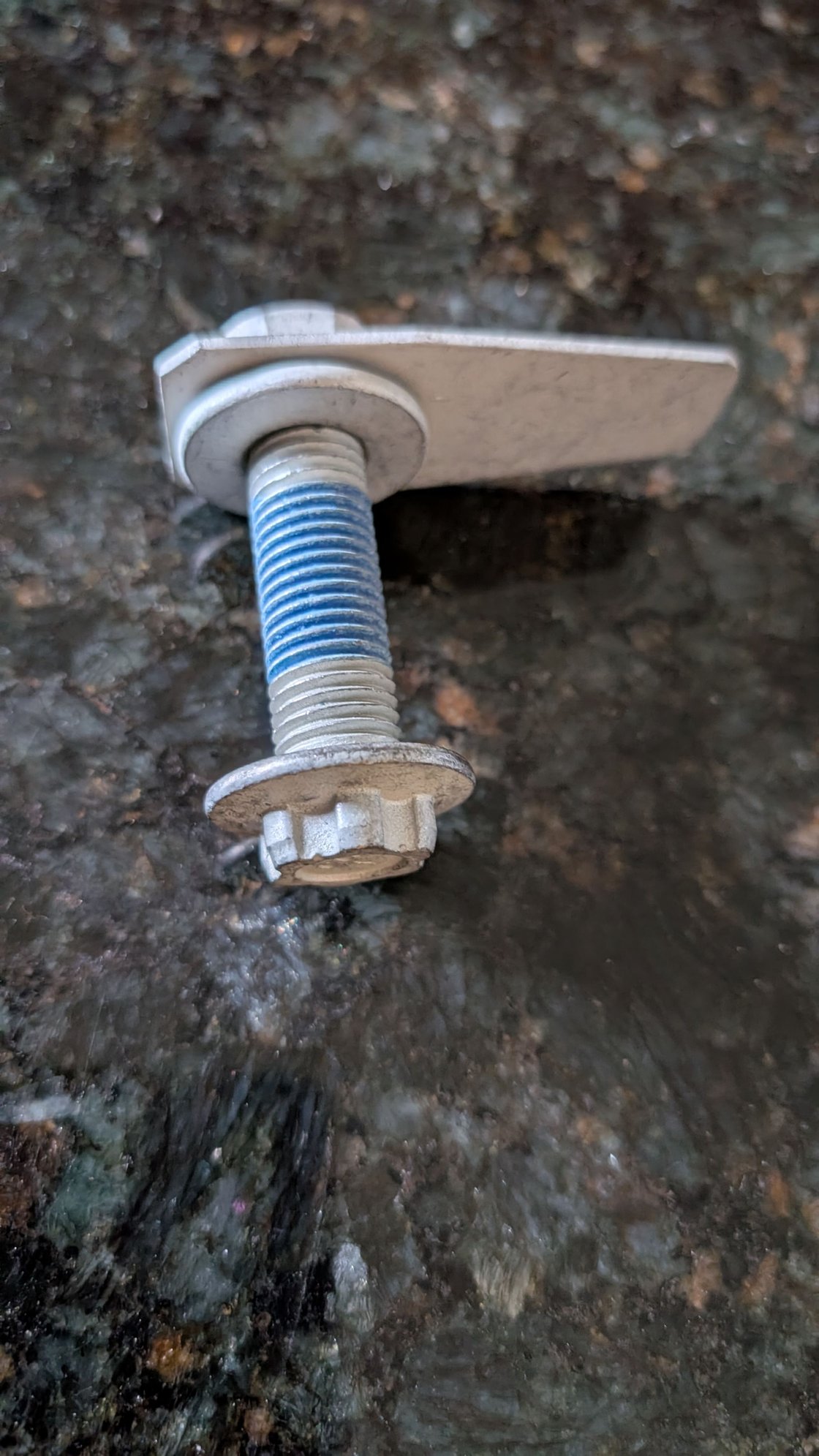

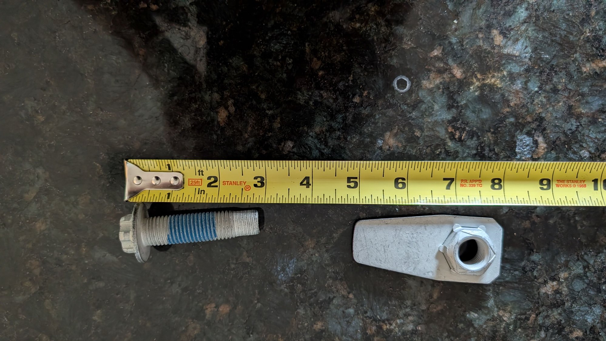

I remember it took some time finding the correct bolt/nut part number myself, at home. scouring the internet.
The bolts are not listed correctly on the parts sights. I think I found the part number looking at a youtube video of an install.
When I looked it up, the description did not sound like the correct bolt, but I purchased it anyway and it arrived exactly as the one I needed, with the Torx head and flag nut.
Old Jan 13, 2026 | 03:12 PM
longhaultransport's Avatar
longhaultransport
Joined: Mar 2008
Posts: 1,031
Likes: 510
This is how I received the bolt/nut. Was probably in a box with other stuff.
Sorry I can't remember more details.
