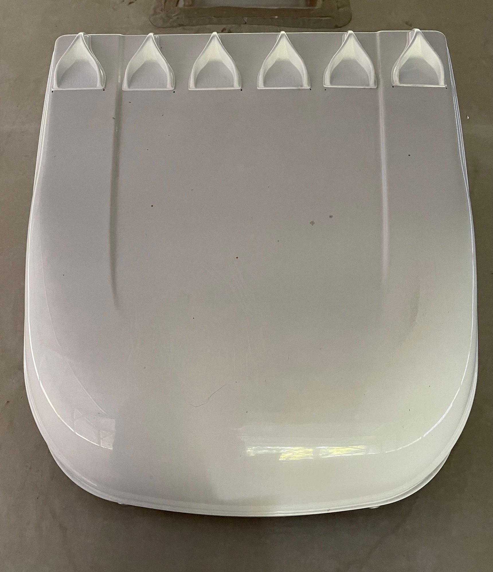

I have put air tabs, which are designed to reduce drag, on the top only of my truck cap. I checked the mpg only once on my 2016 F350 which I originally put them on and noticed a minimal improvement and now have them on the top only of my 2023 F350. Have them on the top only on our camper also, 34’ Jayco 33RBTS. Could be my imagination but it did seem to improve the handling when towing it. The site says to put them along the sides also, which I didn’t want to do on my truck and because no smooth surface on the camper.
I tried these because there does appear to be engineering data behind them.

Air tabs seem like the science is behind them, so I'm interested . . . but I have yet to see someone do a real-world test with numbers recorded, something like this:
Test 1: No alterations, recorded speed, distance, and temperature on a day when air is essentially still, in a loop like the TFLTruck guys do.
Test 2: Air tabs added, recorded speed, distance, and temperature on a day when air is essentially still, in a loop like the TFLTruck guys do.
Test 3: Air tabs removed, recorded speed, distance, and temperature on a day when air is essentially still, in a loop like the TFLTruck guys do.
Test 4: Air tabs added, recorded speed, distance, and temperature on a day when air is essentially still, in a loop like the TFLTruck guys do.
Maybe same four tests as 55, 60, and 65MPH.
Not the kind of test that Joe Average would do. This is more something that someone selling Airtabs or other fuel-economy improvements would do if their stuff works. That's where my suspicion starts to override my optimism. Maybe they are selling at their production capacity so they aren't worried about making more?
And then there's the semi trucks. I occasionally see air tabs on a semi here and there, but it's very rare. In the meantime, the big trucking companies have traversed decades of fuel prices fluctuating up and down, and have added aerodynamic wheel covers, body fairings, other aerodynamic aids on the tractor and trailers, aluminum wheels, ground effects, etc. etc. to gain fuel efficiency, but have never added air tabs in any noticeable numbers. Is this because they don't work? Is this because they'd be hard to implement? Is this because of some other reason? Maybe no trucking companies have heard of them yet? I don't know, but it adds to my suspicion.
Anyways, I'd love to see some real testing of these.
