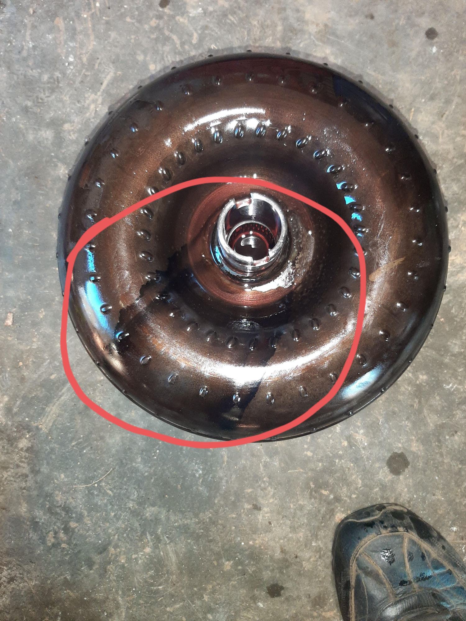

On the subject of servicing the driveline.. Just finnished this one up today... The converter from Ford is on national backorder so I had to go aftermarket.. The guy was off roading in AWD and smoked his converter.. Side note:AWD is for on road. 4x4 high and 4x4 low is for off road.. This is why he smoked his converter and destroyed his pump front bushing.... New pump and converter and its doing fine... I try to do the front axle before 140k like this one... Usually around 60k especially if the customer does a lot of AWD driving.
