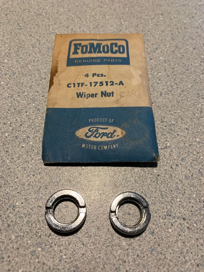

Anybody have the tiny little panel nut to secure my heater switch to the dash? Think it is 7/16"x28. Hardware store nor specially fastener stores have them. Guess I lost it during the restoration of my 63. Thx

I'm pretty sure the heater and wiper switch use the same retaining nut. That's the note I have but that may be wrong.
C1TF-17512-A - NUT - WINDSHIELD WIPER CONTROL - 7/16" - 28 - 2 slots - straight I.D. - also used w/heater controls

Oh yeah. I forget it has that shape. Mcmaster won't have that.
