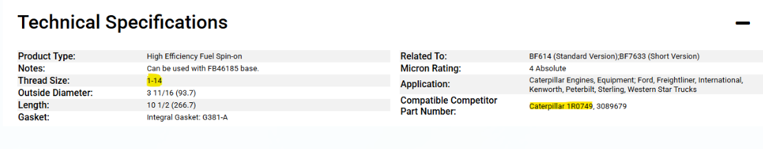

are you sure about the 1-14 internal thread on the spe cat head
Totally, the 256-8743, 1R0749 and 416-1225 are all 1-14 filters...
I am running a BF7587 which is the Baldwin cross reference of the 1R0749 on a FB1311 1-14 filter base on my truck currently.
