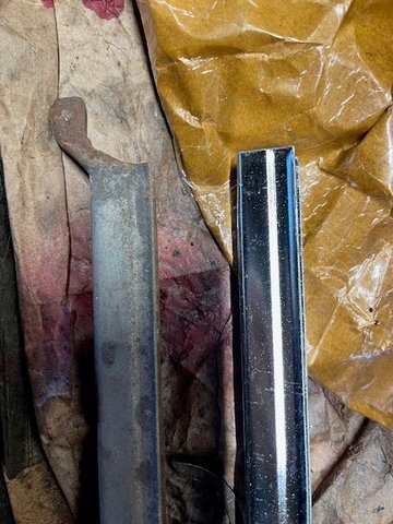

Folks, it appears that the aftermarket window lift channel available from the usual sources is slightly simplified when compared with an original piece. Specifically, the ends do not have the extensions that the originals have.
My question: Does anyone have experience with the new pieces and if so, do they function as well as the originals?
I ask this question before I go to the effort of welding up the end pieces of my old channel to the new channel. If there is no functional difference then I'd rather just leave it alone. However, I am looking forward to nicely functioning windows when I get done with installing all the new rubber and felt liners etc. The only function I can see is that these protrusions keep the window from moving forward or aft in the channel. I don't see them as helping prevent any side to side movement within the channel.
Am I overthinking this???
[img alt="Comparison of the two window lift channels
"]https://cimg1.ibsrv.net/gimg/www.ford-trucks.com-vbulletin/640x480/img_5088_13b3246ac9f32056a3de1ec377203fb9812eef51. jpg[/img]
Close up of subject area showing original piece with the protrusion (on both ends) and the new aftermarket replacement without the protrusions.

It’s been a few years since I did my doors but I’d be inclined to think Ford made them like that for a reason. I’d add the piece to the new one.

Update: well, since no one volunteered any testimonials regarding the new window channel parts I decided to heed the advice given above and modify my new channel to match the original style.
I simply matched my channels L & R to notice a slight variation with the bottom slider bracket between the two. No big deal as I made sure that this would be corrected when I welded the ends on the new piece.

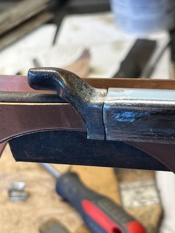

[img alt="I used a piece of copper to align the graft and act as a heat sink for Mig welding.
"]https://cimg8.ibsrv.net/gimg/www.ford-trucks.com-vbulletin/640x480/img_5094_599ad0a3f0c8ebf8f11b0d32bb787a2d5d81c4e8. jpeg[/img]

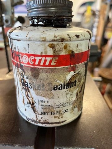

I used Loctite Aviation Gasket Sealer p/n 30516 to coat the inner surfaces of the channel ( this is where rust affects both the bottom and the sides according to my experience) including within the appendages. I feel that this acts similar to POR-15 as far as keeping rust at bay while also aiding in holding the glass in place. I applied an additional coating to the INTERIOR surface of the lining and carefully pushed it in place slightly. It was an easy step to line the glass down and push the assembly together. Hopefully, when the gasket sealer sets my glass should stay put.
I swear by this stuff.  I use it on cork gaskets and such.  I used it on my vent windows too and they are firm within their frame.
link to Locktite datasheet:
https://www.mecampbell.com/media/pdf/LOC1522029.pdf?srsltid=AfmBOorY2c4mePmWpjHrer7IW4W wpb_Nq-jEtm6lbaKfdfG9pEcZYe3y
