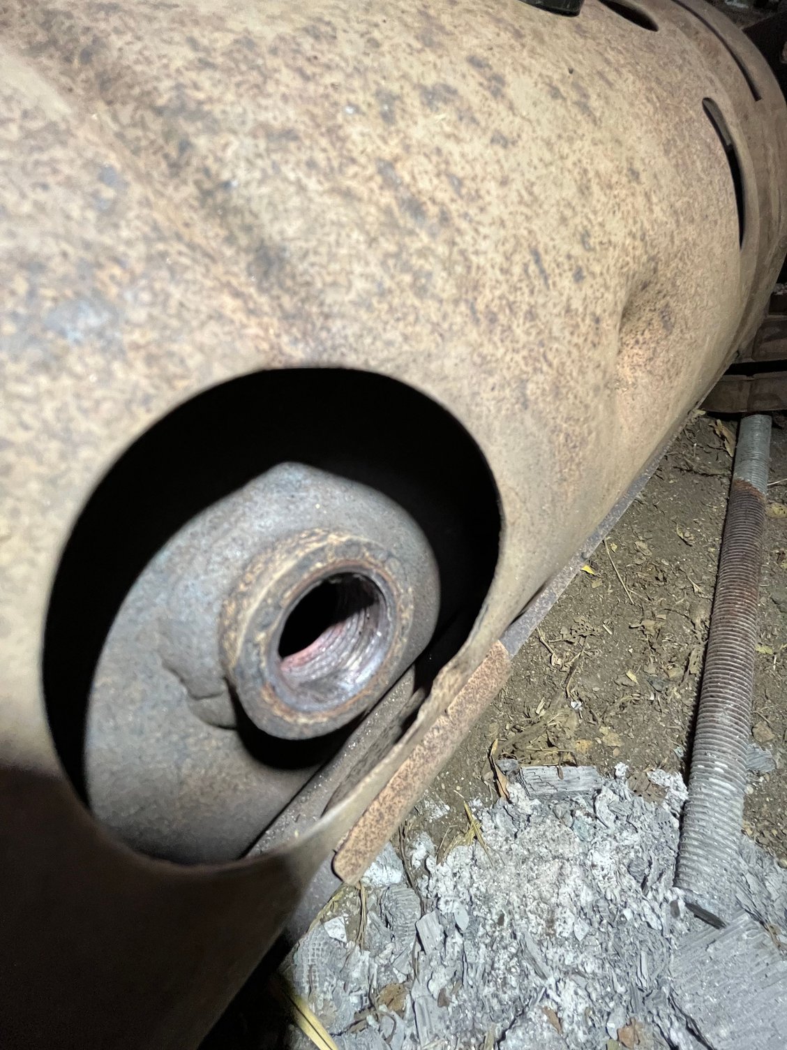

I just got a truck with a bad converter. The ceramic media inside had broken loose and was plugging the outlet. The symptoms were reduced power and codes for limited throttle body actuation and torque production.
the converter was 200 degrees colder on the outlet than the inlet which in conjunction with the codes was a pretty clear indicator of a plugged cat. (The temperature readings alone would condemn it).
I dropped the cat to address the problem and that’s when I saw the ceramic media already falling out of the converter. There were indications that the media had made its way into the muffler, but it was clear of any obstruction so I didn’t replace it.
When I removed the oxygen sensor, it was badly seized. I had soaked it for two days In penetrating oil and I heated the sensor bung for with a propane torch for several minutes. Long enough to get it a dull red. With an offset sensor wrench and an impact gun I was able to get the sensor out, but it pulled the threads on both the sensor and the bung. I was able to save the bung with a thread tap, but the sensor - which worked fine - was destroyed.
I say all of this to 1: give you fair warning that they don’t always like to come loose, and 2: give you a list of tools to consider and a plan of attack to remove the old sensor.
if you need or want to replace the converter, I’d recommend just getting a new sensor and save the hassle of removing the old one. If you aren’t replacing the converter, but need to remove the sensor, be prepared for galled threads on the sensor bung.
Destroyed threads.
Destroyed threads.
Threads after spending 4 minutes going back and forth with a thread tap and an impact.  Restored the threads, but it was touch and go whether it was going to work.
