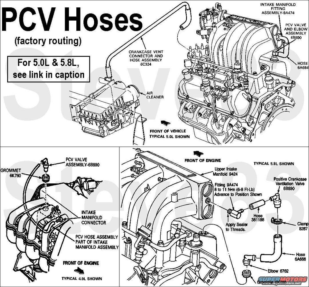

On a factory EFI truck the PCV is mounted on a rubber hose elbow on the passenger side back of the engine. That rubber hose elbow attaches to a plastic elbow that is inserted into the valve cover with a grommet. It's not that tough to get to the PCV, but then you find out the rubber hose is dried up/cracked and the grommet in the valve cover is also dried up and shrunk. So now your simple PCV replacement project gets bigger to replace those aged pieces.
For reference, lower right in this PCV system diagram:

Thanks for the pic. I get why there's so many horror stories now. So far I haven't found any bad hoses on this rig but you know how that goes. I'll plan on it not being a 10 minute job but hope for the best.
I knew the basics of a PCV system but never really studied how the valve works. After some research I think the valve may be stuck or have a weak spring. I'm going to replace it either way.
