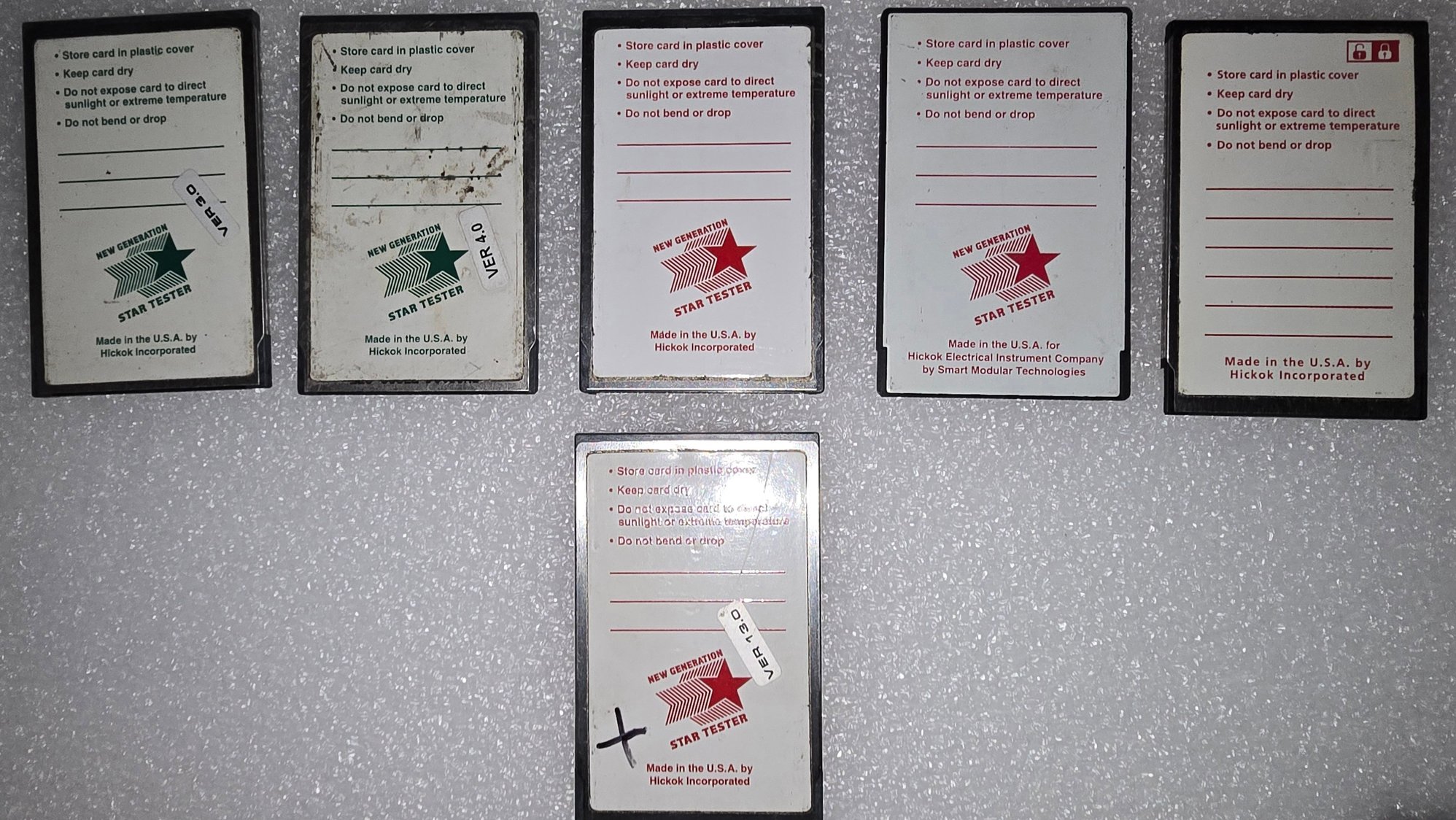

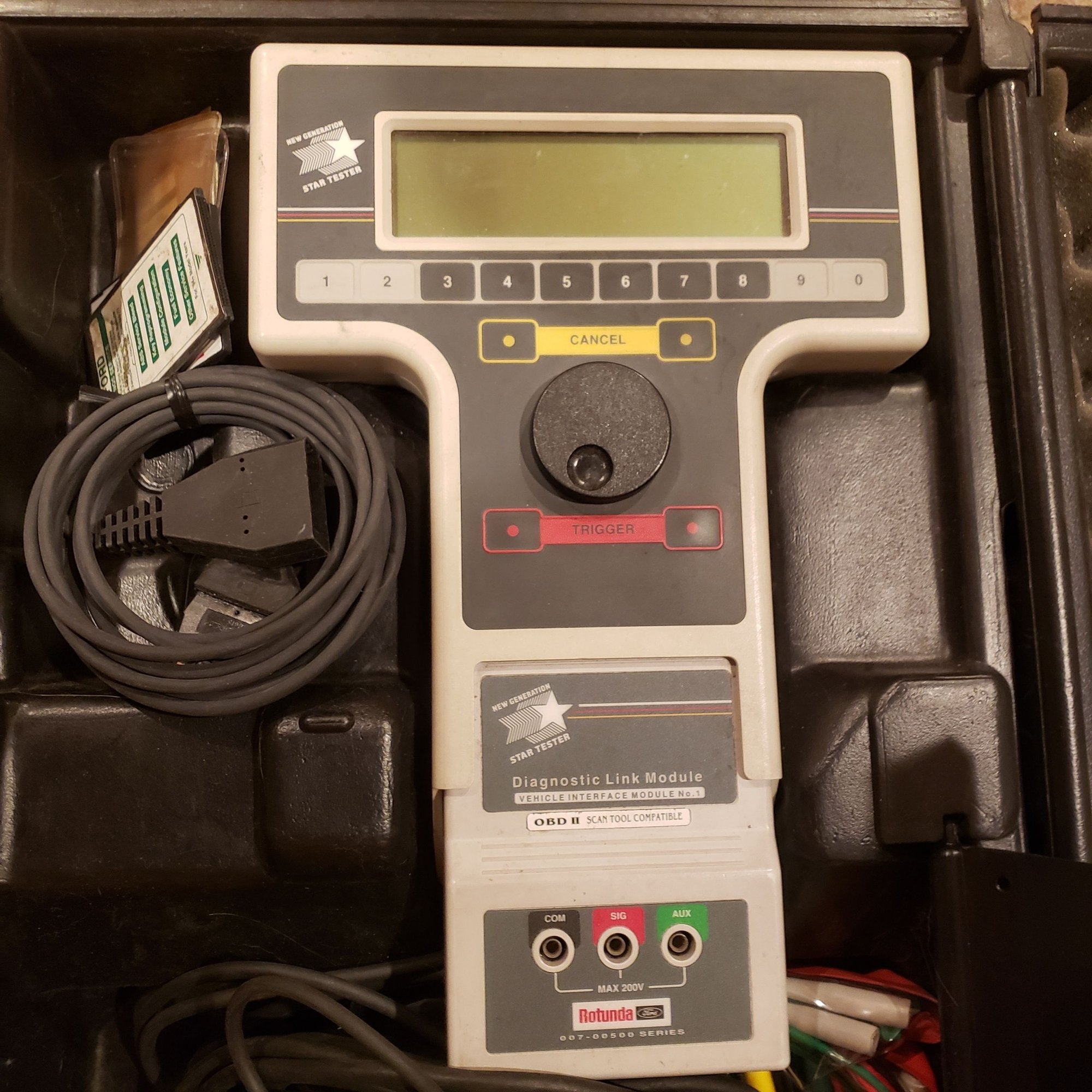

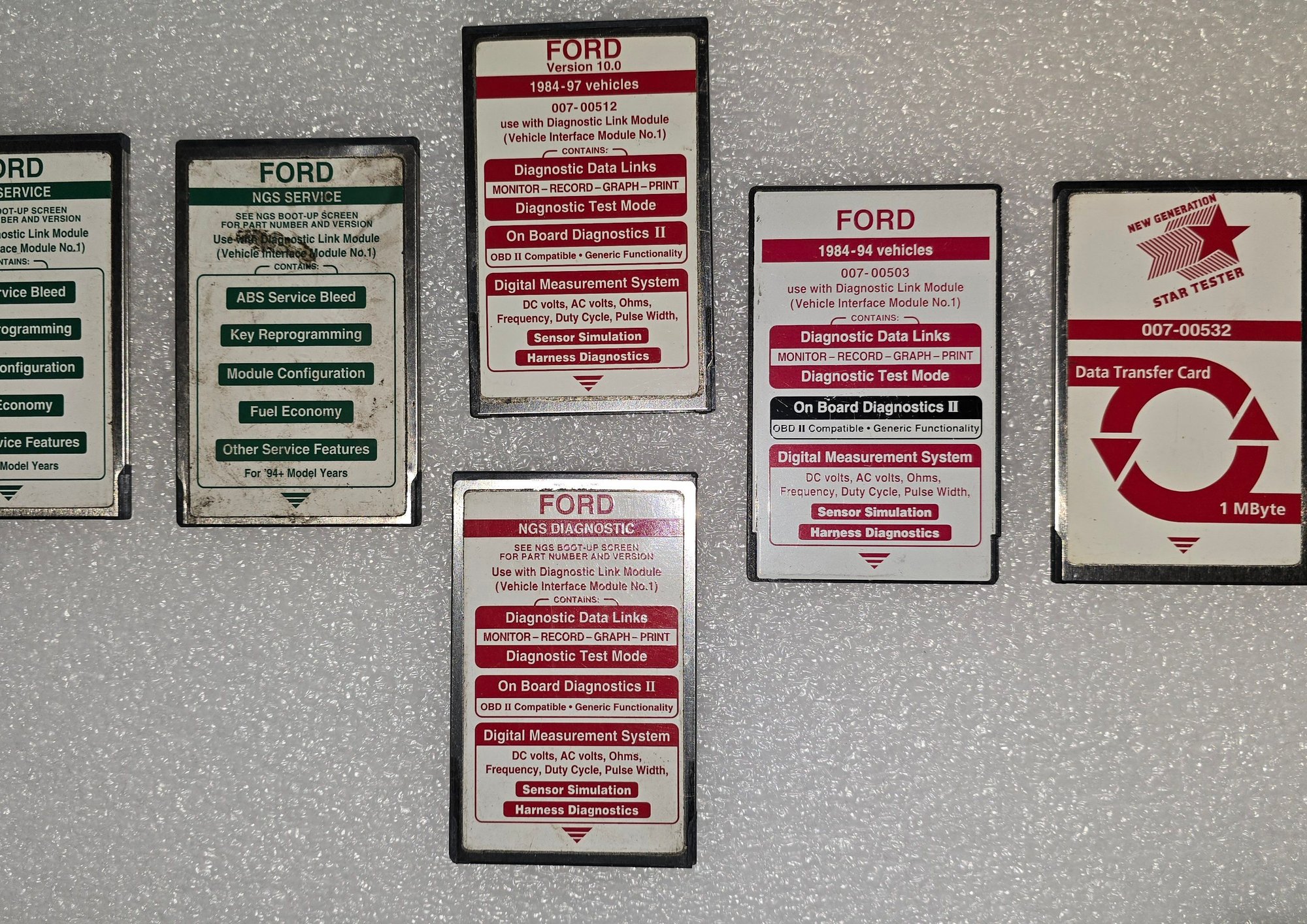

Here is your code reader
It would have been cheaper to just have it rebuilt or replaced at the ford dealer
This is what was used at the dealer in 1998 for your truck

That version 13.0 card with the black sharpie + is an updated card
Like the Hubble, they kept the tool relevant as long as possible
05 was it and I have trouble doing things on 04's with my NGS sometimes
