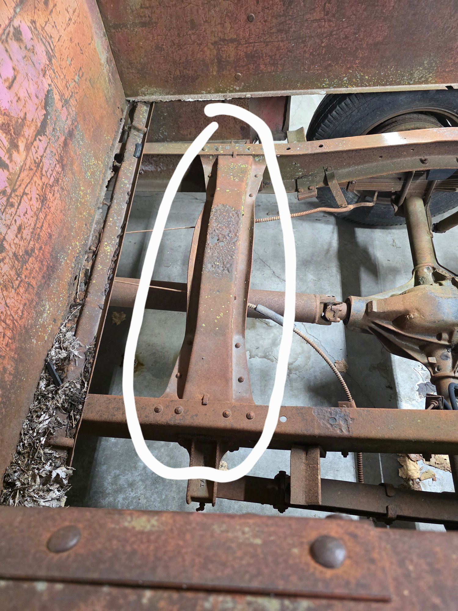

Hello I was hoping somebody could help me identify a part of the frame. This is my first project ever. It's on a 55 f100 between the cab and rear end. I can't find any diagram that has the parts name listed and I want to replace it. Any help is much appreciated thank you

It is a frame cross-member.
Here is a PARTS ILL -

Why do you want to replace it? It looks good from here.

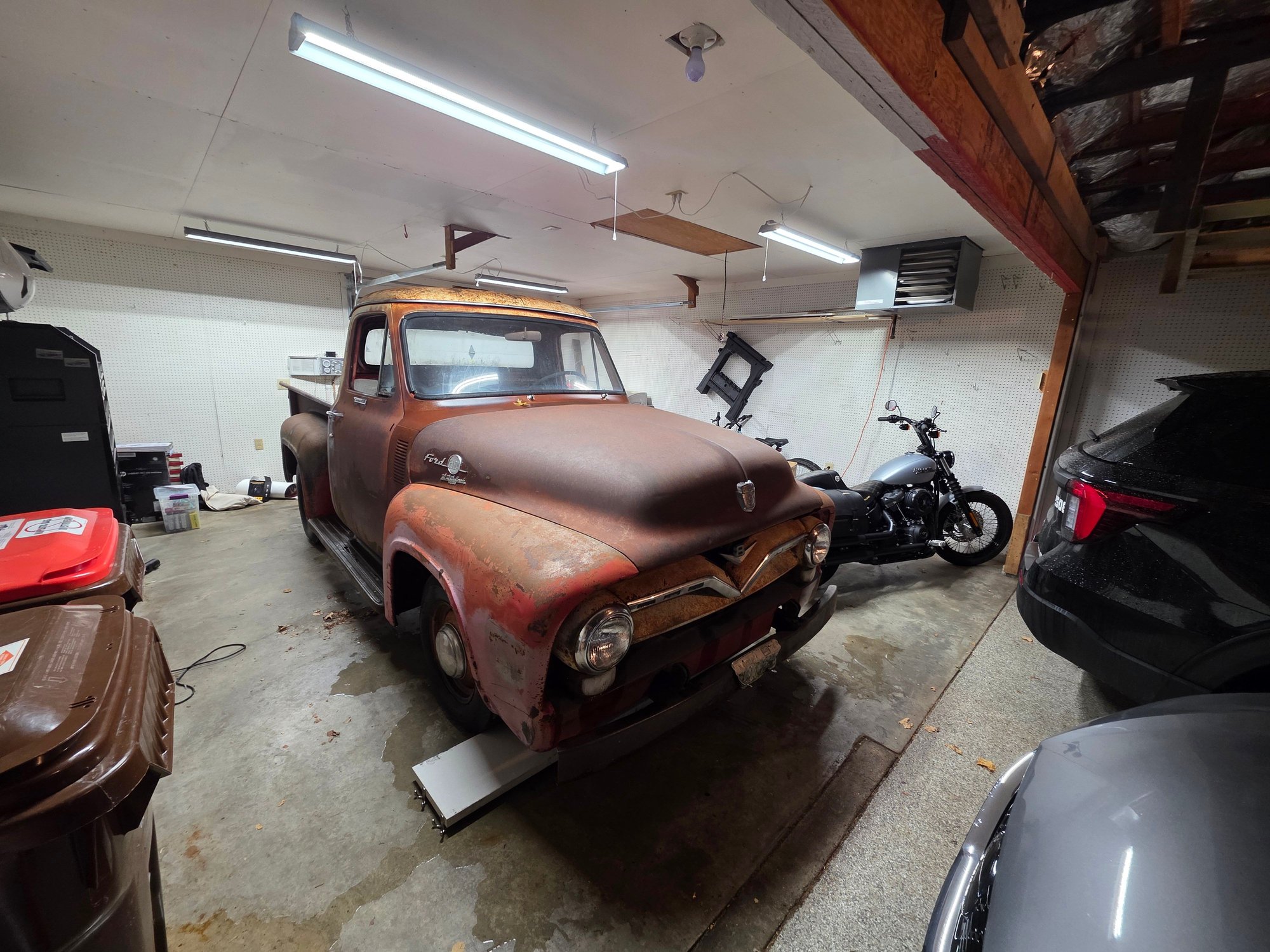

In the meantime show us pictures of your 55.

It appears to have perforations from rust in the center. I think it would be easier to cut the area out and replace with a similar thickness of sheet metal, hunk of scrap frame or crossmember, etc., than to grind out all of those rivets and deal with the spring hangers. The structural integrity is still in the crossmember, it just needs the center fixed. Not a big deal. While you're there, you'll want to fix that spot on the frame rail just behind the crossmember on the left side. That's a far more critical area, imho.

Welcome to the board. I second the motion to "cut out the bad and scab in some new" as opposed to replacing the whole x-member.
It'd be a whole lot easier than cutting and grinding all those rivets and then trying to redo them.

I see the rust holes now.

Thank you everyone for the suggestions. And looking at the process for removing rivets. I have definitely decided to go with patching the rust spots.

I wouldn't even cut any of it out, I'd just weld a piece of 1/8" metal over the top of it, there is still plenty of strength in that cross member..
I like your way of thinking. No one will see it once bed is on.

It took 70 years to get in t hat condition, doubt he'll outlast a patch. I have that cross member I saved from a frame and I'm sure you have several..but like you said it is sight unseen once the floor is in the bed..

I get what you all are saying, however, it's not that much more work to do a proper repair instead of a band aid. It will be fine, either way, (it'll be fine, as is, too) but 2 minutes with a cut off wheel will remove the damaged area, the welding and cutting/trimming of the patch piece is the same work, and when done you can be proud it looks like factory instead of farmer. Just sayin'.
