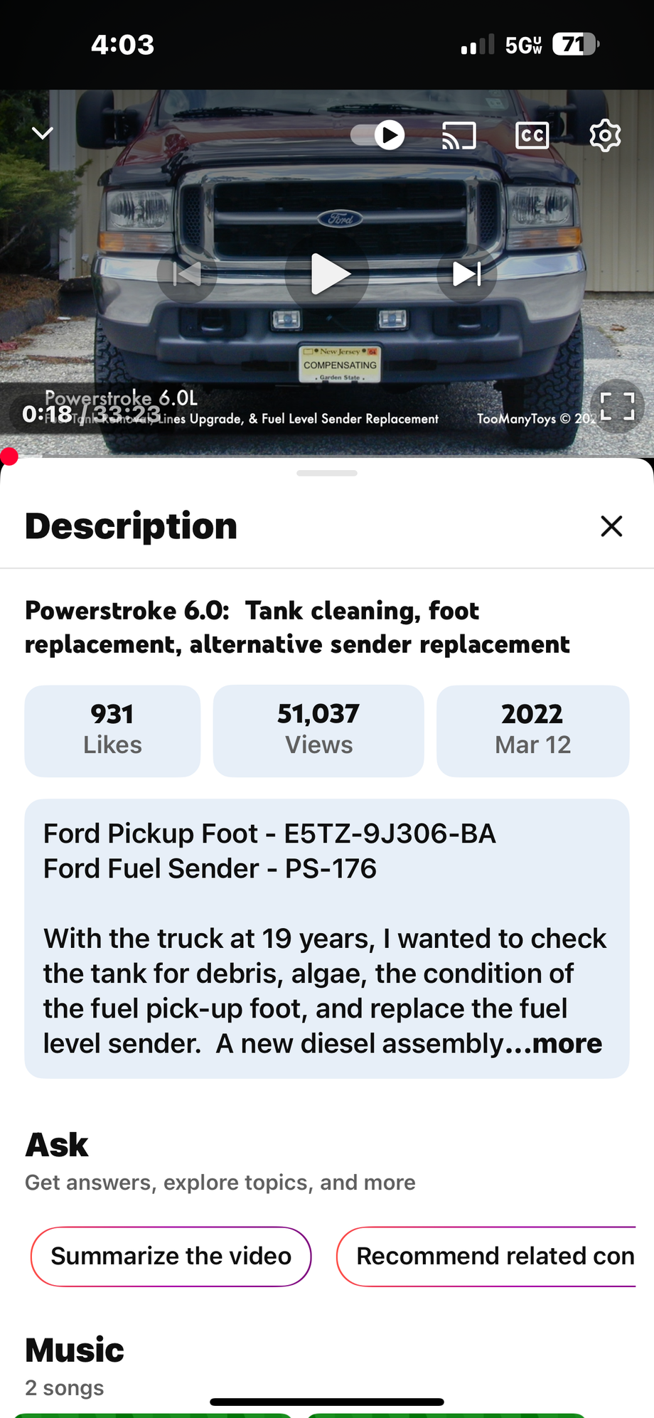

It might not be bad fuel. What we’ve been seeing lately is the plastic pick up foot in the tank deteriorating, breaking into parts and clogging the inlet fuel line. You may want to check the fuel pressure first, or if the secondary fuel filter is filling with fuel. It may take about five seconds, so it ends up being a two-person job unless you want fuel dumping all over the top of your engine.

it might be. You could use a 5 gallon can of diesel and get a 3/8 and 5/16 hose and connect that to the tank side of the HFCM which would get you to where you need to go as well as tell if the tank is the problem. I have a video on YouTube that would show the issue and how to deal with the tank, but for whatever reason on my cellphone out in the farm, I can’t give you a link to it. But it’s under my channel for TooManyToys.

OK, I'm headed to the truck stop this morning to rig up an alternative fuel source to confirm bad HFCM or tank/supply line issues. I couldn't tell from Jack's video whether the supply and return lines are the same size? When I drained the fuel yesterday, I didn't see any debris come out of the tank, so hoping that's not my problem. Hate to say I'd rather it be this $600 fuel pump, but dropping the tank looks like a PITA, and the sending unit isn't much cheaper, if they're even still available (or is it just the foot that's hard to find - it can be replaced separately)?

3/8” supply line; 5/16” return.
Foot replaceable; sensor itself replaceable. It's all in the video.
Possibly not a tank problem, but this is the best backyard test.

Again, in the video, I show a way to power the relay at the inertia switch. Normally the pump runs for about 20 seconds before the PCM times it out if the engine is not running.
