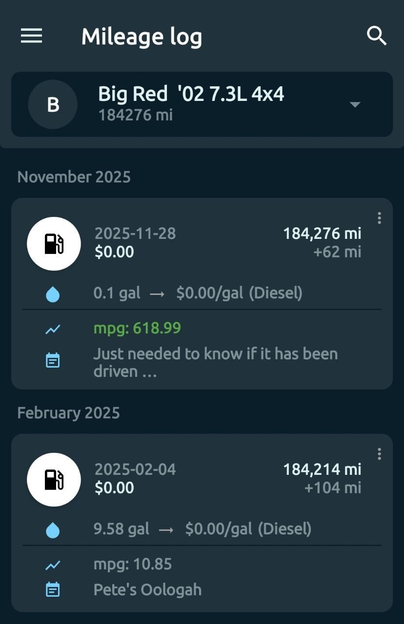

just last night, I got to wondering how much my Excursion has been used this current year.
62 miles

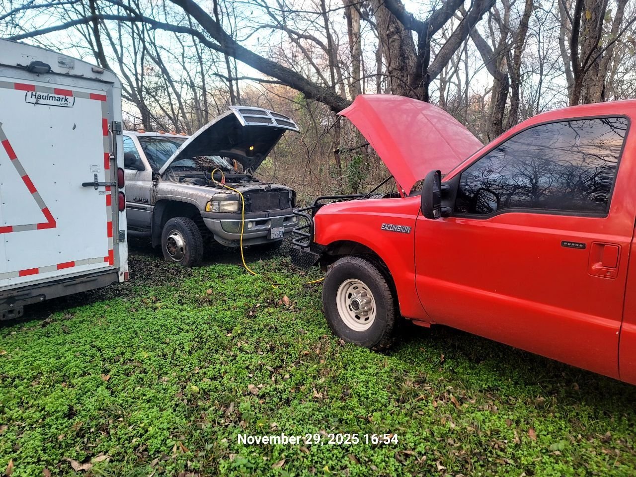

My son scolded me but good on that, told me to start alternating what vehicle I drive to town. So, I got out today, and started the Excursion to Jump start the '99 Cummins, that battery was down to 11.95 and the starter just groaned but the 5.9 didn't start up.
So, after the Dodge had enough juice to whirl the starter, I drove both vehicles around the outside streets of town, to get them warmed up before shutting down for the night, both are on Battery Tenders now. The Excursion always is, the Dodge was out in the pasture in the South 40, no power there...
