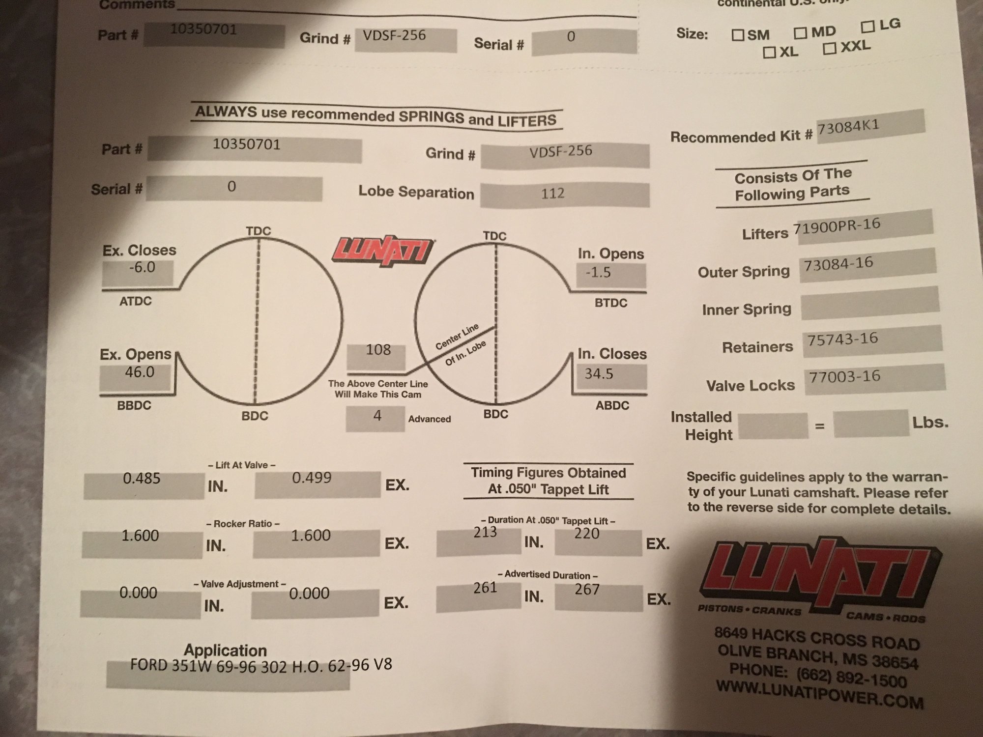

I have a 1984 F250 extended cab 4x4. Factory driveline 351W, NP435 Transmission, NP 208F transfer case, and 3.55 gears, 8,600 lb GVWR. All that to say that I rebuilt my engine and driveline with my elderly dad back in 2018. It stayed as a running but non-driving project until June of 2024 when I got it on the road.
So my issue is I don’t think the engine is where it needs to be. Truck lugs way too much and lacks power and torque than I expect, and is getting 8-9 MPG putting around locally at no more than 50 MPH. My guess is key things not upgraded, most likely heads, and overall tuning can’t be accomplished. Looking for pointers or confirmation on thoughts. Below is the current build.
351W that was factory 2 barrel. Fully rebuilt and had to bore .040 over. Went with Lunati Voodoo tow/RV cam, spec sheet attached. That included new dual coil valve springs. Rest of valve train and heads are factory for 84' (note that heads are from 6,600 GVWR truck if it matters). Heads have 1.78 intake/1.48 exhaust valves, and I suspect 69cc chambers. I do have a lifter and valve train tap, which I suspect is clearance beyond spec. Running MSD 6AL with a factory Duraspark II distributor. Mechanical advance is already allowing too much advance. Base is set for 8° BTDC, lower mechanical arm setting is 16, which gives me 32° of mechanical advance, for a total of about 40°. Changed springs to bring my all in RPM from 3,200 to about 2,500, but stopped when I couldn’t get the total down. My best option to resolve the advance is aftermarket distributor, but all seem to lack vacuum advance, which I seem to really need with a manual transmission that is low geared and downshifting is not always best.
Failed to mention that I am running an Edelbrock Performer intake, and Edelbrock AVS2 Carb, and quality Hedman long tube headers that I had all new 2 1/2 dual exhaust ran with some simple turbo style mufflers for controlled sound.
I know timing needs addressed and I look for pointers. I know I could benefit from adjustable rocker arms as I know my clearances are too great. But does any of that matter if I don’t upgrade heads? I feel like I lack flow and compression ratio for what is already done. Truck is my put around vehicle that I want to focus on its capability to pull and tow. But it is weak for what it should be. Also note that when you drive it fully warmed up and park it for 20 minutes or more, starting is rough like it has boiled all the fuel out of the bowls.
If heads are my best bet, with adjustable rockers, looking for guidance and chamber cc, runner cc, and 1.6 vs 1.7 rockers. And thoughts on distributors with vacuum advance. This seems way underpowered vs my 1979 F100 with a 302 automatic that I had when I was much younger. This heavy duty driveline should make this thing just want to pull, but it lacks the power and falls way back on hills. Would love input, knowledge, and guidance in getting it where it needs to be.
I grew up in teens and early 20’s knowing more than I know today, and my dad helped with this build that was too old and forgot majority of what he knew and is not around to help me work through the issues with the build we started. All help greatly appreciated.

Disconnect the vacuum advance and plug the hose with a screw. Then set the timing at 12 degrees initial with the timing light. I think you will be surprised at the results, and that will give you a direction to go.
On the noisy lifters, as you know the Ford valvetrain is none adjustable. That aftermarket cam has most likely thrown things off. But you can check it to make sure. Not sure you have ever done any other engines, but treat the Ford the same, even though you can't adjust it. Run the engine around to #1 TDC. Pull the valve covers off, make sure you are at #1 TDC and then loosen both rockers on #1 cylinder. Then grab the pushrod and move it up and down till you just get the play out of the pushrod, and then looking at your ratchet, count the number of turns till the rocker bolt stops. You can't adjust it, but you can see where you are at.
If the bolt is tight and you still have play in the pushrod, the pushrods are too short. If you can get a1/2 turn out of the bolt before it gets tight, that is about perfect. 3/4 turn is ok, even 1 turn will work. More than 1 turn you are getting borderline too tight.
You can then do the exhaust on #1, then turn the engine 1/4 turn and do the next cylinder in the firing order, checking the lash on all the cylinders. If you find them a little tight, sometimes you can fudge it and put shims under the pedastel of the rocker to move the rocker arm up a little bit and still be able to tighten it down. And you can get different length pushrods also.

There is no need to replace the distributor as you gain nothing and lose money what you paid for it. I have seen a DSII system in a drag car run in the 11 sec 1/4 and faster on spray.
On the MSD 6AL all you really get is the RPM limiter and a multi spark if that even dose anything.
Do as Franklin said and remove the vacuum hose and plug and bump the timing up.
Now at 12* BTDC you may get some starter kick back when warm or even pinging just bump the timing back a few degrease till it will start and no pining.
What is the idle RPM and the vacuum reading at idle? How did it change after the above change?
What is the RPM & vacuum at that 55 MPH?
I have a F100 with a 300 six that pulls at a lower RPM than a v8 dose, a NP435 trans, 2.75 gear and 235/75/15 tiers I am at 1800 RPM @ 55 MPH.
Your v8 I would think should be up around 2300 - 2500 RPM to make any kind of power and not lug the motor.
I also have over drive and can run as low as 1200 @ 45 MPH in over drive and it will still pull, that is the difference between the 2 motors cant do that with a v8.
On the valve train noise if you did not check where the rockers ride on the valve tips and using the factory push rods you may need to get new pushrods, thinking longer.
The other thing I think of is cam break in. If this was not done right and with the right oil, even now on the oil, the cam may have a flat lobe or 2.
Only way to know a flat cam is to check the lift on each lifter or rocker. If one or two are less the lobe has or is going flat and the motor pulled, gone through and cleaned to remove all the metal then put back together with new bearing.
Opening the oil filter looking for metal flakes will also tell you if something is wrong.
If you do go for a head change I would not waste my time / money on any old cast iron used heads and go right foe ALUM ones.
In my book in the end for the money you end up with a much better head design / flow and it can keep the pinging down too.
What plugs you running and have you pulled them to see if it is running rich or lean?
I have a AFR gauge (air fuel ratio) in my truck and it runs between 14.5:1 to 16:1 yes it is lean but it is mostly at the 15:1 and I avg 15 MPH.
Lastly you say "lacks power" what are you comparing it to?
Dave ----
ps who put the motor together you / dad or a shop? Could the timing chain been installed 1 tooth off?
How many miles on the rebuild? When did the tap begin? Immediately on the first startup? That would imply an adjustment out of spec during assembly. Or did the noise begin after some miles? That is likely something failing, such as a collapsed lifter or worse.
This is far from my first engine, but may have gotten some “good enough” teaching and guidance growing up over the years doing them. I will say my 302/C4 combo in my 79 F100 just seemed so much hotter than this. Both were smog engines, but I am sure the 84 was toned down even more.
I was running 12° timing but did not see more power or pickup, and was only compounding total timing issue, as that had me at 44° at about 2,800 RPM. Even back at 8°, I can’t run down the interstate as it is pinging with the lightest load, because I am running 2,000-2,500 RPM. Crappy gas these days don’t help, but premium gas is not going to help it run with that timing.
I had not done the checking of how tight the rocker arms are, that is a good tip and something I can check.
Dave ----
The only reason to replace the distributor would be to get a more adjustable mechanical advance. You can’t find the smaller arms for the DS II to get the advance within range.
Cam break-in should have been good, and was running ZDDP additive and continue to do so. Engine was built by me and my dad, but I have considered pulling the cover to check. I seem to remember it having 2 sets of marks, one of those being for a 2° advancement. Would like to verify that didn’t occurred. I believe it is a Melling double roller chain setup that we went with.
I am running factory pushrods. Vacuum is right at 19 at idle. Was running about 750 RPM for idle, but last tuning I couldn’t get it down below about 850. I don’t suspect a vacuum leak so need to explore that further.
