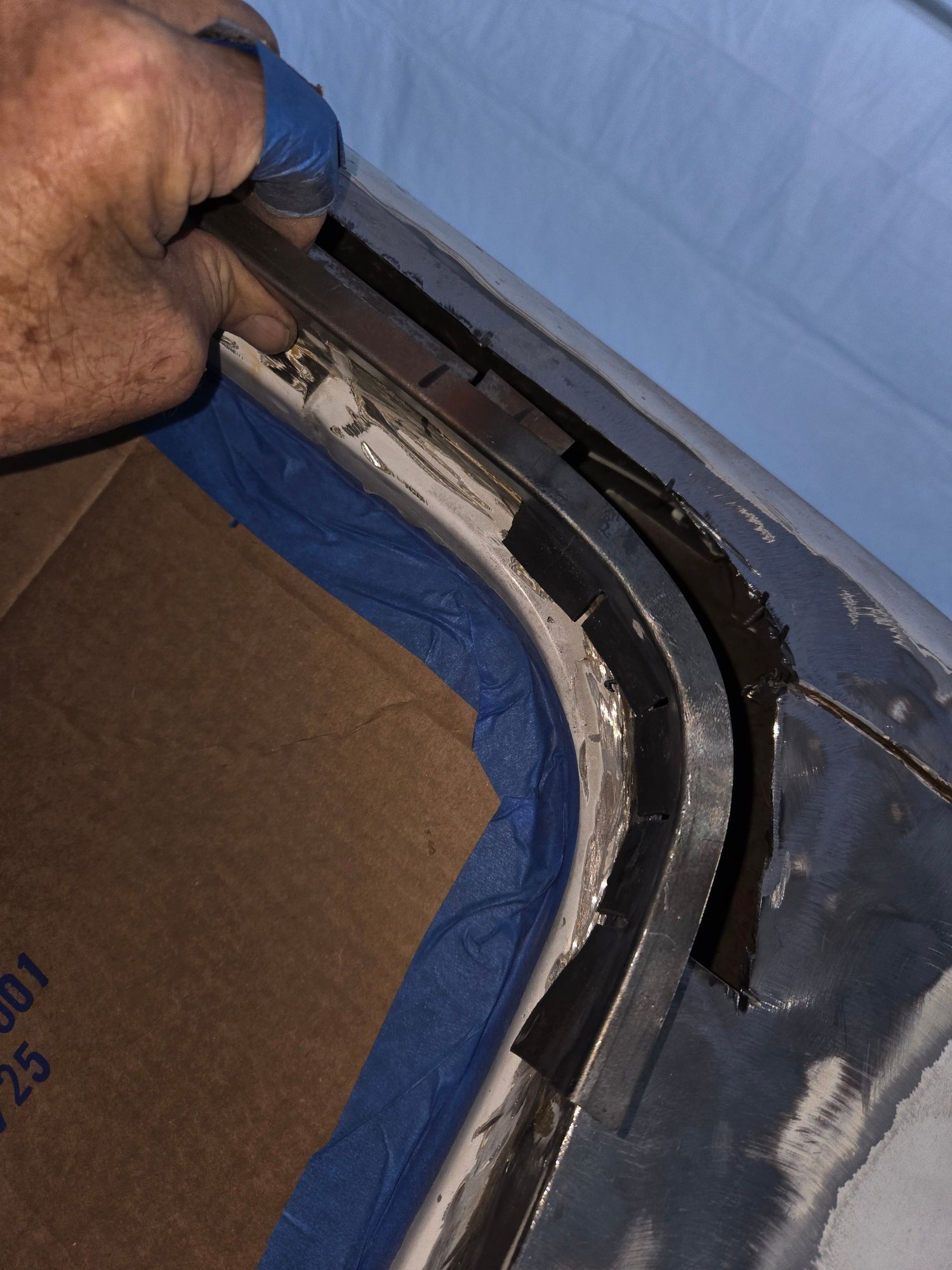

This is interesting. The drip rail is UNDER the body skin/metal of the roof, so if you need to cut out the part of the d.r. that extends up under the skin, it is sitting there in mid air without backing. I saw this vid:
but in this he only cuts off the part of the dp that shows. That leaves the part that extends up under the skin to weld to. But when that is rusty, you're in a pickle.
I spent all day yesterday trying to fab the 90* bend in the dr. The bend is not difficult with a torch, but there is also a twist to it that is a ... bear. Also, right where the bend begins, the dr part that on the top extends up under the skin, here it is visible inside the door jamb. That means that the dr needs to be flattened out so that can work. Flattened, twisted, bent and hanging in air...boy this is fun.

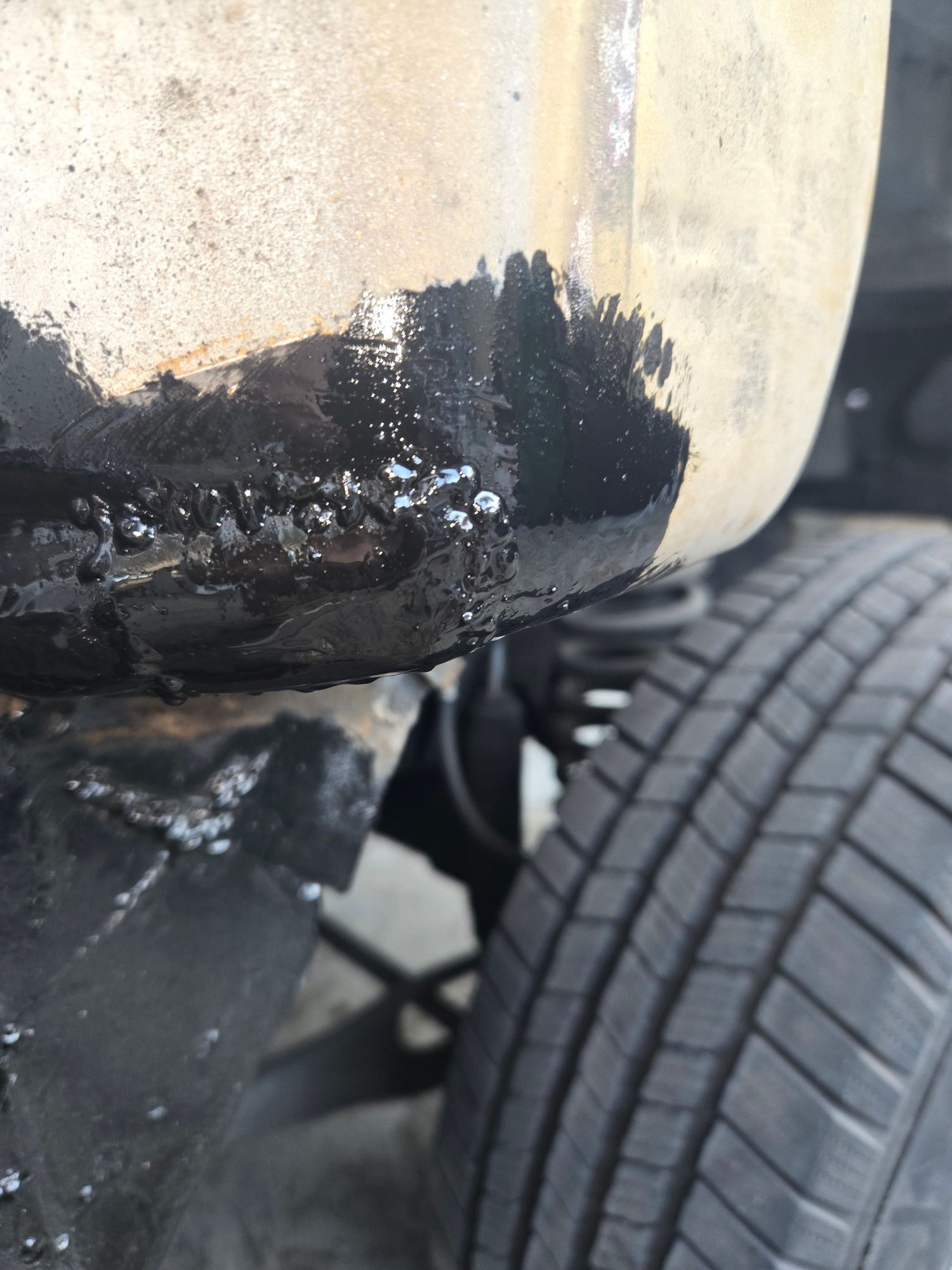

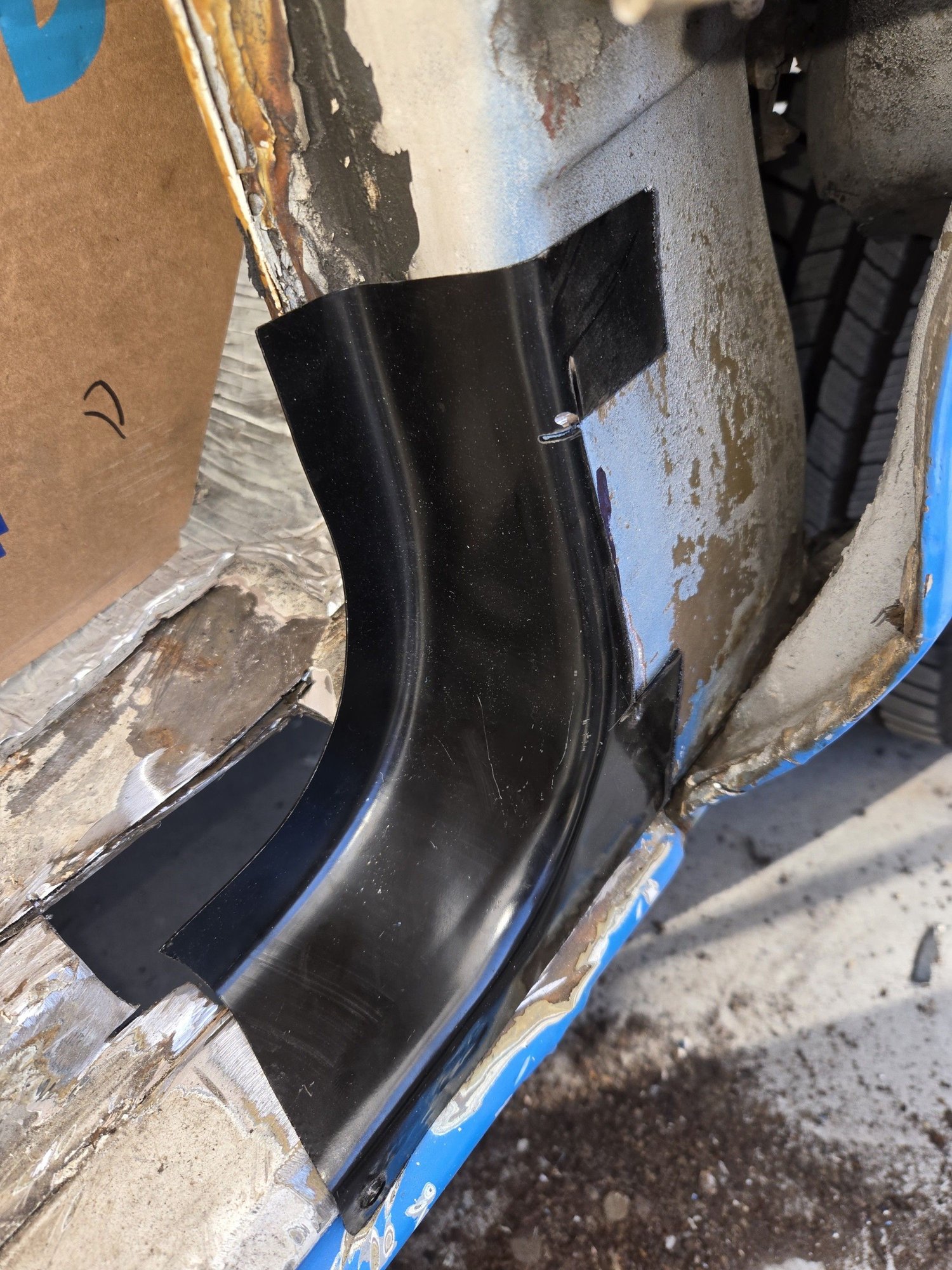

So I found that the passenger side door bottom has some good rust. It appears that the between the front right tire and the door there is zero obstruction, so guess where the water goes. Anyway, is there a patch kit for door bottoms? or am I alone in the forrest?
I also found the the back mount for the right fender is gone. The fender moves freely in and out. I also ordered the rear door post for the drivers side jamb.
I have to say that it was a pain replacing the gutter. Not really hard, but just fit, trim, try, mark, trim and try again, all day. BTW, it is 18 gauge sheet metal you need. The patch panels from LMC were .045, and 16 gauge is .050 or .060, depending on where I found it. I found that 18 gauge was about the same as the LMC panels, and it welded nicely.

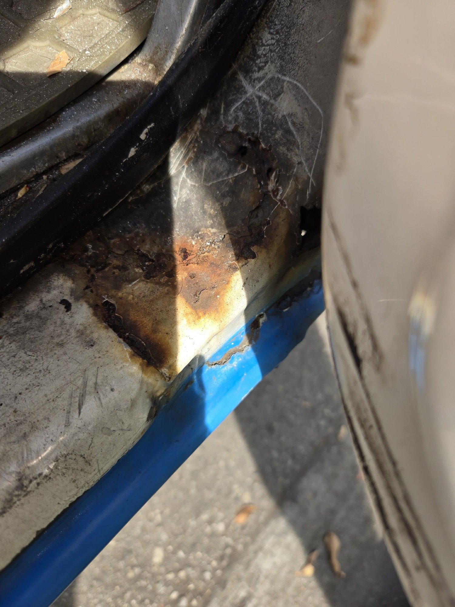

Well, I got a surprise when I removed my door panel.
And then I found some major rust at base of door post.

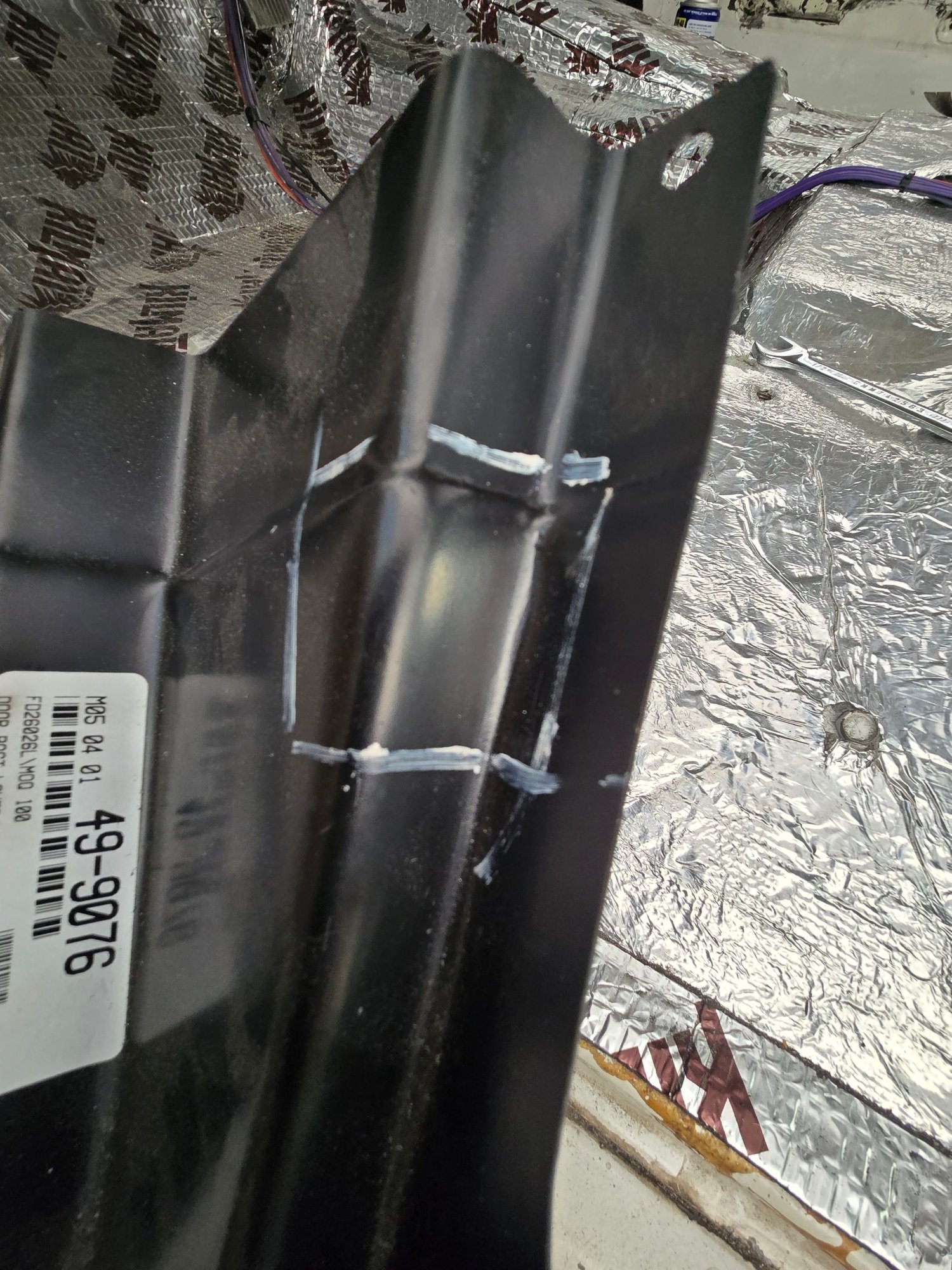

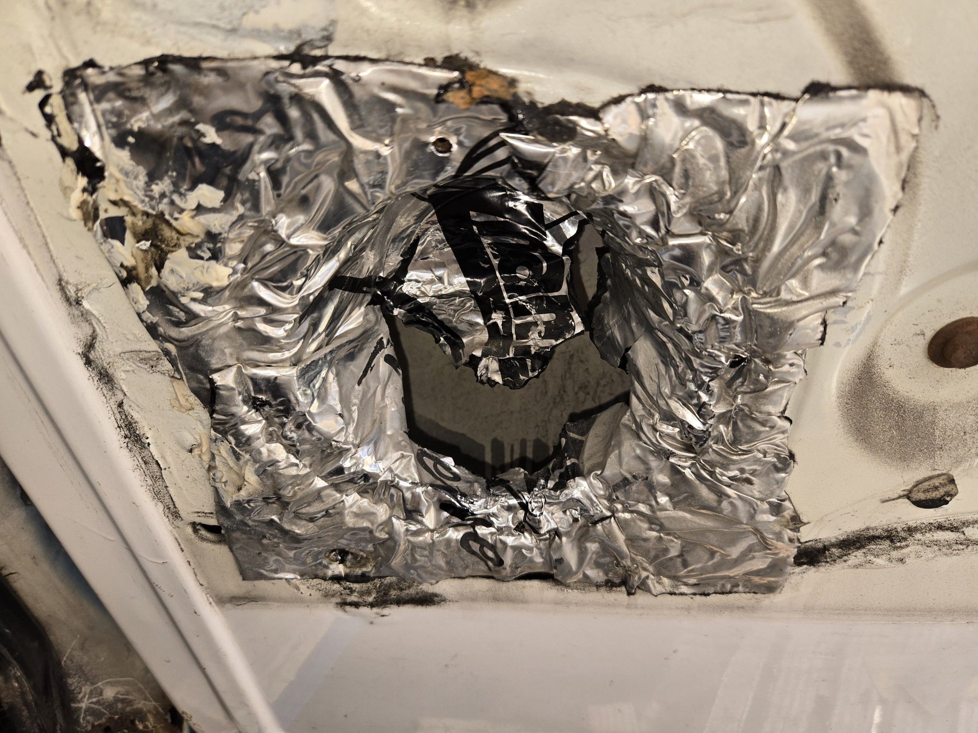

Years back I took the lazy route and added a layer of sheet metal over the floor. Now I find that the rust simply continued to spread b/c I did not cut it out to clean metal. That is what I am doing now. From what I can see, all this originated from water being thrown up from the passenger tire and the rubber inner seal between fender and inner structure was torn and missing a section. Man, it rusted out the floor panel, the bottom of the hinge post, was spreading to the bottom of the door.
After I removed the sheet on the floor that I had installed years back, you can see in one of the photos that there is an oem gap between the floor panels. Is that normal?
I thought that cutting out the oem floor panels was going to be easy. Holy smoke, it was tough going. These trucks are tough.
At some point, like on the inside of the hinge post, I will have to clean it with a wire wheel and coat with Por-15. It may be pitted a bit, but I have to stop somewhere.

Well, my simple paint prep thread got a lot more complicated when I started chasing rust. I replaced the passenger floor pan, the lower passenger door post, which meant having to make several pieces of metal that no one sells. I also removed the passenger door and cut out a section of rust and replaced it. That entire area of the lower right door post was ground zero for the rust. It spread out from there across the floor, part of the rocker panel, the fender mounting bracket, and even the door bottom where it met the rocker panel. I even had to cut open the door post beside the hinge so I could remove the hinge backing plate, heat it so I could remove a broken bolt, then wire brushed all of the rust off, and coated with Por-15. I think all the rust in that area got started because the oe fender gasket that keeps water being thrown off the tire from getting past the wheel well, was torn and missing a section. This has shown me how valuable those skirts or gaskets are!
Now I have found a small hole at the lower door post on the driver's side. I should cut, remove, and weld in a new metal piece today. And then? Yep, it is back to the tear down, sand, prime and general paint prep work. Hopefully, my work will keep the rust at bay for another 20 years!

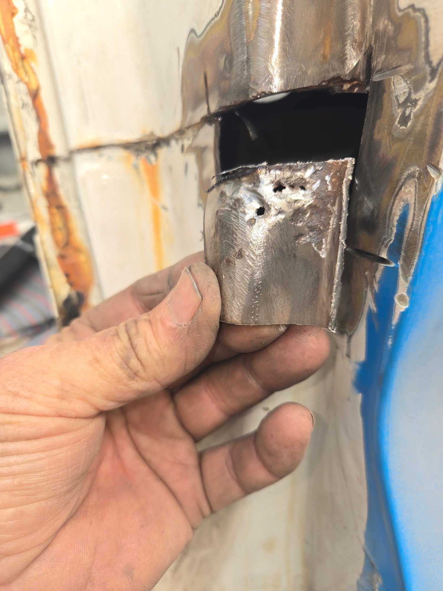

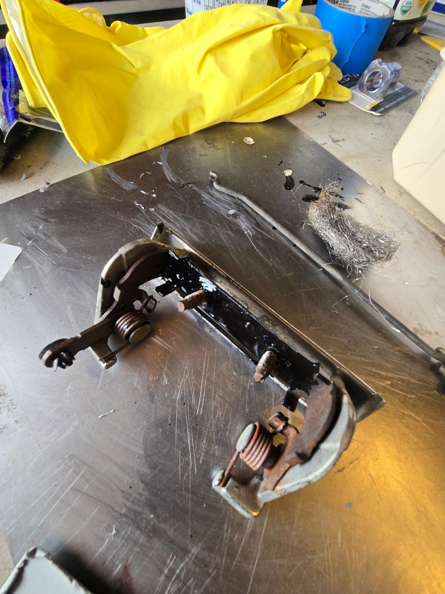

I remounted the passenger door and removed some dents from the outside, then took off the door handle and lock. the handle, where the two bolts are, was very rusty so I cleaned it and coated with P-15. Then I went to driver's side and cut out another spot of rust, welded in a new piece replacement.

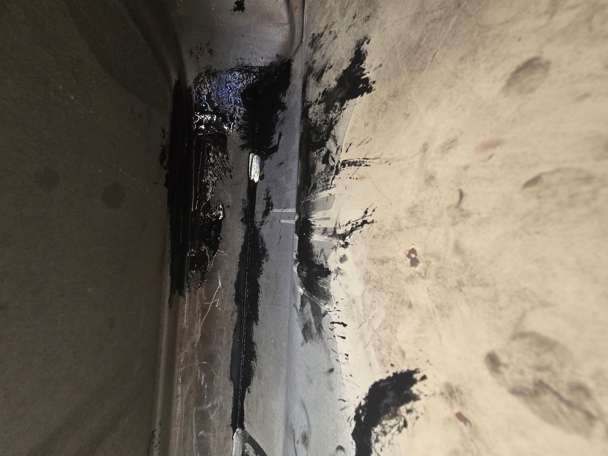

I patched a hole in the cowl collection container.
Coated the weld with P-15 and later coated it with seam sealer.
Part of the handle was rusty so I cleaned it and coated that area with P-15. I'll lube the handle up real well before installation.
This is the rust I cut out on d's side.
Piece I replaced the rusty piece with.

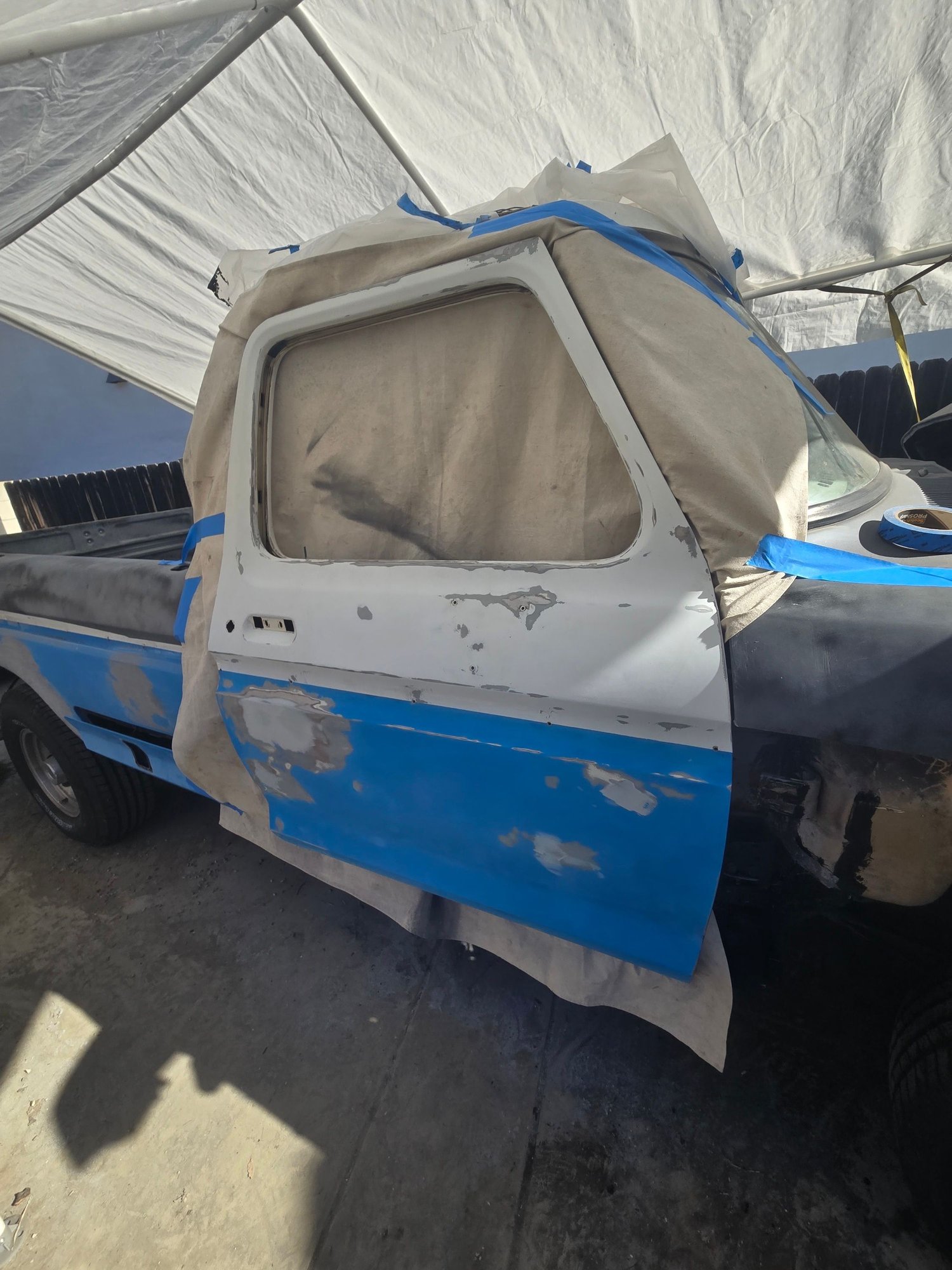

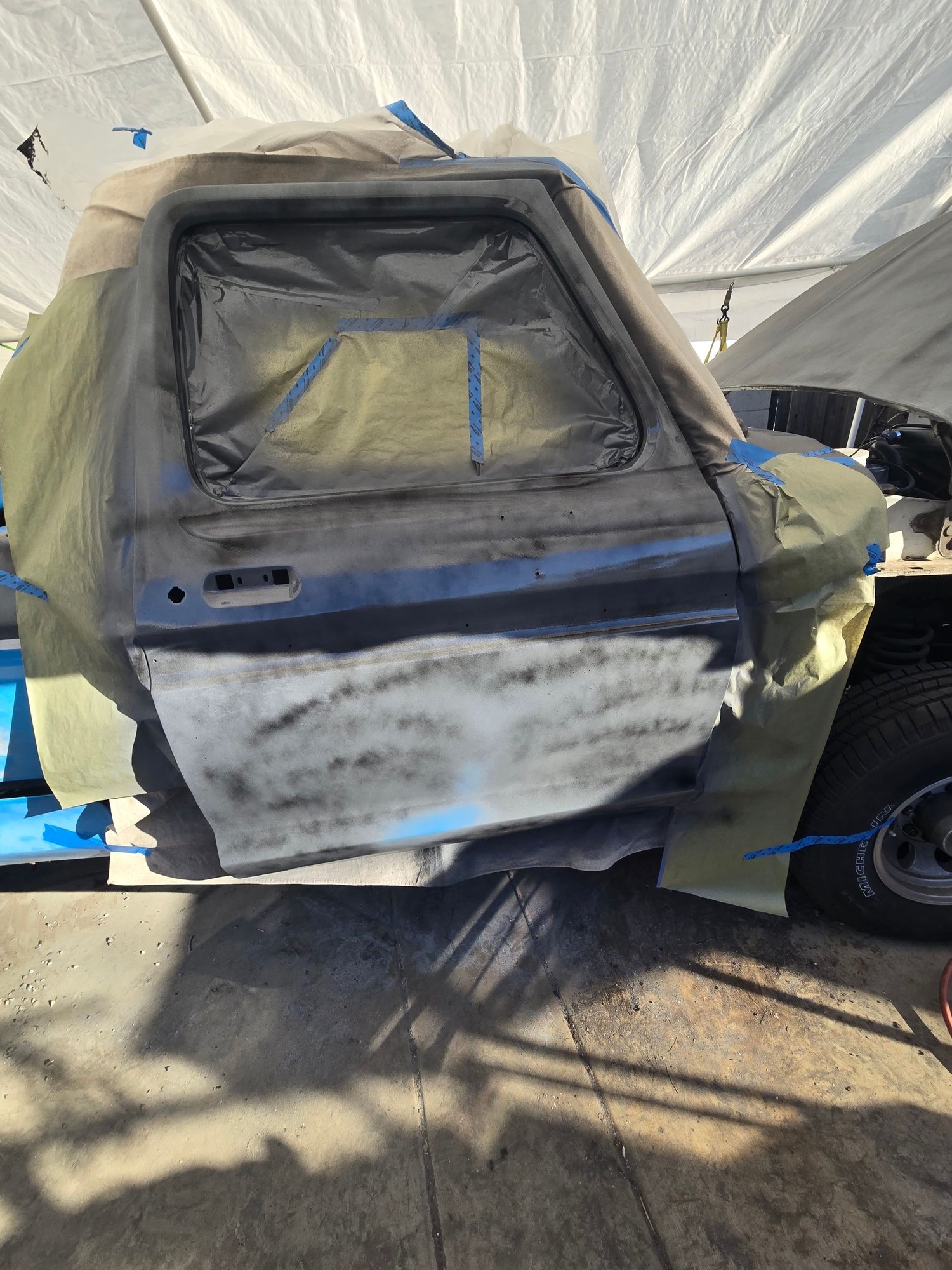

Worked on passenger side door.
Important: All of the welds that I have done got a coat of Por-15 on both sides. That is very important to stop or slow rust. I also wanted to pass along a tip: When you have your door panels off, take a flate blade screwdriver and inside the door scrape the blade along the bottom seam of the door, then take a v. cleaner nozzle and vacuum out all the sediment that has collected down there. Once I did that I also coated the seam with P-15.
That epoxy primer is stinky stuff!!
I also did the body work on the outside of the door, feathered the paint and sprayed epoxy primer over the most of the door.
