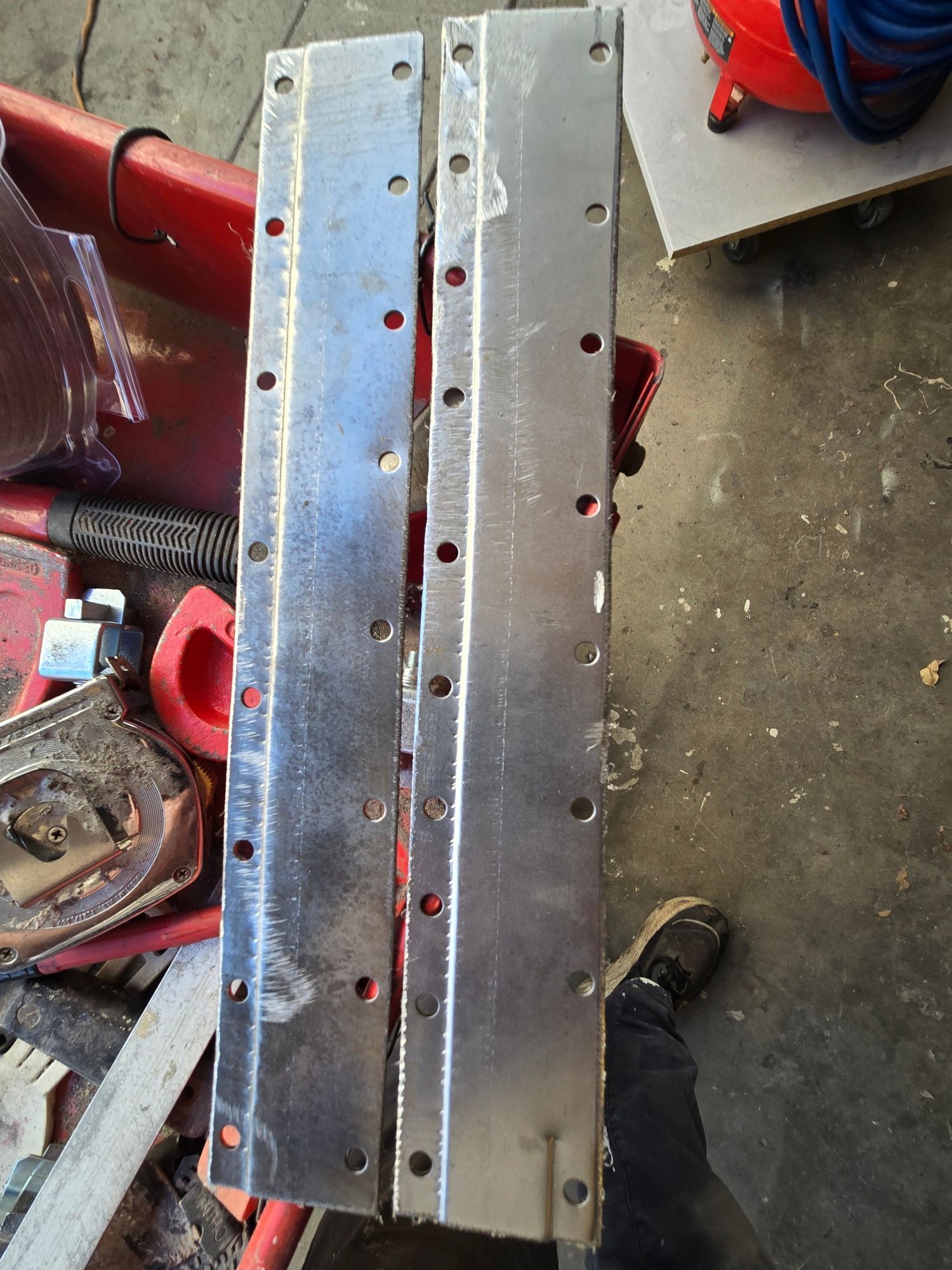

Well I finished the last of the metal fabrication work. Now I just need to go back and finish welding it up and grinding on the inside. Once that is done I'll go over the entire thing with P15 and then seam sealer. It doesn't have to be perfect since it will all be covered with Killmat. The outside is a diff matter. That has to be gotten ready for paint.
I cut these strips for the vertical patch on the rear wall.
Frankenstein patch. Once the body work is done, you won't know it's there.

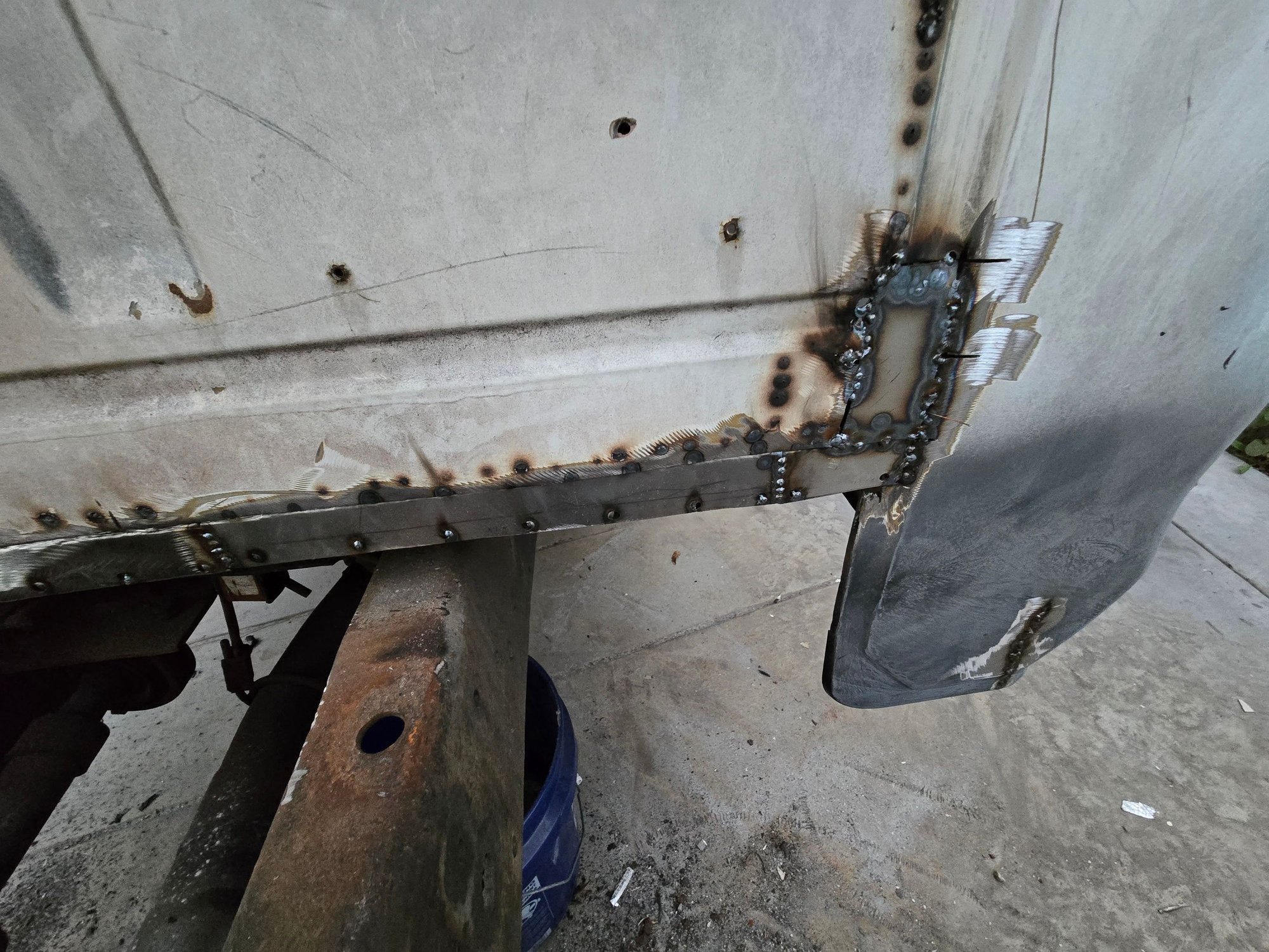

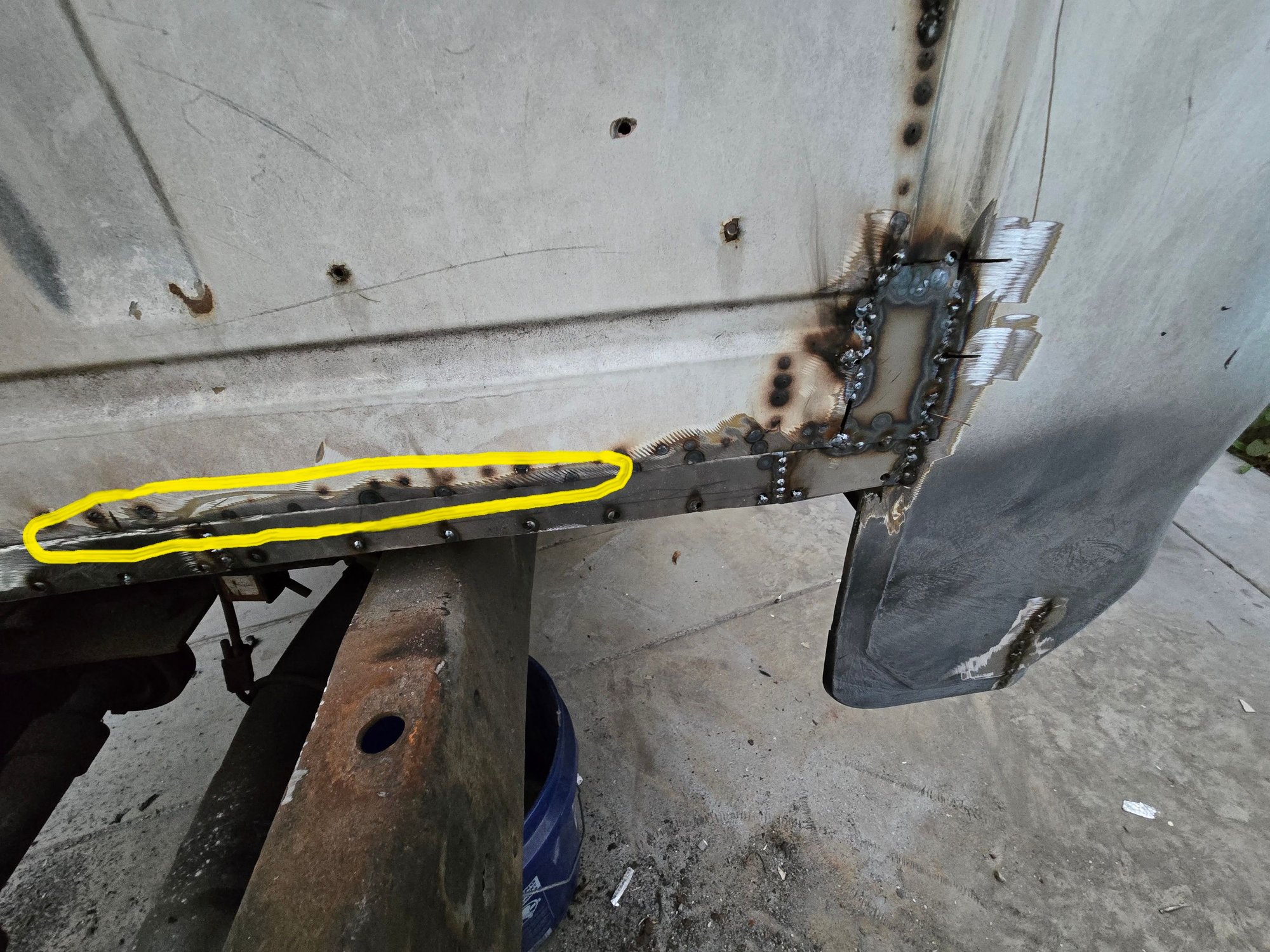

Does this seam need to be welded all the way across?
In the last post (#91), in the first photo you see the patch panels I made for where the back cab wall meets the floor. I made a lap joint for those panels and spot welded it on the inside and bottom. Do I need to weld it solidly all the way across the back wall?

Mine was spot welded every few inches where the back wall meets the floor, just above where it has the short return (90) that goes under the cab. I only plan on drilling holes and plug welding where the back meets the floor.
The long horizontal cut I made a few inches above the floor will be welded back up continuously all along the back wall.

Thanks, HertzHound. Today I welded. Man, I gotta say I'm becoming a whizz with my mig welder. Practice makes ... adequate, lol.
I coated the bare metal with P15. After it dries I'll coat with seam sealer, and lastly it'll all be covered with Kilmat.

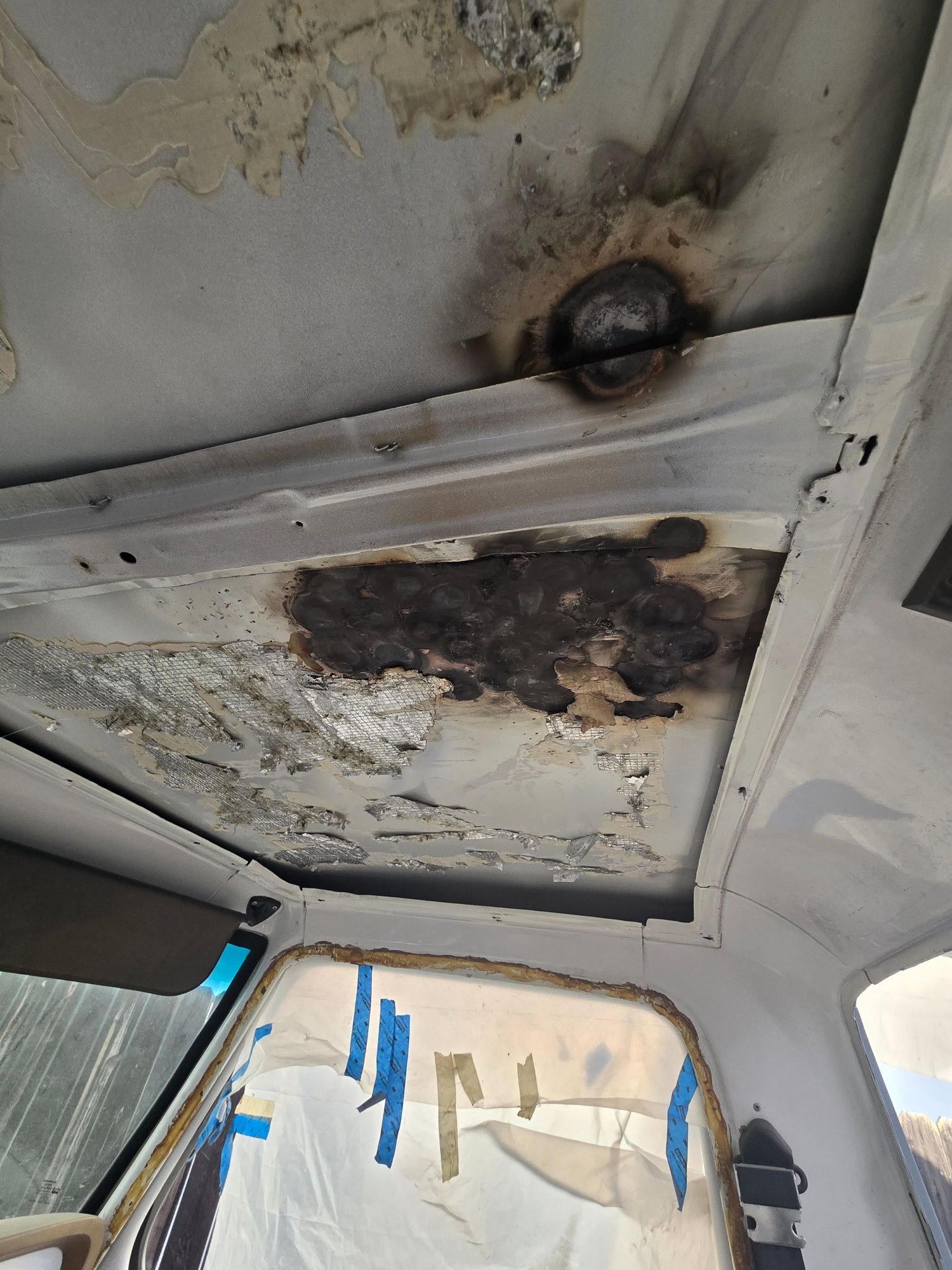

Random thought: At the beginning of this project a forum member said to leave the sound deadening until last because if you're having to kneel and sit on it, you get that black tar like material everywhere. Did I listen? Of course not.
I need to sand this and coat with P15 before covering with Kilmat.
