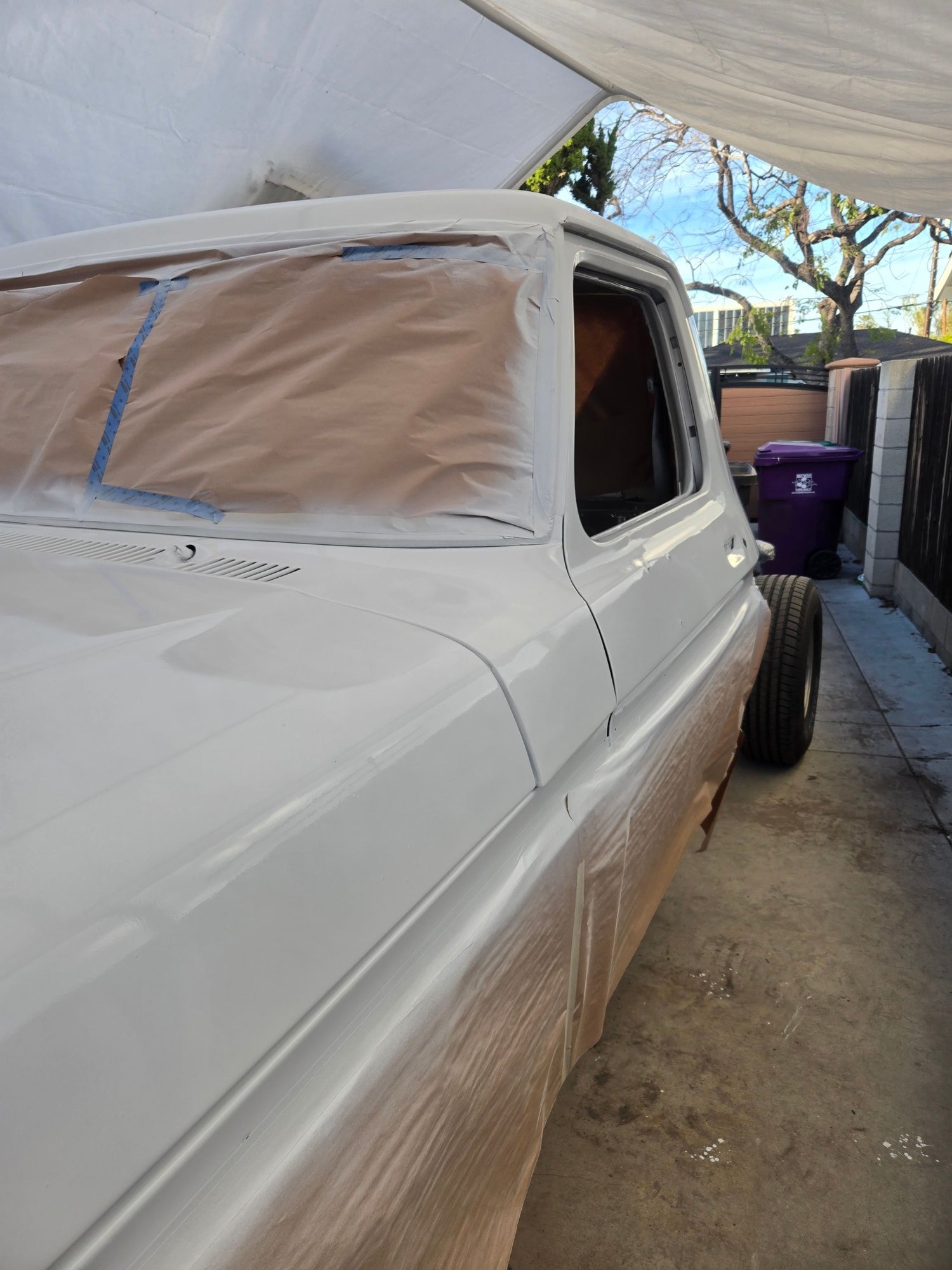

Well, the day has come to spray. Today I'll spray white on the top section of the truck, from the middle of the groove up. Then I'll clean the gun and shift to clear, and go back and give the top section another coat, but this time with clear. My only concern is reaching the center of the roof with the gun. I am applying a bit of silicone under the corners of the windshield rubber before spraying. I will also be spraying some small areas inside the door jambs.
This time, when I spray the cowling, I'll turn the air pressure down a bit to avoid leaf particles flying out and creating a painter's nightmare.

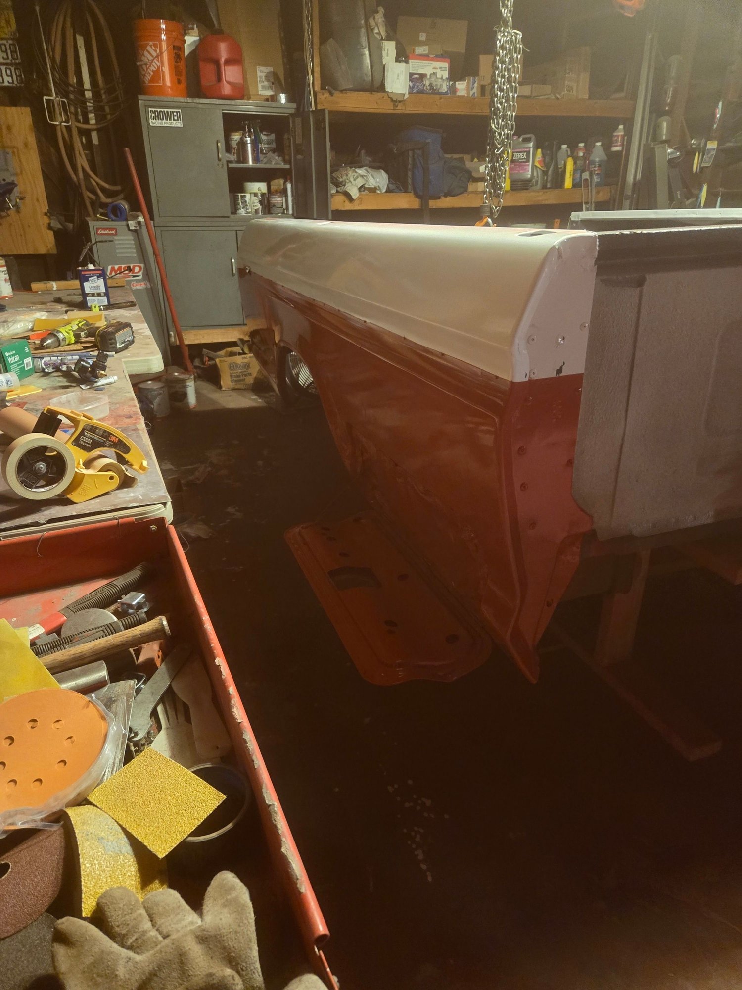

What a day. Today I sprayed some of the door jambs where I had done work. I also sprayed the top of the truck, from the dent (groove) up. I topped it off with two coats of gloss clear. I think it came out good, except for a couple of places where I dripped water. For the life of me I don't know how that happened. I have a water filter in the line. Darn it.
I wonder how long I need to wait before I place masking tape on the fresh paint????? Anyone?
The wife said with a sad look: "This used to be a work truck. Now it's just purdy."

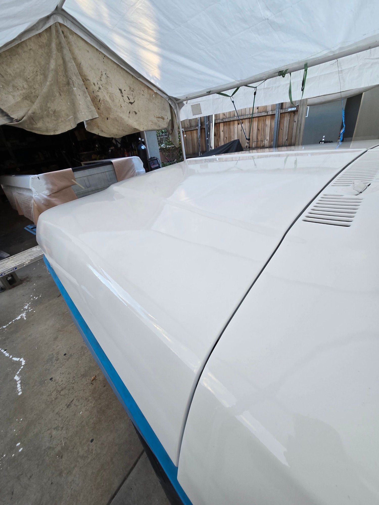

Hey guys. Thanks for the kind words. I have an inline water trap, but somehow I still dripped in a couple of places. Even so, I am happy with the job and happier still to be able to put it back together.
The lower part of the truck is going fire engine red. I should spray that today.
BTW, The Harbor Freight $16 gun is trash. I used and threw out two of them during this process, and never could get one to put out the correct amount of paint. Instead of a 50% overlap, as the manufacturer recommends, I had to double up each pass with the gun.
Today I will be spraying conventional syphon type gun.

try draining your compressor. despite having a water trap and 20ft of copper tubing w/ drain valves in the bottom sections in my compressor set up, I will still get moisture when blowing air. I finally installed a flex drain tube for the bottom of my compressor was suprised how much murky fluid I got out of it.
Keep up the great progress. I'm wrapping up on my interior paint as we speak and will move on to the outside once the weather warms up a bit in the midwest.

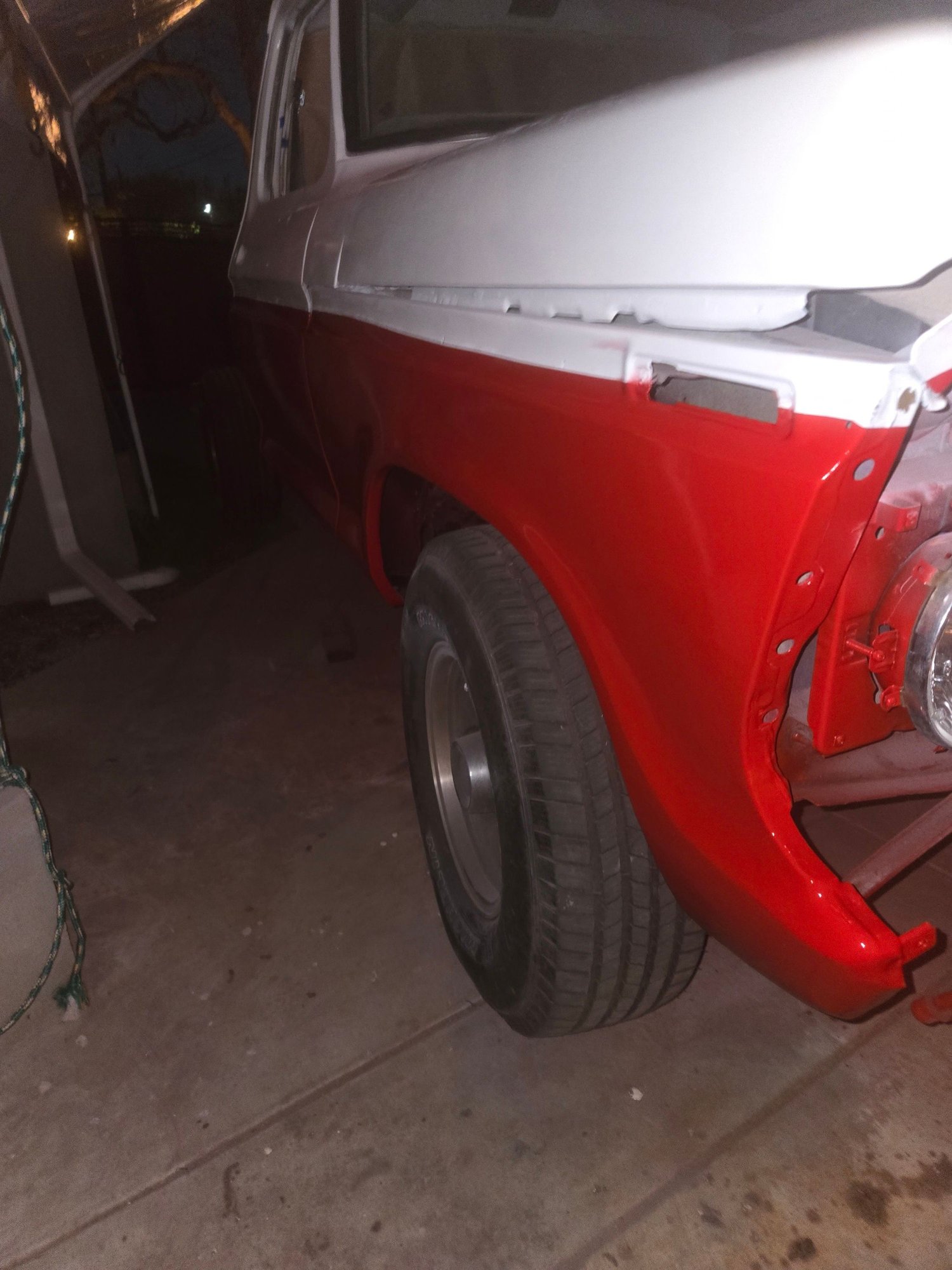

Well, I sprayed the lower part of the truck today. Two coats of color and 2 coats of gloss clear. It was another long day. I have some photos, but I ran out of daylight. I'm get some tomorrow so you can get a better view.
The truck has come a long way.
I was shocked by the color when first I opened the paint can.
It took a long time to apply 2 coats of color and 2 of clear.
Now comes the time when I park at the far end of the parking lots, ha ha. All I have left is the tailgate.

That white over red POPs! You look to have done s SUPER job with it.You won't just park in the far way spaces, you'll learn to allow time for all the guys and gals coming over to swap stories of old trucks. You'll see.
I've even had a group of 3 Washington & Lee coeds walk out to the far side of a parking lot to chat because two of them's dads out on the west coast (Seattle I think) mess with old trucks. Then they went the other way back from the way they came and went in the Walmart. It never fails, people have stories.

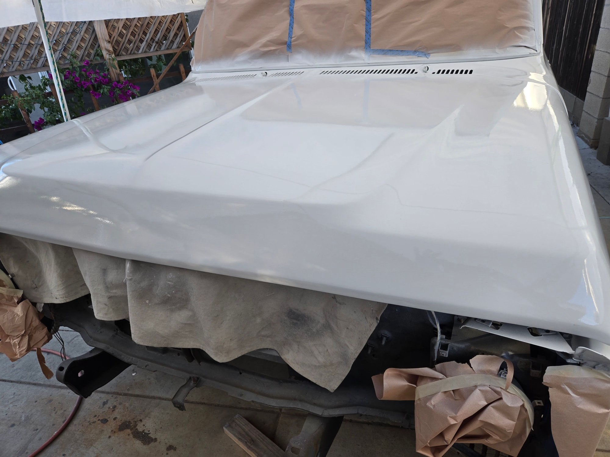

I got some over-spray on my hood. I was thinking to wait for the paint/clear to cure a couple of weeks, and then to buff it with some rubbing compound to remove the os, and then to give it some wax.
Is there a better way? Is my method not to correct one? Thanks for the replies.

Oh boy. In my last post I mentioned overspray. You can see it on the hood. I was able to buff it out with rubbing compound, but it took some serious buffing. I was very happy to see it without that pink tinge.
