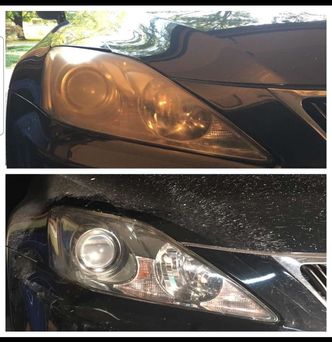

More than likely, due to the age of the truck, the headlight assemblies look like these, which when they age, block a lot of the light from the bulbs.
There are headlight restoration kits they sell which would help with those if this is the case.
Plus there is a recent thread on this from@scraprat on his Super Duty.

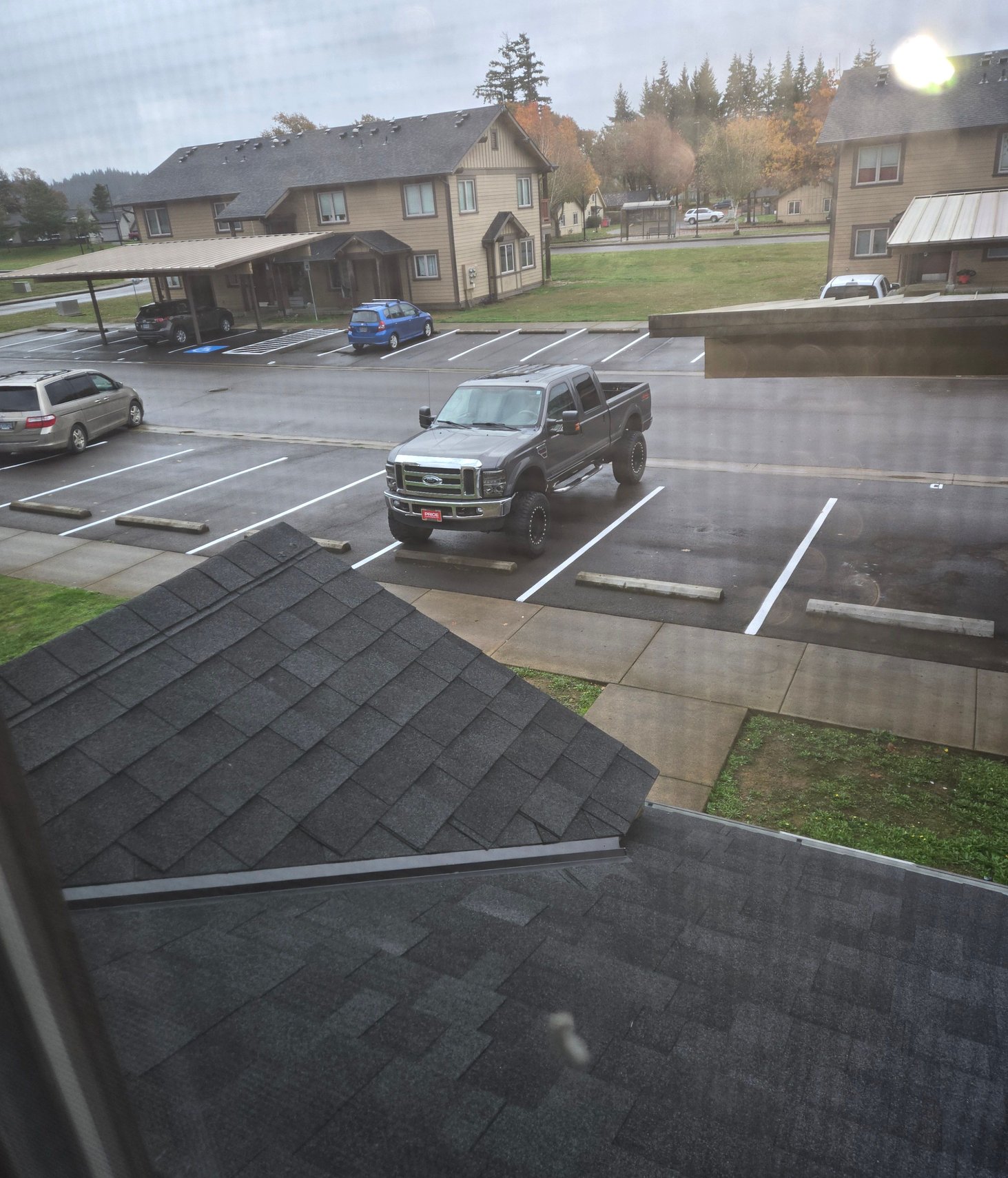

Dont mind me, but that dont look like a F250 front end. This is what a OEM 08 F250 headlight should look like. The pic you posted look like snake oil bling junk somebody changed out.

This is the truck, 08 F250 superduty super cab. So, the best thing for me to do is check ground wire first? Or should i buy bulbs and see if thats the issue first?
