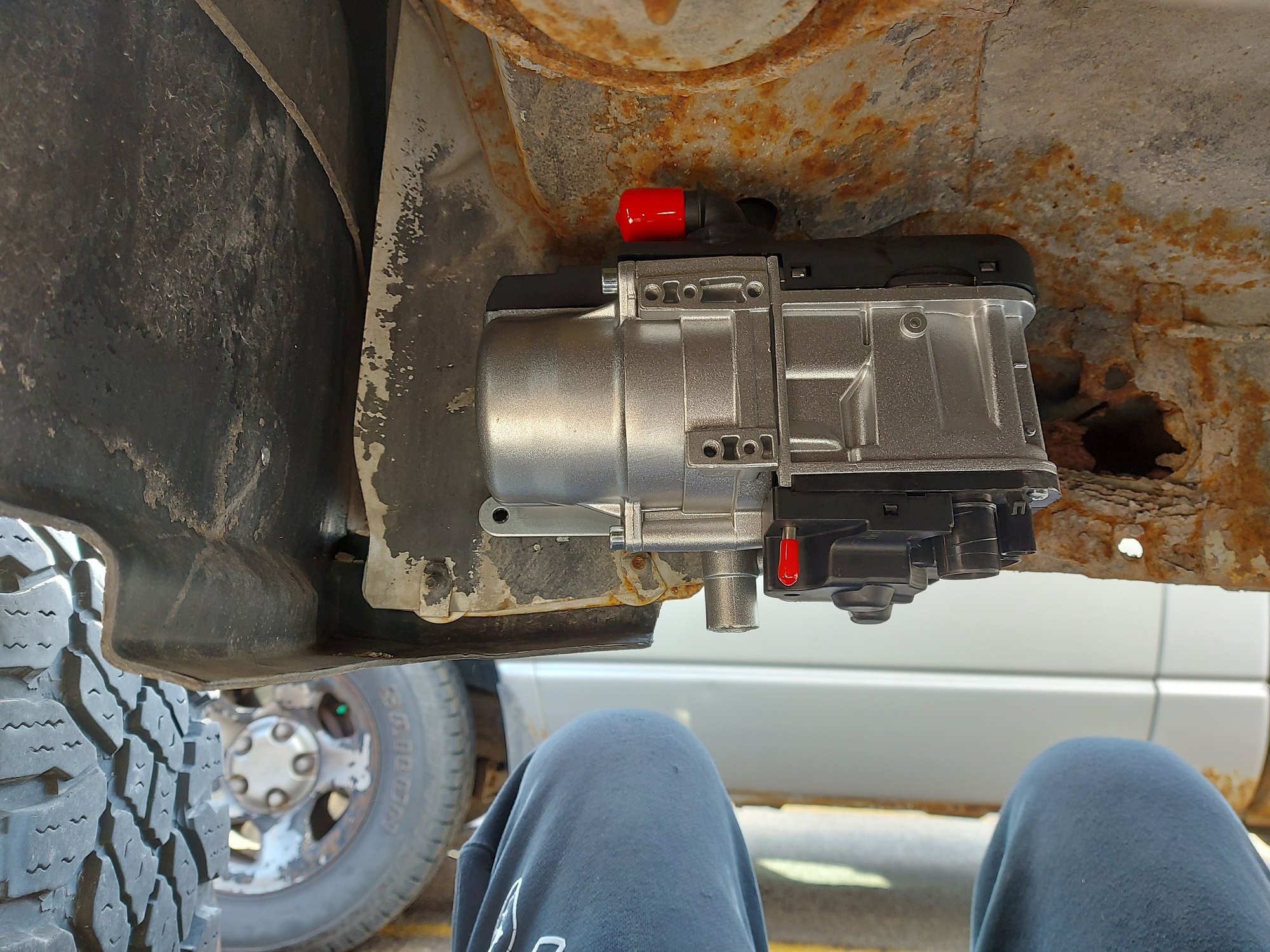

Old Nov 2, 2025 | 11:47 AM
  #35
wpg_250's Avatar
wpg_250
Joined: Feb 2023
Posts: 1,924
Likes: 817
Got it dry fitted where I want it and now to drain the coolant and route the hoses. Wind is blowing 40kph and gusting 60kph easy so keeping crud out of my eyes is the challenge of the day
Old Nov 2, 2025 | 12:05 PM
  #36
Hartwig's Avatar
Hartwig
Joined: Oct 2018
Posts: 2,811
Likes: 1,909
From: unfortunately Germany
If you want, you can install a "splash guard" so that dirt isn't thrown against the heater.

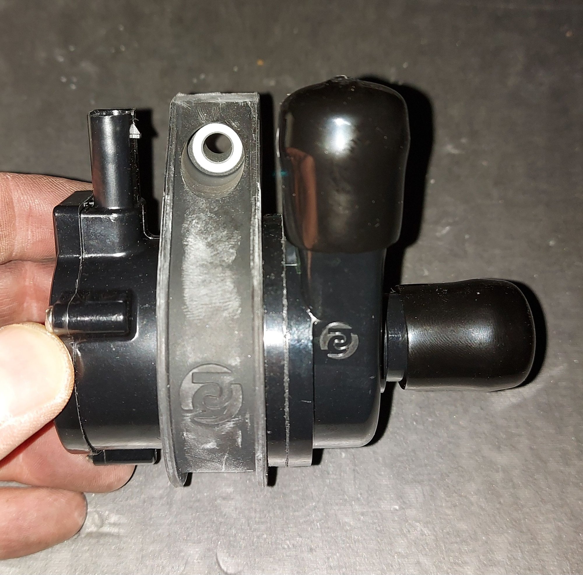

Joined: Feb 2023
Posts: 1,924
Likes: 817
@Hartwig
Any idea which way the flow would go on this pump?
I'm thinking the barb facing up is the outlet and the other barb is the intake. Pumps turn clockwise so that's my guess.

Old Nov 2, 2025 | 01:41 PM
  #40
Hartwig's Avatar
Hartwig
Joined: Oct 2018
Posts: 2,811
Likes: 1,909
Originally Posted by wpg_250
@Hartwig
Correct, do you have install instruction?

Old Nov 2, 2025 | 02:00 PM
  #42
wpg_250's Avatar
wpg_250
Joined: Feb 2023
Posts: 1,924
Likes: 817
Nothing that helps lol.

Old Nov 2, 2025 | 02:22 PM
  #44
Hartwig's Avatar
Hartwig
Joined: Oct 2018
Posts: 2,811
Likes: 1,909
In the link in post#33 are useful informations
Note: install the fuel supply pump as shown. Or fuel supply issues can occur
Old Nov 2, 2025 | 04:30 PM
  #45
wpg_250's Avatar
wpg_250
Joined: Feb 2023
Posts: 1,924
Likes: 817
Got it installed for the most part. Just have to run the fuel line, put the intake and exhaust on, wire loom everything, build a shield to cover the heater/pump and wrap the hoses in fireproof insulation. Next weekend lol.
After I got the plumbing done I got the truck up to operating temp and no leaks found, also I was able to turn the pump on and I could hear the coolant flowing through the heater core so I'm assuming the truck needs to run a good bit to get any air out of the system yeah? That or the engine is so loud I'm not able to hear anything else when it's running.
Have a good evening fellas 🙂
