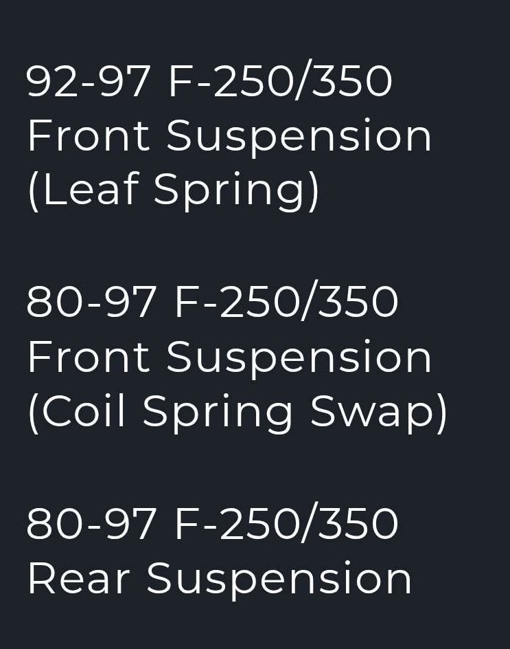

When I had my 96 F250, which I plowed commercially with (that truck got worked), I used to research online all the time. I came across Sky Offroad Designs. I believe they also make brackets to use the newer and longer Super Duty front springs as well, but here is their rear spring Super Duty spring kit for OBS trucks.
https://www.skysoffroaddesign.com/pr...ar-spring-swap
From their website:
The OBS Solutions link above uses Sky parts. This should be enough to give you a start to research on your own... BTW, still love the OBS trucks and their looks.
