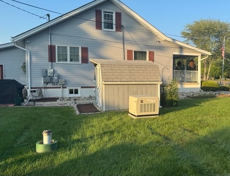

Speaking of which, I "installed" i.e. put in place, a 20Kw standby at our second home. (Natural) gas was installed at N/C, and I received a quote of $11,500 to hook up the gas and electric (I have the transfer switch). Is that in the realm of reality? I was shocked. It will be a pretty straight-forward install - the only thing is that there is a concrete sidewalk between the generator and the gas main/house/electric panel.

If you have ever run a business, you will understand that is a lot of overhead. I can only imagine how much liability insurance is. Medical Insurance for your employees. L&I insurance for the employees, etc. It's not cheap to run a business. What you think might take a few minutes/hours to hook up is not the issue. Someone has to pay to keep the doors open. People seem to forget, all expenses that a business runs into is passed down to the end user.
$11,500 does not seem to be extreme to me, but then I have a small business and understand what it takes to keep the doors open.
Not certain what the rules are, why don't you install the stuff. All it has to do is pass the codes [assuming that there is no requirement that a licensed person has to do the install]. The codes are written.
Maybe that should have been looked at before you put it in place.
I think if you take a close look at the quote there is a lot of added work cleaning up all that stuff mounted on the side of your house. This is coming from a retired self employed electrician.
Let's not let this thread get to far off charging lithium batteries.
Denny

I have owned the same business for 37 years. I pay over $250k* per year in insurance, $75k in electricity, another $100k in our part of FICA and 401(k) . I understand overhead.
I am comparing what it cost to set up the same generator at our main house. Including gas installation (which was free at this new house, paid at the last one), it was under $5k. Granted, it was 7 years ago, but I wouldn't think things had tripled/quadrupled since then.
